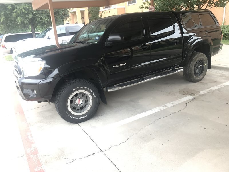

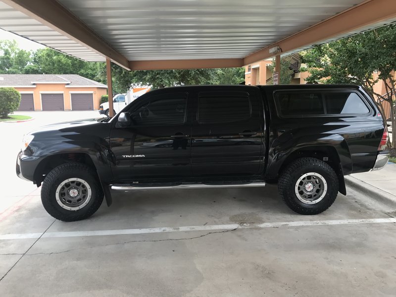

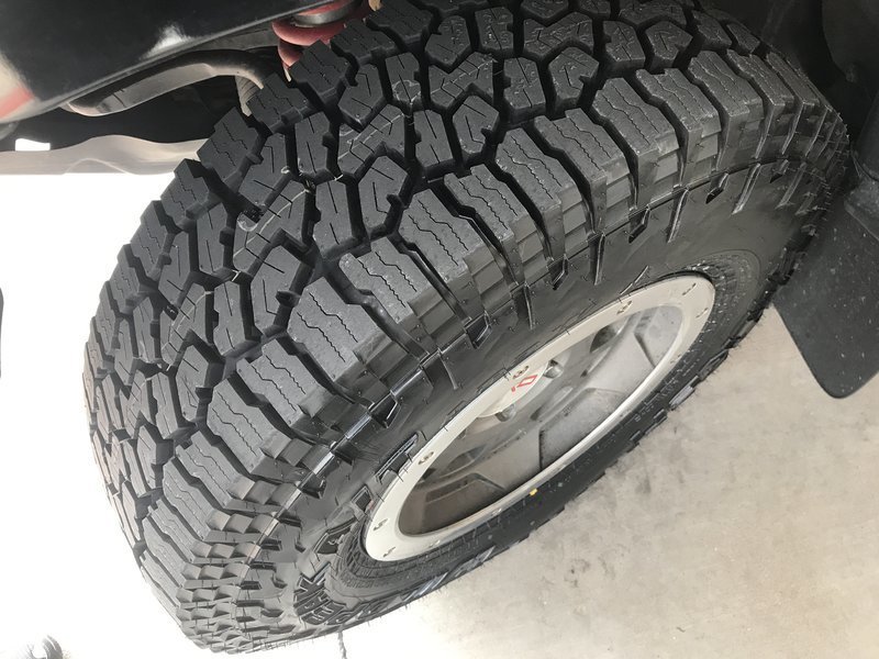

    Thanks. I'm by no means a smart man. But that's what it looked like the issue was

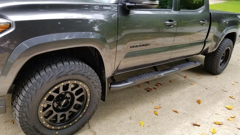

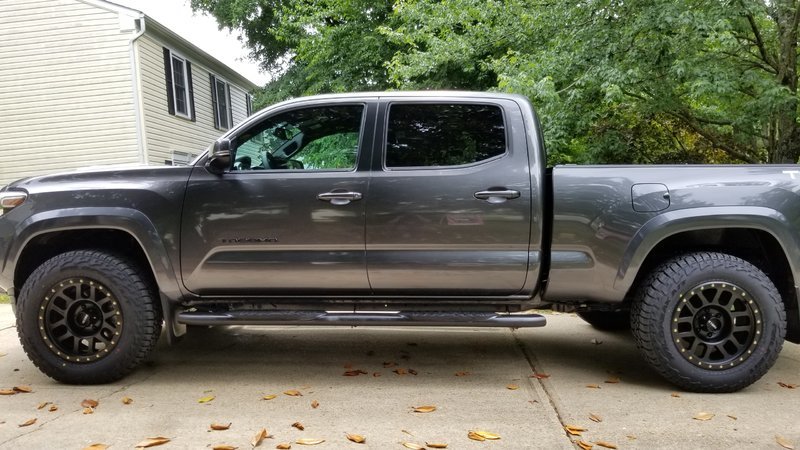

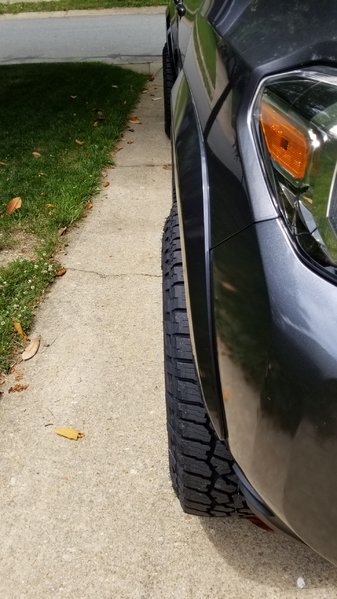

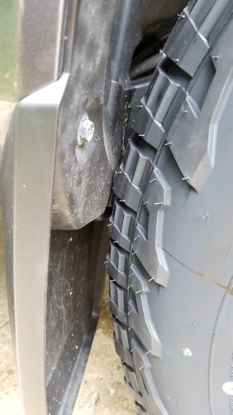

    Got the new wheels and tires put on today. Method Grid 18x9 with -12 offset and 265/65R18 Falken Wildpeak ATW tires. There's a slight rub on half turn but it's on stock suspension right now. Once I get the Bilsteins, OME 887s, and Headstrong leafsprings on it should be fine.

    Lifting won't help fit tires. Just trim it, it'll still rub when lifted when the suspension cycles.
    Or get LR UCAS and play with the caster adjustment. Either way you'll likely still rub due to rim offset so at the end of the day you'll just have to :sawzall:

    Is it rubbing on the mud flap?
