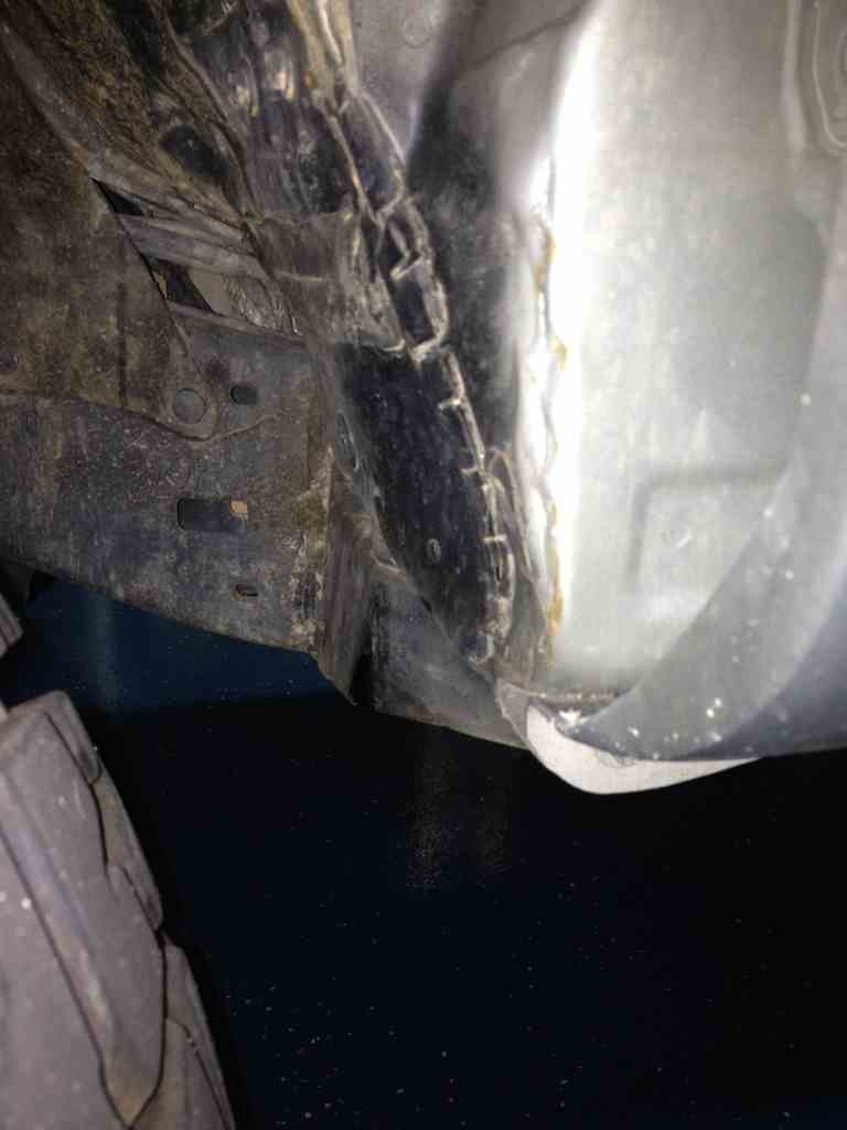

    i was thinking about it. my skid plate definitely doesn't like how low it is haha

    ill upload a couple. even with the pinch weld smashed and cab mount chopped, i still rub both haha..

    is your pinch weld shaved off???

    yes :anonymous:

    this is probably a better way to do it haha. notch it, then start swinging.

    At that point why not consider tubbing em?

    i have the top half smashed to oblivion without the notches but the bottom half is just to thick so i guess ill have to do that haha. so the 35 are worth it?

    they're badass. but i hate the sound of my tire smashing into the inner fender well haha.. tires are getting chewed up out there..

    it looks likes it hitting your actuall body?? or is that just me?

    Mine is chopped all the way back and I cleared 35s with fiberglass and 2.5" of preload, all before the spindles. I also beat the shit out of my inner fender well and flattened the pinch weld. But when it stuffs it used to rub a little at full stuff. It's not a huge deal but I can see some scuff marks

    yes, i definitely am.
