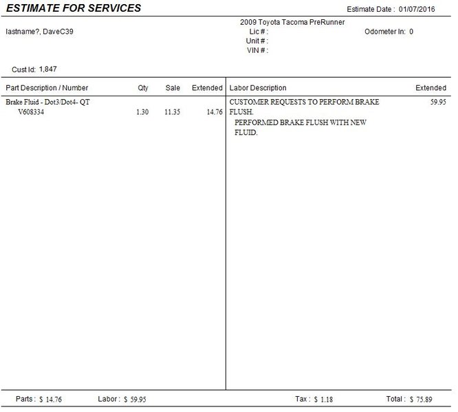

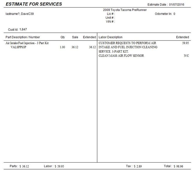

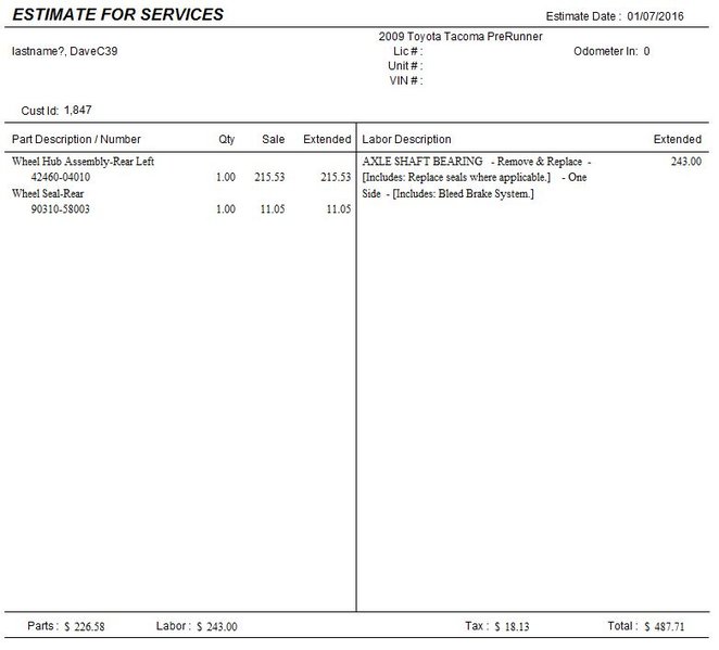

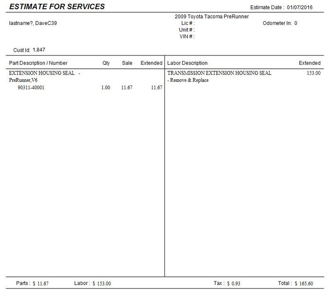

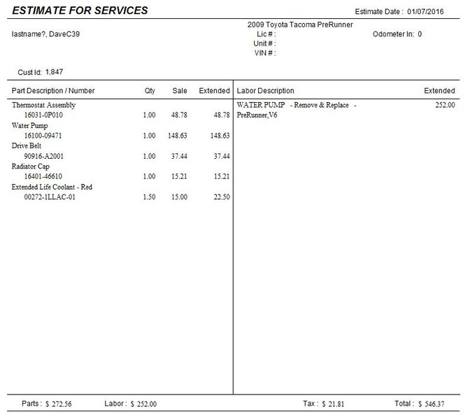

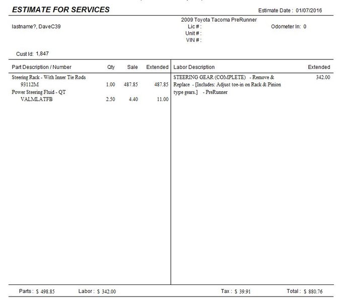

    Threw together a couple quotes for you. My shop is located in So. Cal and pricing will vary dependent on where you are.
    Don't let the dealer scare you, or take your money. Plenty of small shops that'd be more then happy to do the work and save you money. For the equivalent of a few new truck payments, you can have all these things done. Break it down and prioritize. Wheel bearing and water pump should be done first.
    Bad Left Rear Wheel Bearing
    Bad Water Pump
    Bad Drive Belt
    Bad Steering Rack
    Needs Power Steering Flush *** Will be replaced with rack and pinion ***
    Needs Alignment *** Will be done after rack and pinion replacement ***
    Bad Trans Tail Shaft Seal
    Needs Break Fluid Flush
    Mass Air Flow Sensor Service *** Will be cleaned with a fuel induction cleaning ***
    Fuel Induction Service

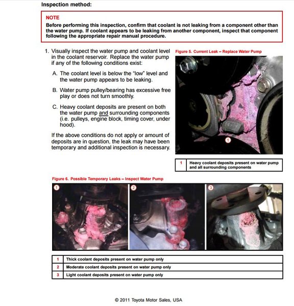

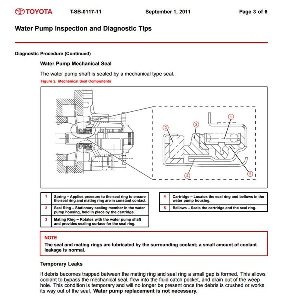

    Also, don't be afraid to get a second opinion. The dealer is known for pushing sales that might not necessarily have to be done right away, or at all.
    Example being a small seep from the rack and pinion is NOT crucial. Or maybe the water pump may has signs of deposits and that's why they're recommending replacement, when Toyota states that a little leakage is normal.

    Get a Maval rack and pinion, they supply dealerships with re-manufactured units. Awesome quality.
    Part #93112M

    As long as flushing the fluid isn't already included in the labor book rate for replacing the rack; which most of us reading the thread figured it would be.
