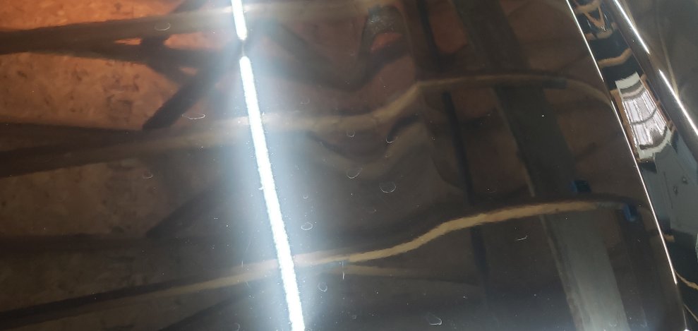

    I have a 2017 Tacoma....Black. I have had it for just over 2 years. Half of that time it was garage kept. I took it to a paintless dent repair for a small dent on the hood. The shop said that they were surprised with the amount of water spots on the hood and that it appears the paint could be damaged and they can fix it for me. I have washed and done the spray on wax to no avail. Is the shop trying to make an extra dollar on me?

  6. Dec 12, 2019 at 11:11 AM
    JBone25
    JBone25 [OP] Well-Known Member
    Feb 1, 2018
    #243187
    324
    These droplets over the hood, but not really any other portion of the vehicle. Pardon the overhead reflection.
  7. Dec 12, 2019 at 11:14 AM
    fiftyxp
    fiftyxp Well-Known Member
    Jan 14, 2019
    #279284
    2,681
    2017 trd offroad 4x4
    looks like waxed hard water to me

  8. Dec 12, 2019 at 11:14 AM
    JaTe
    JaTe Well-Known Member
    Mar 1, 2015
    #149874
    514
    Maryland
    2017 Tacoma TRD OR DCSB
    some polish and elbow grease should remove that.

  10. Dec 12, 2019 at 11:16 AM
    Minimag95
    Minimag95 Well-Known Member
    Nov 8, 2017
    #235456
    1,655
    Niles
    Annapolis, MD
    2009 Pyrite Mica V6 SR5 4x4
    OME's w/ 887 Coils, SPC UCA's, 285 ST Maxx. Mobtown sliders & skid
    Those just look like water spots from hard water. I'd tell the shop you're not interested.

  12. Dec 12, 2019 at 2:17 PM
    daks
    daks Juzt for Shitz
    Jan 12, 2018
    #241060
    1,897
    Hammertown,Canada
    2017-TRD-Sport DCSB
    Ongoing
    17 was 202 Onyx Black, beautiful when clean and polished. PITA to keep that way.
    Wash and dry the truck, steal some vinegar from the kitchen and some gloves (so you don't smell like a pickle when done) and soak a clean microfiber cloth.
    (202 black shows everything so own some microfiber cloths )
    Wipe down the hood, or even mist the vinegar with a spray bottle. Wipe off with a clean microfiber towel after 5-10 minutes.
    Wash the area and dry.
    If the mineral stains have been on the hood for a long time and "baked in" then even after soaking in vinegar you may still notice "etching".
    Diluted wheel acid solutions will work better than vinegar but once it's etched... it's in there for good.
    Clay bar may help a little bit but will not remove them all at this point.
    Next step is if you want to remove it by hand look into something like Meguires ScratchX.
    OR much much better is to look into getting a cheap harbour freight/porter cable, Random DA polisher and some pads.
    You'll spend on a cheap Random DA polisher and pads less than what they were going to charge you to fix your hood.
    Spend some time in the detailing section or youtube to see how easy it is to make your whole truck look better than new in a weekend.
    Then get into a regimen of waxing with a quality wax,
    or better yet a sealer,
    or even better a ceramic coating (ceramic coating can be done after you polish and will cost you less than $150.00 for a basic coating).
    But don't let hard water (tap) or bird crap sit on your paint.
    I did the whole DA compound, then polish, then CQuartz 3.0, then Gliss coating on my truck.
    A weekends work on a new truck.
    Very easy to keep clean and looks better than new and it's over 2 years old.
    Black is a bitch but it's beautiful...

  17. Dec 13, 2019 at 12:46 PM
    #17
    Sungod
    Sungod Well-Known Member
    Feb 12, 2018
    #244194
    2,571
    St Augustine
    Looks more like calcium from hard water. Acid rain has an etching effect. Ironically what dissolves calcium is acid. as mentioned, vinegar and water should clear it up. You can use Windex, but you need to use the vinegar Windex and not the regular ammonia Windex. Ammonia is a base and will do nothing to calcium.
