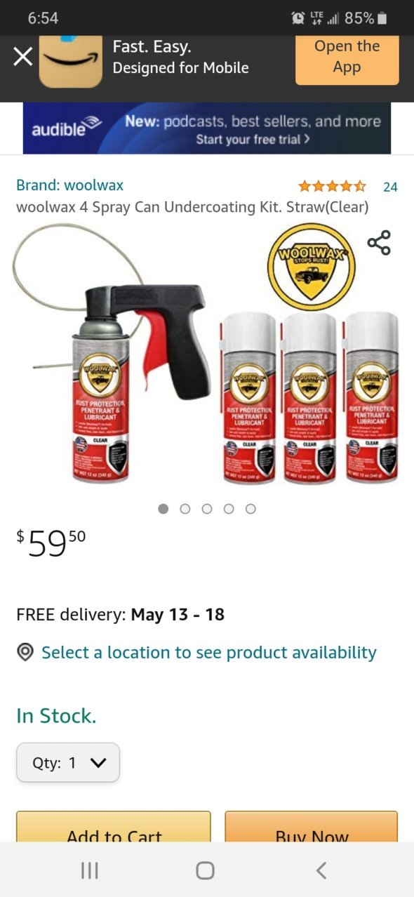

  3. May 9, 2021 at 5:56 PM
    Evostaco
    Evostaco [OP] Jack of some of the trades, master of maybe 2
    Feb 19, 2021
    #356677
    2,129
    Nebraska
    2021 tacoma offroad, mt, superwhite
    Screenshot_20210509-185450_DuckDuckGo.jpg I'm thinking that I'll order this up and use it. I only hand wash my truck so it should last a long time
