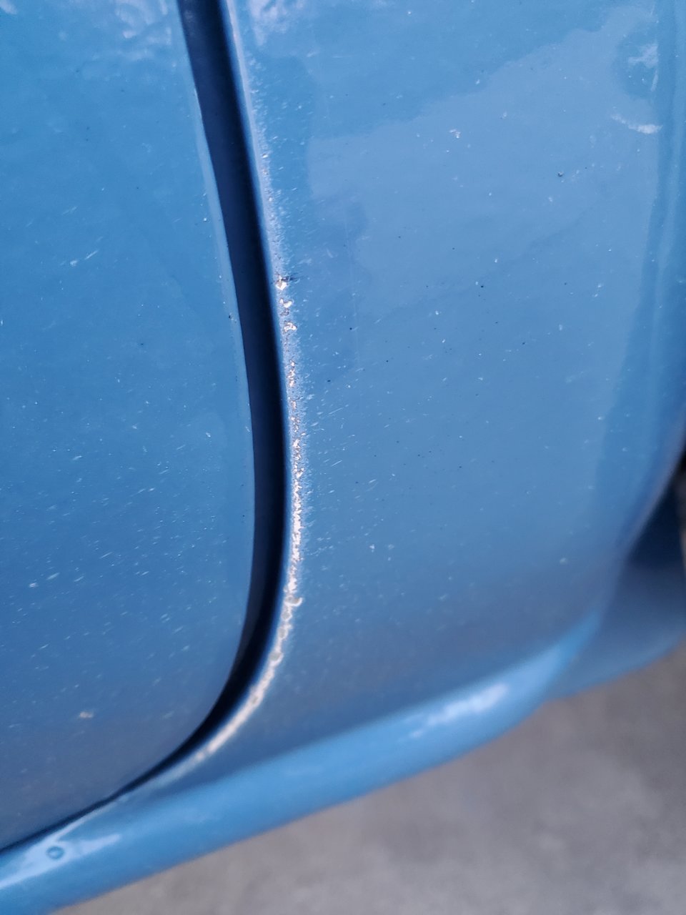

    Im having an weird issue with my tacoma. For the first 30,000 miles the paint held up well with only a couple paint chips. After installing a set of Wildpeak ATs I noticed a weird chipping pattern. This happened just over the last 4000-5000 miles through the winter. I had the truck through last winter as well but didnt experience this with the previous tires.
    Drivers side. Pattern perfectly follows the edge of the door jamb.

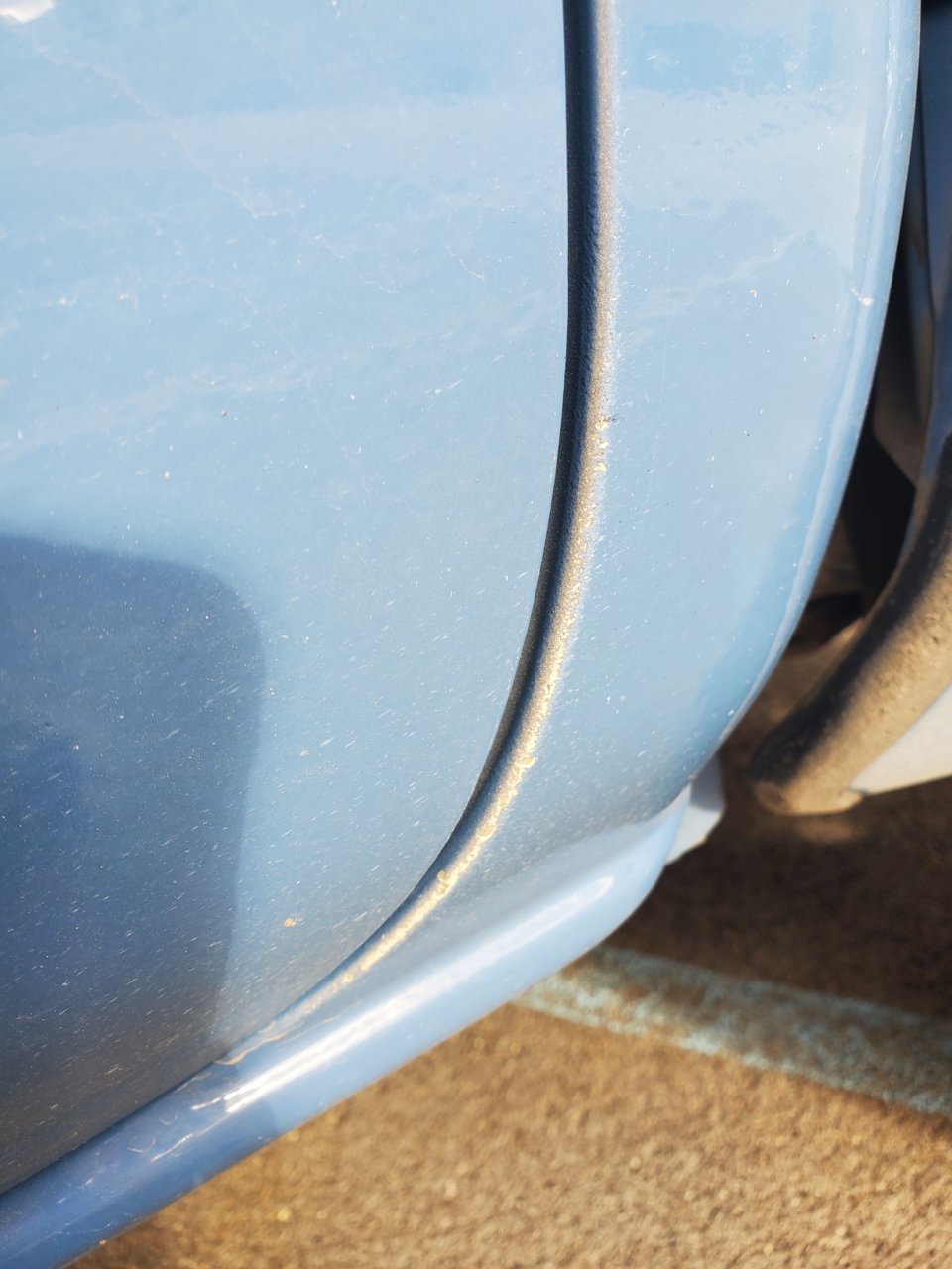

    On the passenger side there is nothing in that area. But it has a similar pattern on the front edge of the rear door. Only thing I know to do is to touch it up.

    Wow ... that's a lot of chipping like it's been sandblasted! Are you driving on gravel all the time? Almost makes me also wonder if the paint is just super thin right along the edge of that door?

    Im thinking the door might be slightly misaligned. Im gonna try adjusting the door stryker.

    It looks like the your rear door and a q-panel take a lot of beating. Yes, misaligned door will allow q-panel edge catch a lot more rocks than it should be. Align your door, get some side steps and mudflaps. Mudflaps alone will not solve your problem, IMO.

    Makes me think it's for starter a paint issue. I would for one go by a well regarded auto body shop (or two) and ask them to look at it. It certainly needs to be repainted so that it doesn't get worse.
