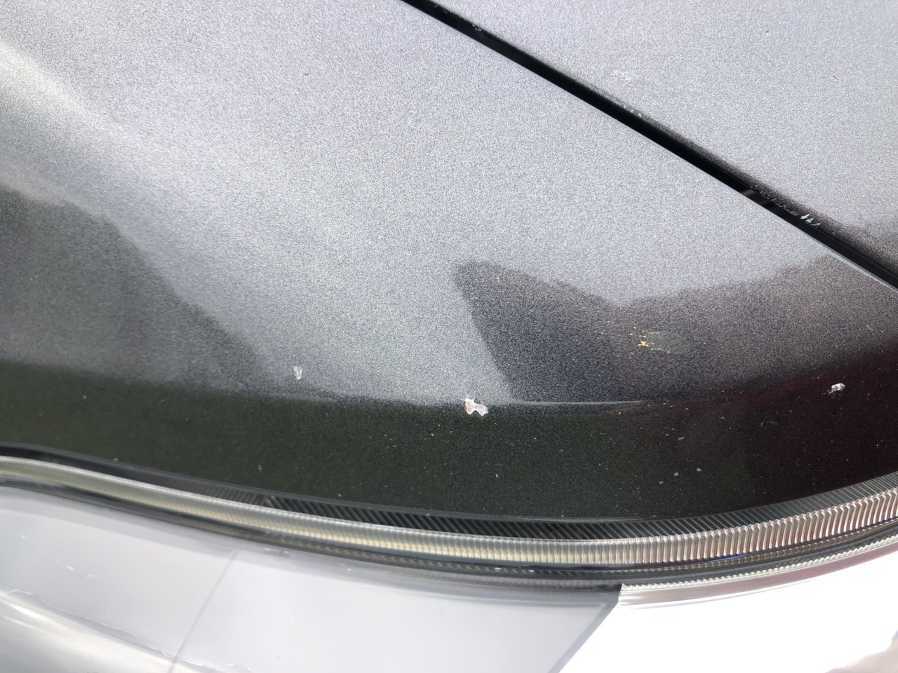

    Other than the truck not having Apple Car Play my only other gripe is the crap paint quality. I have never had this issue on a vehicle before. Is this something I can/should fix on my own? I am guessing if I leave it be the rust spots will just get worse.
    Advice?

    You can fix all of that with a touch-up paint pen: https://touchupdirect.com/touch-up-...DfJ2FikSh1NqSOOVosnJZykYNA_-PPIUaAu5zEALw_wcB

    Yeah, I think Toyota paint is crap compared to other manufacturers, seems "softer" and more susceptible to damage. I always diy fix small chips in the paint right away using a paint pen and clear coat. That looks like it might need a little light sanding first...

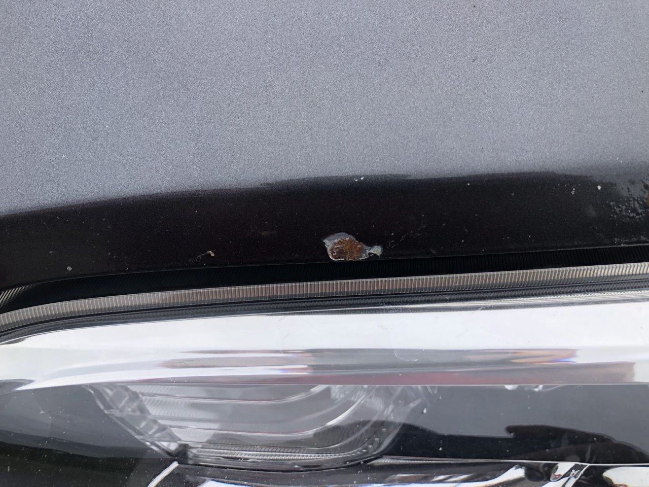

    Your paint repair will only last if you eliminate the rust.

    Swing past the local speakership and grab a touch up pen from them. Its color coded to match. They come with a abrasive tip. You use it ike a marker to rub the rust out of the surface. It will have paint on one side , and clear coat on the other. Perhaps after consider hood deflector.

    As far as the op, any rust must be sanded out to bare metal first before it can be primered, painted, and clear coated, or it will never last.
