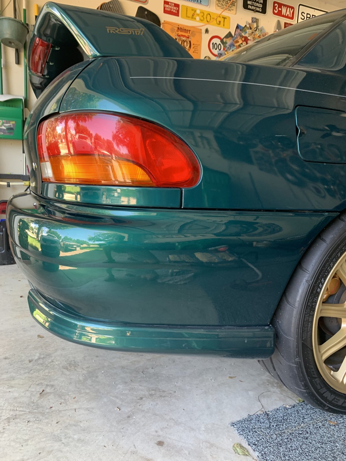

    100% sure 1998 (and older) OE paint codes(all manufacturers) are not “valid” anymore
    Maybe up to 2003
    no biggie
    Just need good painter to add color by weight and spray multiple swatches to fully match original color
    Just had to do the exact same
    Long Ahole police story but I backed into my friend’s $40k (motor only) 09 mustang leaving a car show
    Paid for both bumpers(5mph crash)
    His (thankfully) was black
    My 1998 Acadia Green turned out great and color code was not available with new EPA regulations/new paint/new paint mix computers/etc…..had to be custom matched
