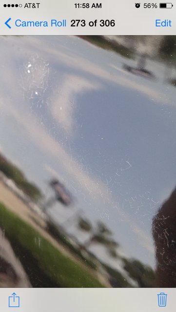

    i have a black 2015 tacoma DCSB 4x4 SR5 TSS Package and it has a paint defect on the drivers side of the bed. basically, it looks like they paint is kind of "spider webbed" and you can see the primer inside the small cracks.
    if you have a 2015 tacoma i would strongly suggest looking over your truck front to back, top to bottom.
    this defect is EXTREMELY hard to notice on my truck but once you see it once, you can spot it from a mile away

    well its brand new and it only had 9 miles on it when i bought it.
    im no paint expert by any means.
    when i was washing my truck the other day, i noticed it and brought it to a body shop that is locally owned by a good friend of mine. he took one good look at it and said "yep, thats a paint defect"

    If its the same condition as the OP its called paint checking or, anachronisticly, laquer checking. In the OPs case it's an application flaw due to some kind of chemical or recoat time fubar. Yours could be too, or it could be something else like eccedsive panel flex or heat. Regardless, due to being out of warranty it's probably just a tough break. AFIK the only fix is to sand the panel down and repaint it.

    i took the picture with my phone and sent it to my email its not the best quality but you can see the defect decent enough to make out what it is
