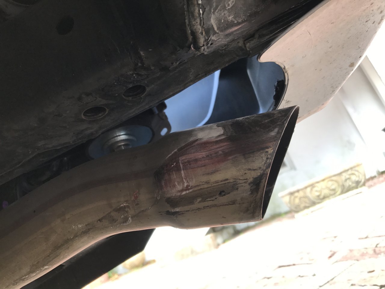

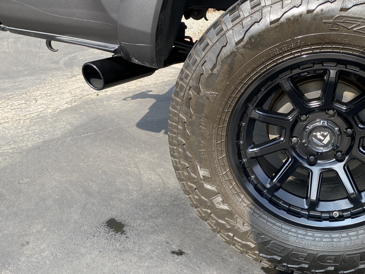

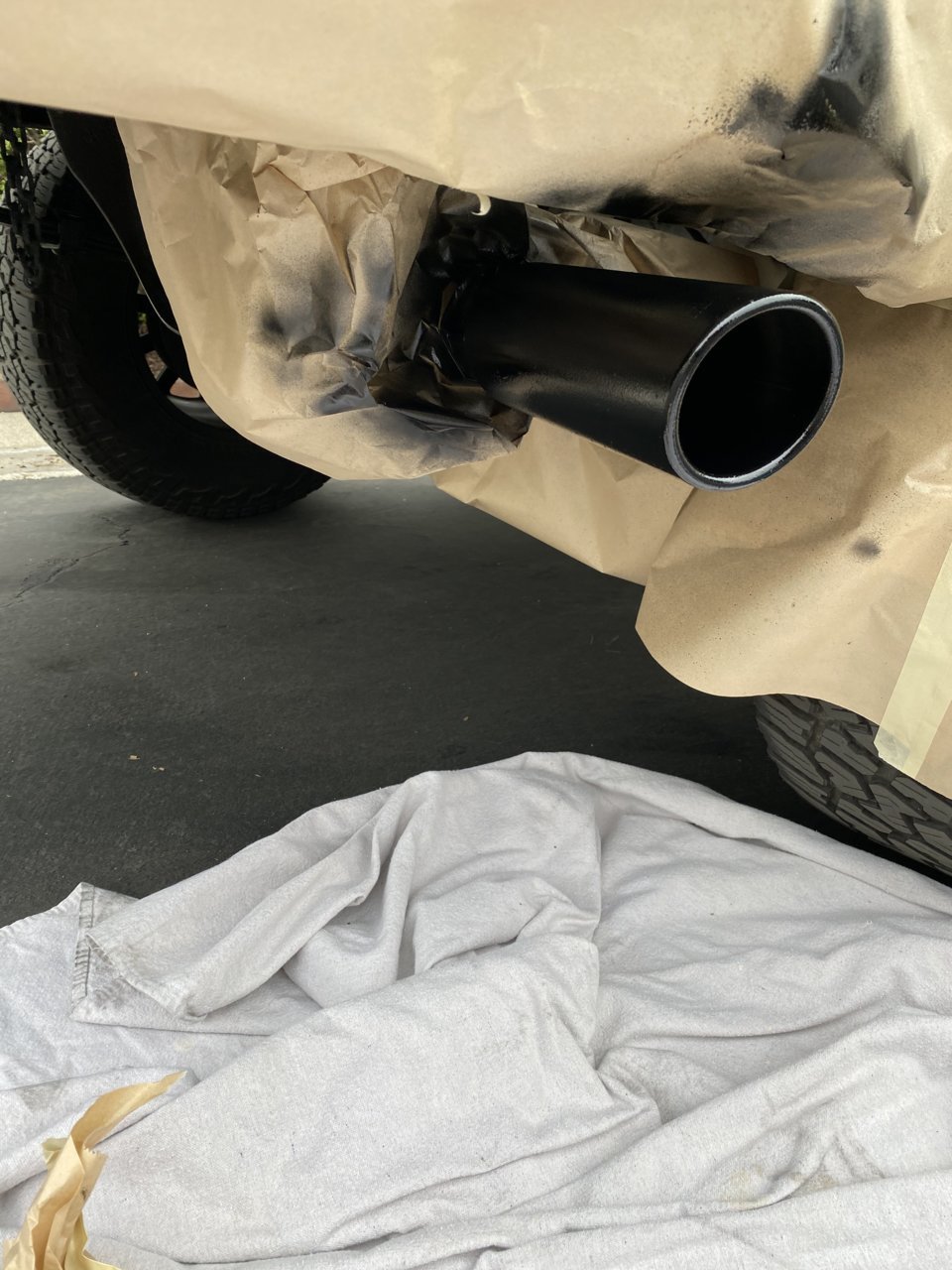

    BDD4026E-41E7-4A8F-AB3C-C5B2A96BA829.jpg 64451A84-AFE3-4F92-ACE2-E2068B4FDEA8.jpg 17A0767F-C0C1-4BB9-8C44-9FABF64B794A.jpg DB1F990E-C40A-4386-A6D9-29183231F1C4.jpg

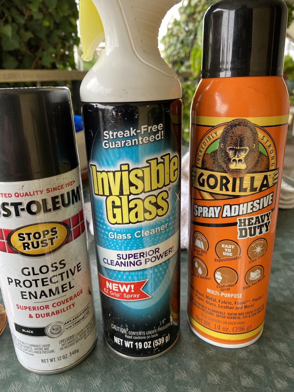

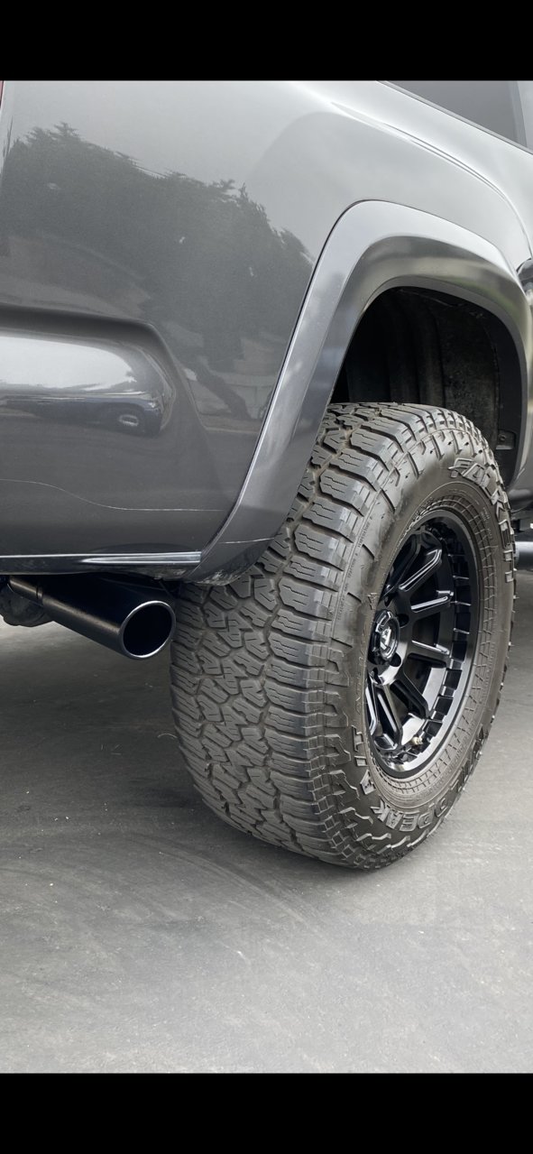

    Step 1: mask off area that you don’t want overspray on and clean off exhaust tip
    Step 2: spray adhesive (not too heavy) and let dry for 30 minutes.
    NOTE: after it dries it will still be sticky to the touch due to the fact it is glue and this is what the paint sticks to.
    Step 3: spray paint. Wait 30 minutes
    Step 4: 2nd coat and touch up.
    Step 5: allow at least 3 hrs to dry before driving to avoid debris sticking to area. Allow a least 24 before going on dirt.
    Step 6: enjoy the money you saved doing it yourself.

    My experience when doing this.....paint usually burns right off. Even when i once tried their 2000 degree high heat it lasted only a few months.

    Spray adhesive? Interesting approach. I’d like to see this after a few hundred miles. Not to take a jab here, I’d really like to see the longevity of this.

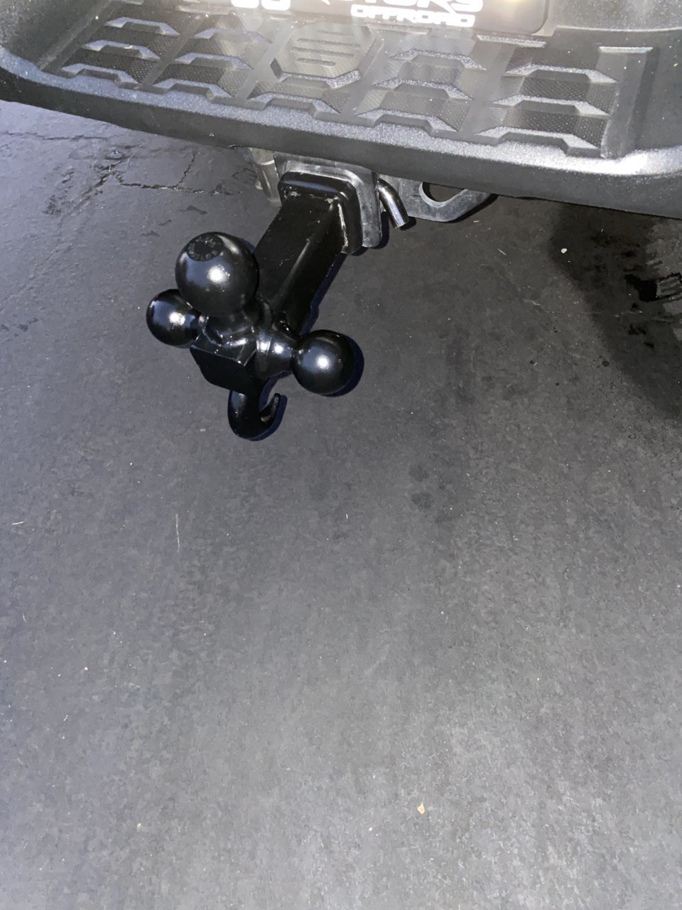

    black metal gets hot as hell too. Especially in the desert sitting in 116 all day. I used same method here on my tow hitch 4 months ago it still looks flawless. Also did my accord image.jpg image.jpg
