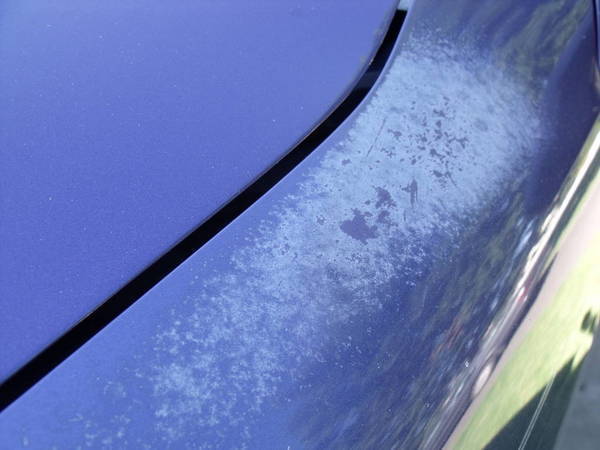

    Hi all. My paint is fading or the clear coat is coming off. Can this be fixed without repainting the entire fender or am I sol?
    Here is a pic

    Your paint is delaminating - i.e. the clear coat is failing and coming off. The only repair is to remove the faulty clear and repaint.
    Also, if the hood is not showing signs of the same problem - it was likely repainted.

    Toyotas don't typically have this problem, my bet it was repainted, probably by Macco or something. You can try polishing off the clear, and get it reapplied, the the paint is probably faded by now, so you'd need to paint anyway.

    Isn't a '95 taco paint job single stage? No clear just enamel paint. My '96 was.

    Complete refinish!

    My ’91 Toyota pickup started doing that on the roof. It was just dime sized and then eventually consumed most of the roof. I was told they had to change the clear coat formula in the early 90s due to EPA stuff. I see quite a few 90s cars with similar problems. I never found a cheap way to fix it.
