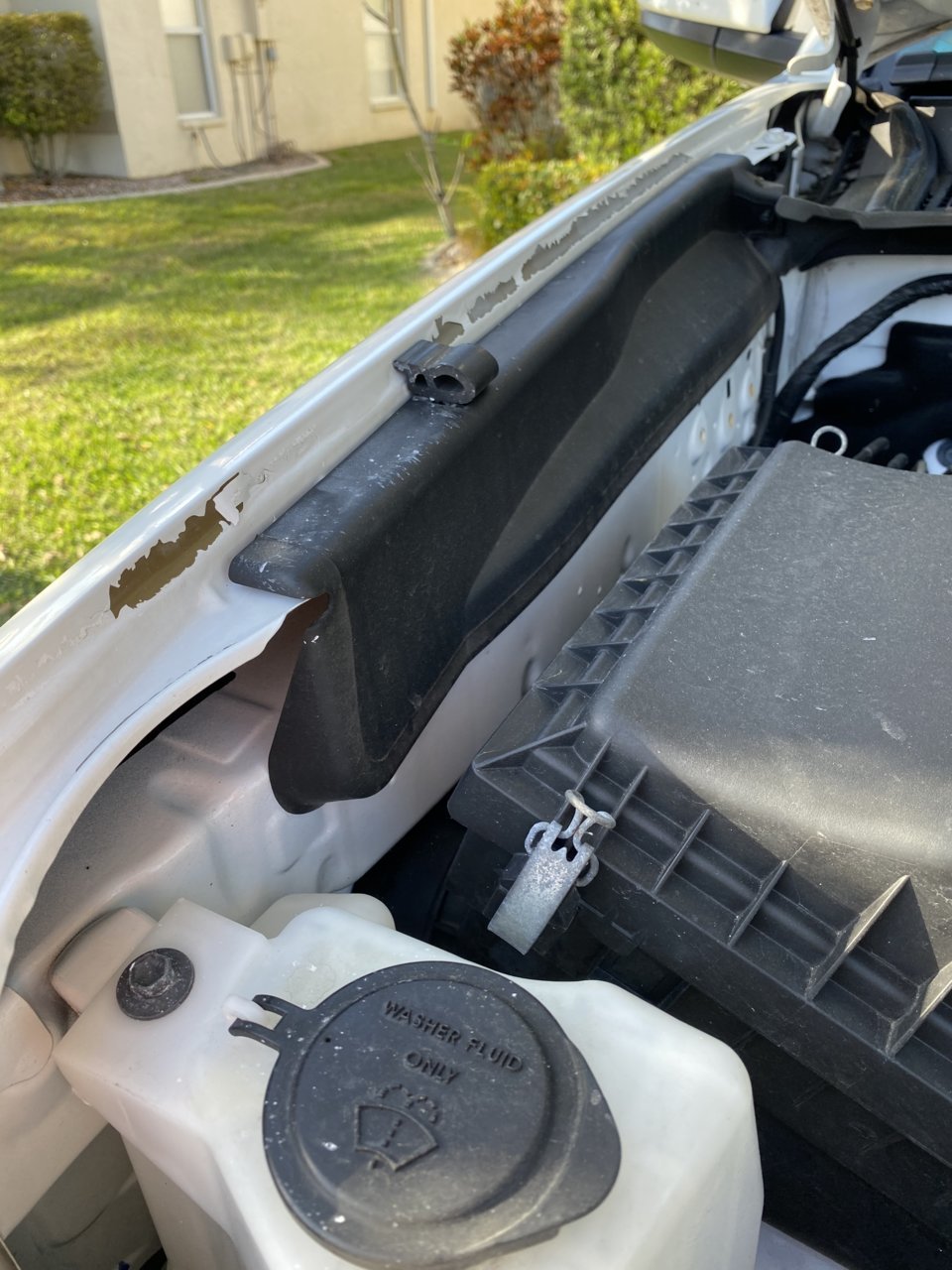

  1. Nov 3, 2020 at 2:56 PM
    #201
    808twig
    808twig Member
    Jul 27, 2016
    #193011
    7
    Maui, Hawaii
    2016 Tacoma TRD SPORT 4x4

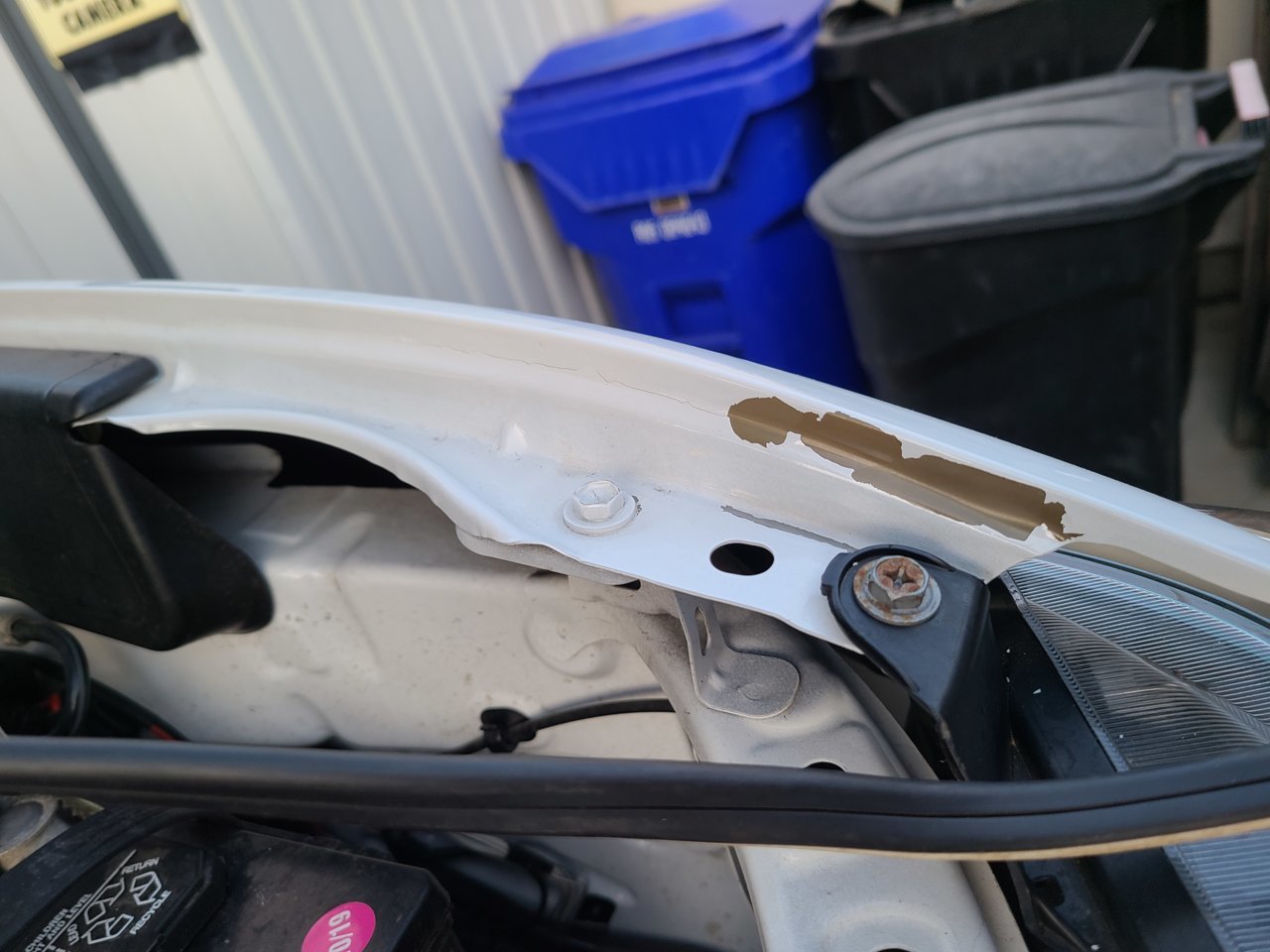

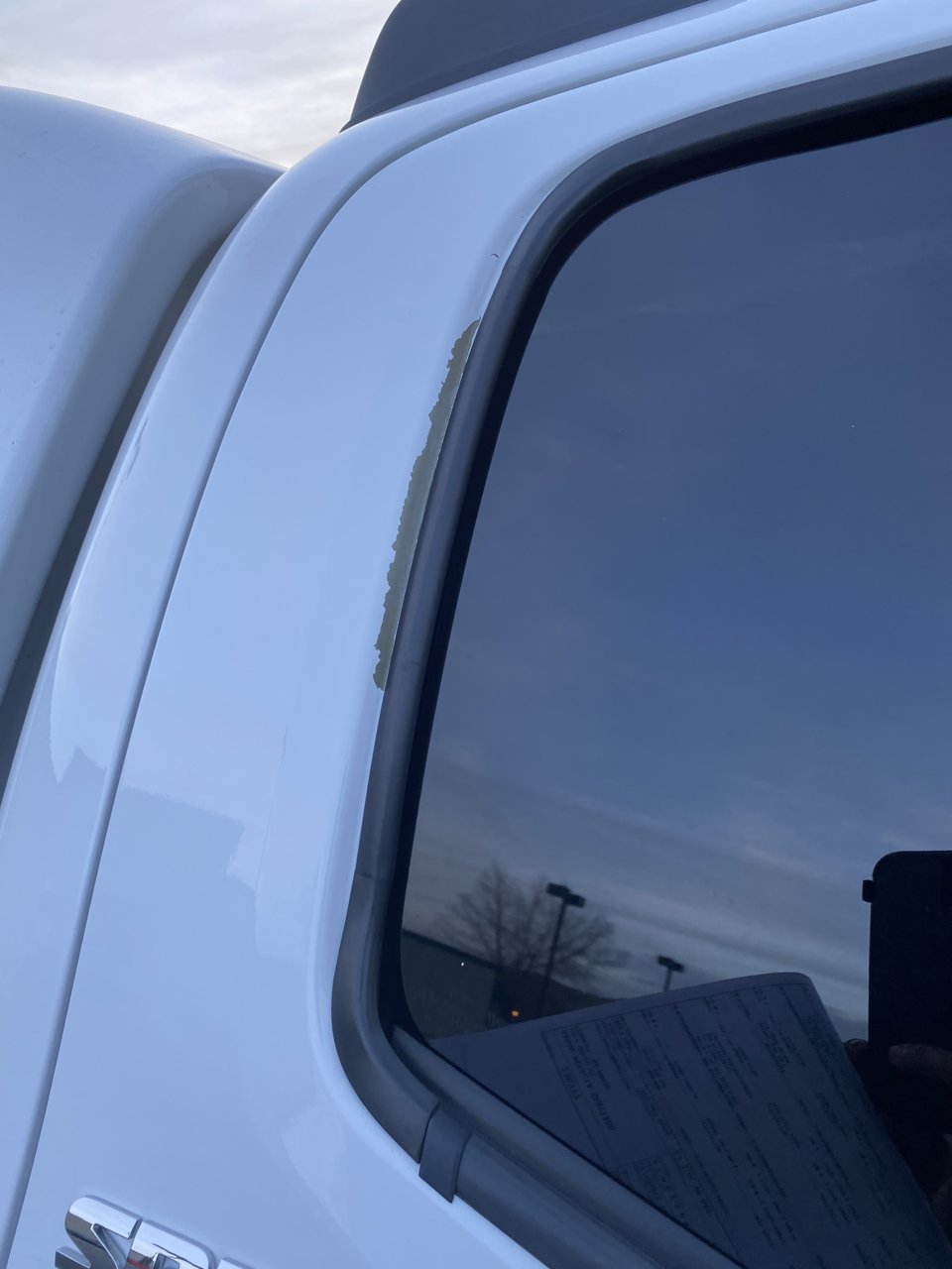

  2. Nov 3, 2020 at 2:58 PM
    #202
    808twig
    808twig Member
    Jul 27, 2016
    #193011
    7
    Maui, Hawaii

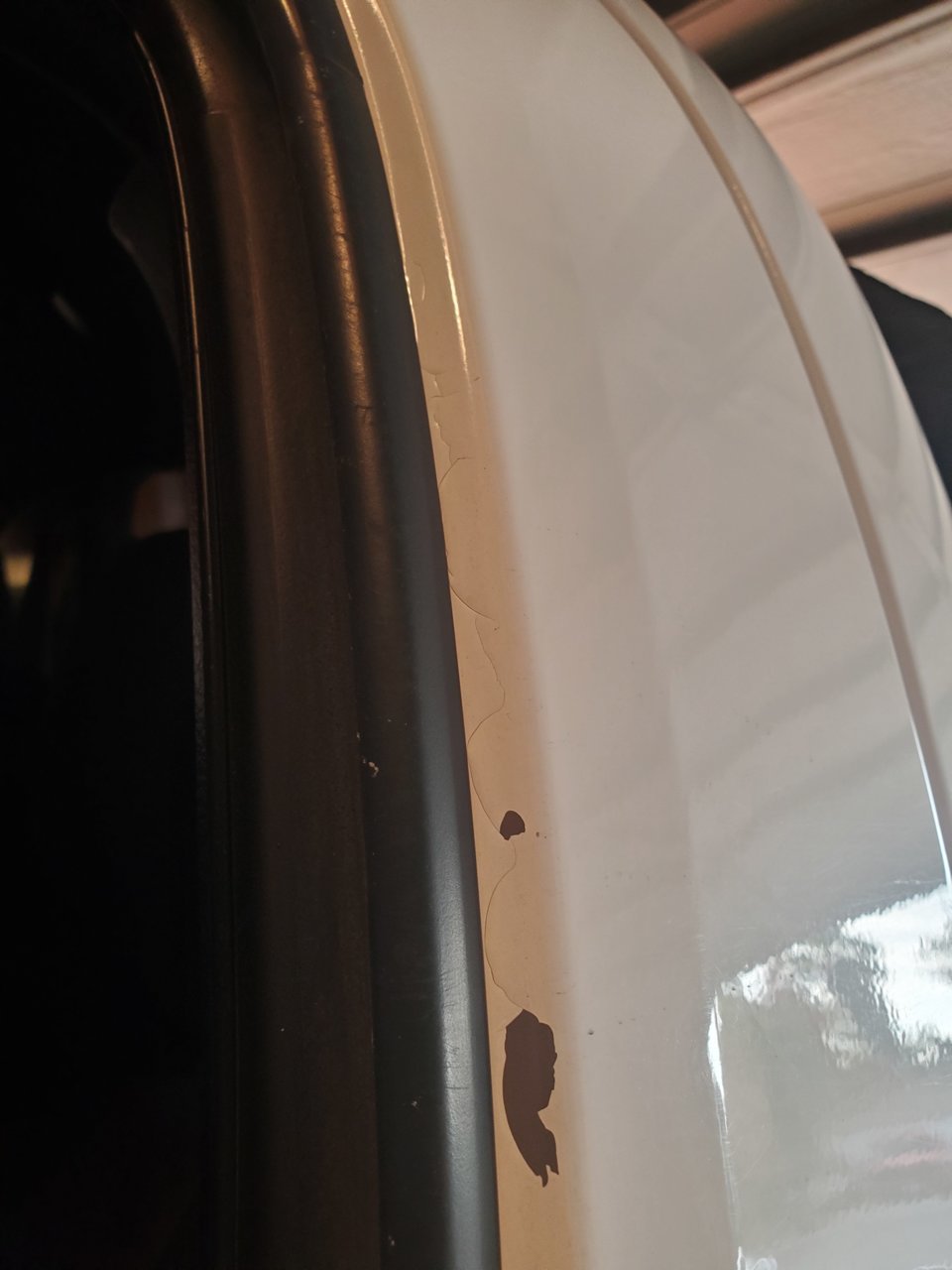

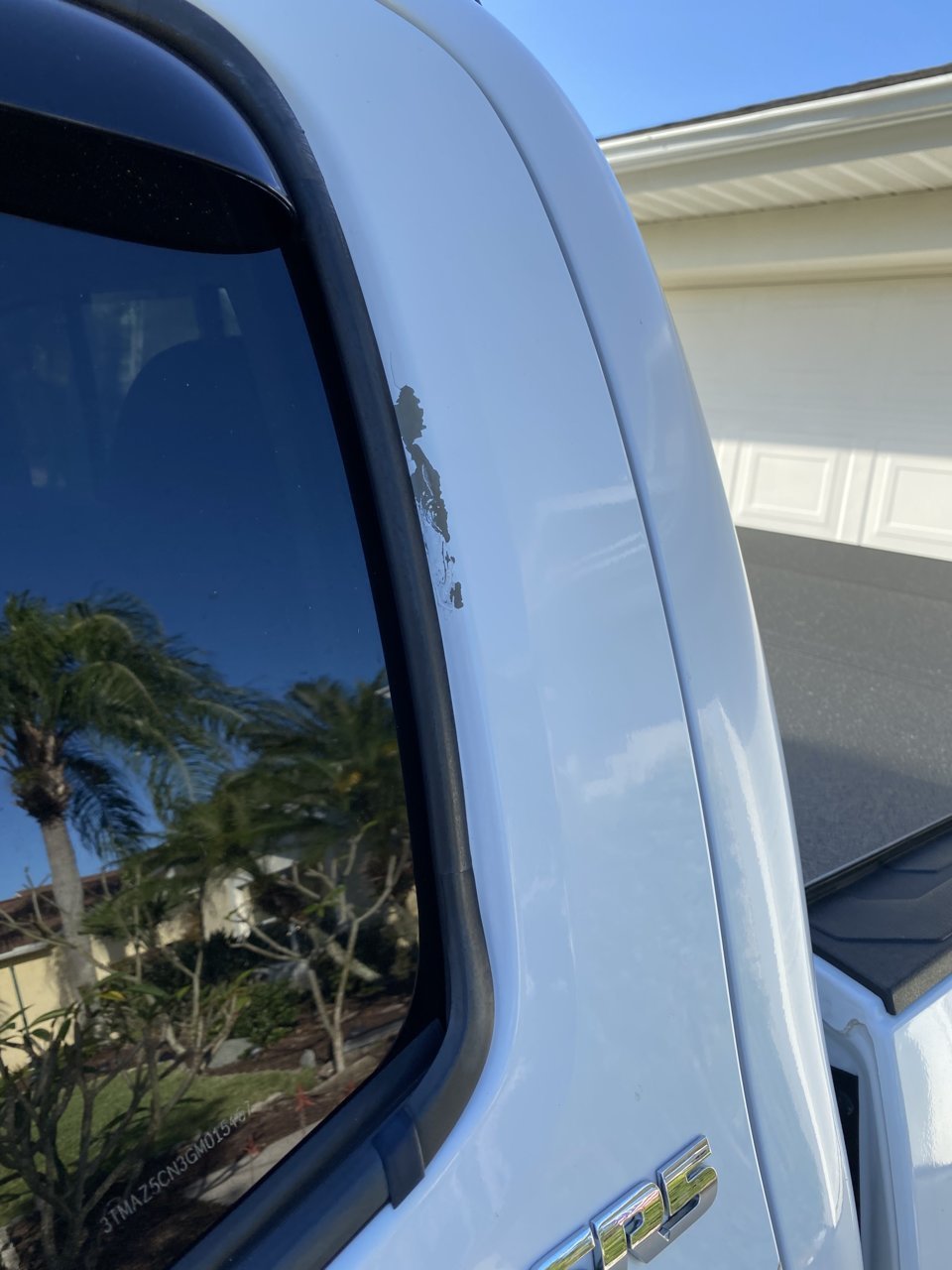

  3. Nov 3, 2020 at 2:59 PM
    #203
    808twig
    808twig Member
    Jul 27, 2016
    #193011
    7
    Maui, Hawaii

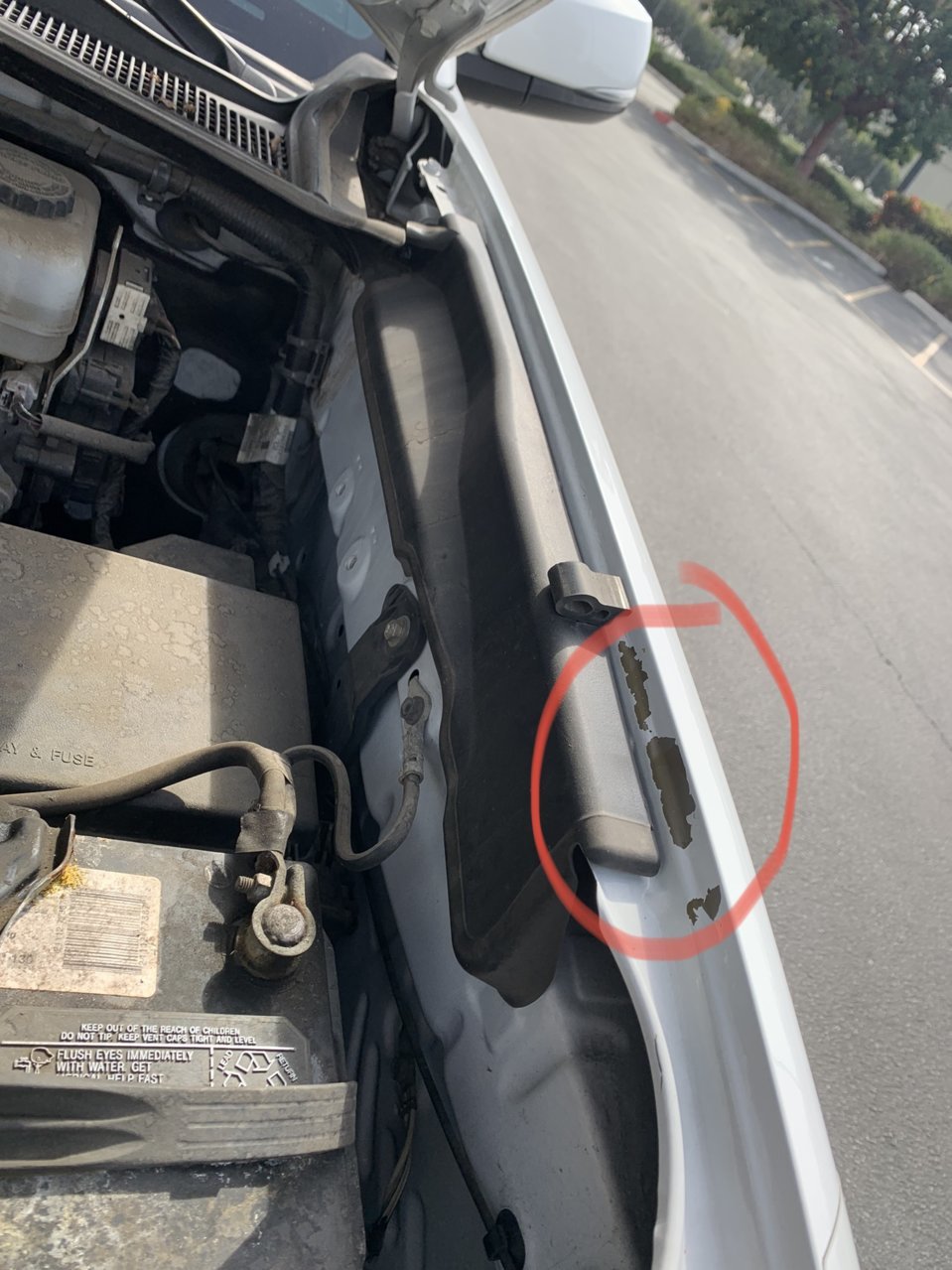

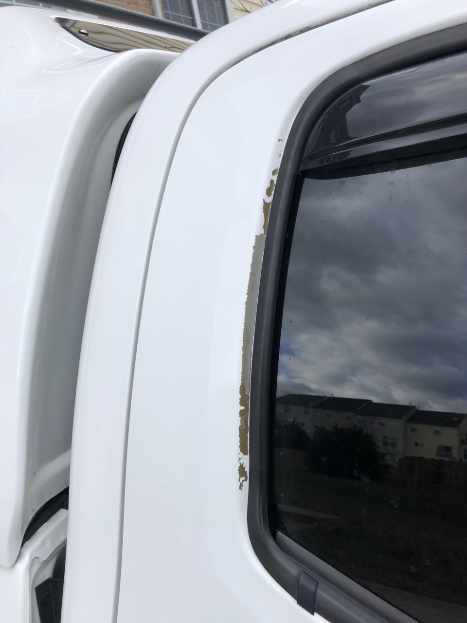

  4. Nov 23, 2020 at 1:41 PM
    #204
    sig916
    sig916 Well-Known Member
    Nov 2, 2014
    #141536
    891

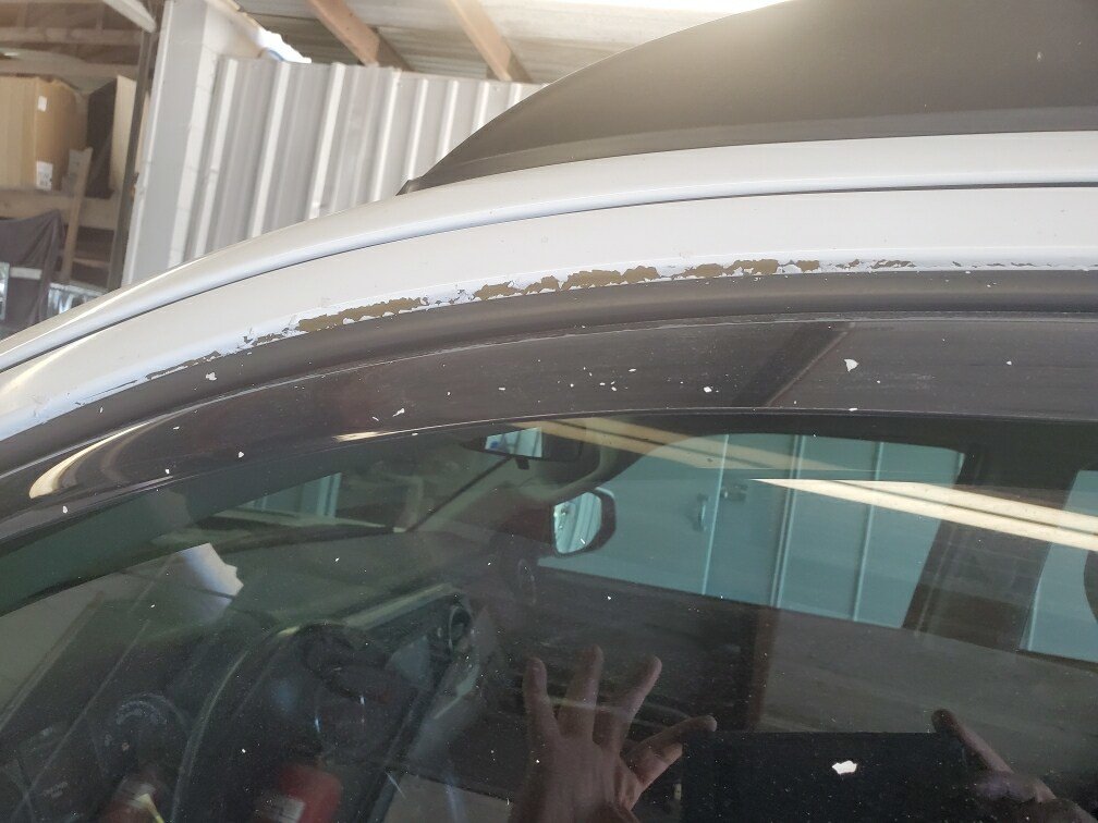

  6. Dec 30, 2020 at 1:31 PM
    #206
    CharlieWork
    CharlieWork Active Member
    May 25, 2017
    #219883
    28
    VA
    2017 Tacoma TRD OR DCLB
    ARE MX Mobtown Sliders
    I’m getting it on both sides now Anybody heard anything from Toyota corporate by way of service campaign/TSB?

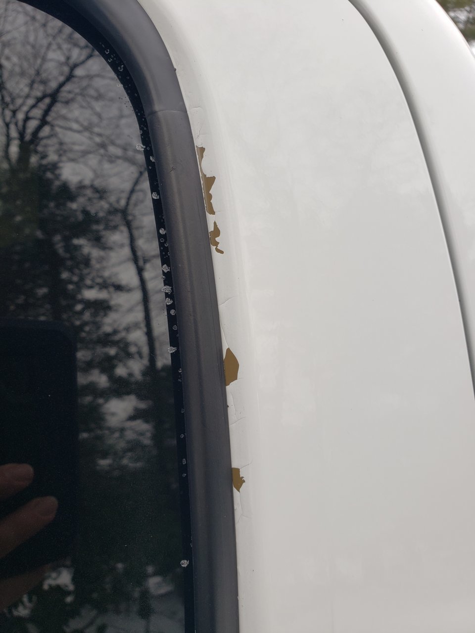

  7. Feb 5, 2021 at 6:57 PM
    #207
    cHUB
    cHUB New Member
    Mar 18, 2017
    #213672
    2017 White TRD Sport DCSB 4x4

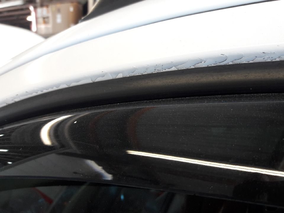

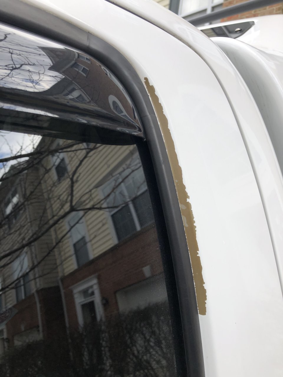

    Just noticed my 2017 doing the same thing today. Same spot on both rear doors next to the window and looks exactly like the photos in this thread. Truck has a little over 40k on it. Pretty disappointing.
    My question for those of you who have taken it up with a Toyota dealership and were successful in getting them to repair it is are you going to the same dealership you bought from? The dealership I bought my truck from is a couple hours away but I have taken it in for services to a local dealership closer to me a couple times. Wondering if it would make any difference? Or has anyone been told “tough luck” by one dealership and then gone to another where they were willing to help?

    Ok well. Seems as though I'm not alone. Add me to the list of disgruntled Tacoma owners. 2017 TRD Sport in white none the less. Just noticed the other day that paint is peeling/flaking off around drivers side rear window. Upon inspection the paint around passenger side rear window seems to come off with the scratch of a fingernail. So that side is only a matter of time as well. 60K miles and past warranty. Toyota basically told me not our problem, as it was past warranty. Dealership has no recalls on file so they wont do shit either. They have paint recalls for other models (Camry, etc.) with this issue. Why are they excluding Tacoma when it obviously is affected? Has anyone been able to get resolution past warranty? Toyota needs to make this right. I'll die on this hill.

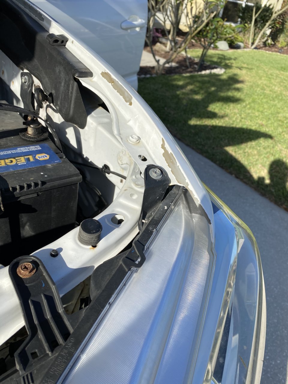

  9. Feb 16, 2021 at 12:35 PM
    #209
    Hooper89
    Hooper89 Well-Known Member
    Sep 13, 2019
    #305186
    1,577
    2016 White TRD Sport

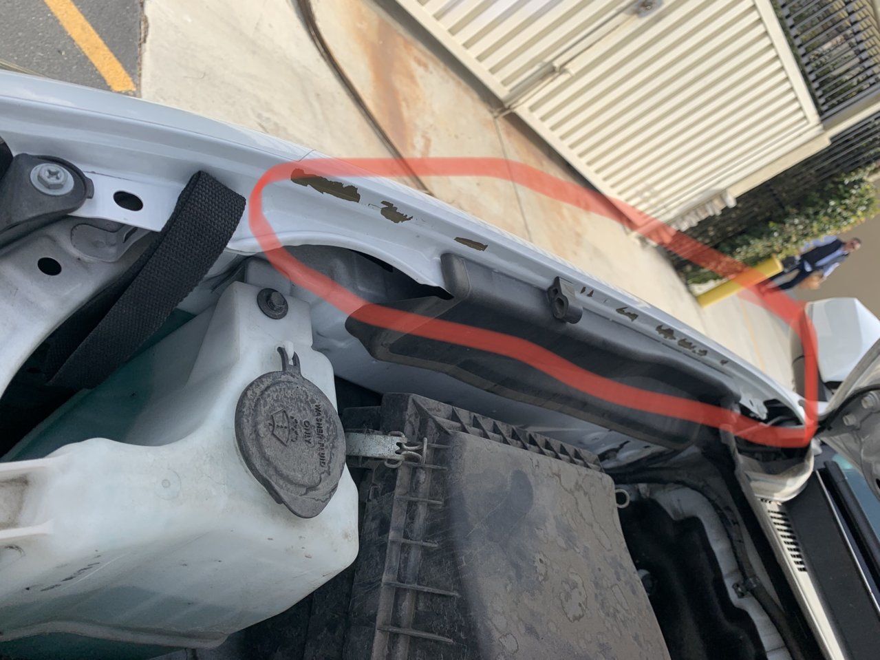

    Toyota fix my front fenders but it took a year of me fighting them. Same exact as the other guy in the picture with the hood up peeling on the inside. One of the big reasons I’m thinking about selling this truck. Do not get a white Tacoma.

    Clean it with alcohol very lightly using a blue shop towel, Gently scuff it with a scotch pad and the area around it and brush on touch up paint or else it will run away on you

    Hello everyone. I have a 2016 Tacoma TRD White with 61,000 miles on it and my inside fender is also peeling. I took it to the dealership and they said paint is only warrantied for 3 year 36,000 miles. I have an 8 year 125,000 mile platinum extended warranty on it but that does not cover paint. I called toyota USA and they also said it’s not covered past 3 year 36,000 miles. How do we start a class action law suit?

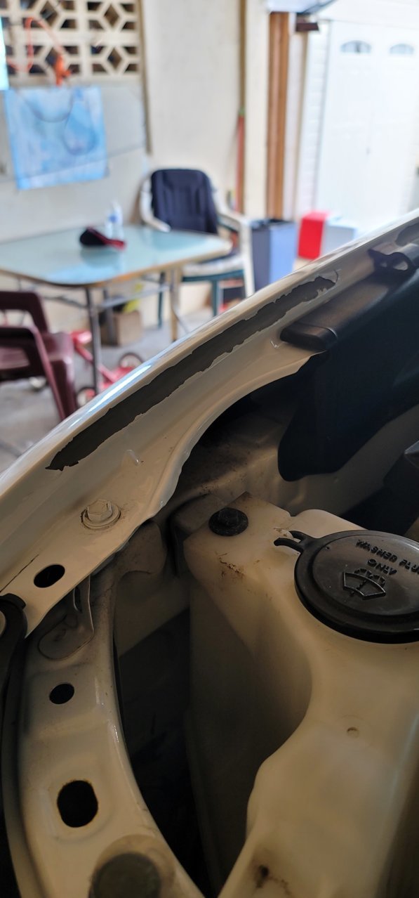

  18. Mar 1, 2021 at 10:39 AM
    #218
    Kenmak
    Kenmak Member
    Jan 28, 2021
    #354289
    16
    2016 Tacoma SR5
    Same. Exact. Issue.
    2016 Tacoma SR5 in Super White. I took it back to the dealership, they took pix and sent a $2300 quote for repairs to Toyota corporate. Toyota corp offered 10% ($230). I called Toyota for resolution and the basically said it's out of warranty and there's no recall so tough tomatoes.IMG_6644.jpg IMG_6644.jpg IMG_6645.jpg IMG_6647.jpg
