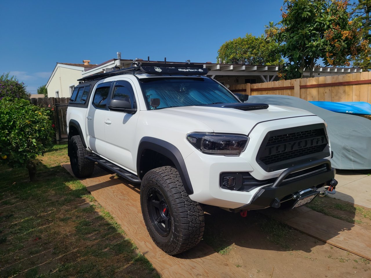

    Well guys good news. I finally got my truck back from the paint shop last week. My local dealer finally worked with me and sent it to their body shop. It took 10 days to paint but they ended up doing all four doors and the two front fenders since all of those had signs of peeling. It was about a $3,000 job that they covered. My truck has always been meticulously well taken care of by me so pretty much after this paint the truck looks brand new. So for you guys in the same situation keep truckin on. I hope yours gets repainted eventually.

    How did you eventually get the local dealer to work with you? I'm having the same issues you did. Such a bummer and frustrating. Thanks for the help.

    I just kept bugging one of my local service guys despite there still being no recall. Once I finally started showing the truck peeling under the hood on the fenders I think he finally took me more seriously. I kept also mentioning about other guys on the threads saying it was repaired on "good will". But yeah my peeling got soooo bad. Around 4 windows and both front fenders.
