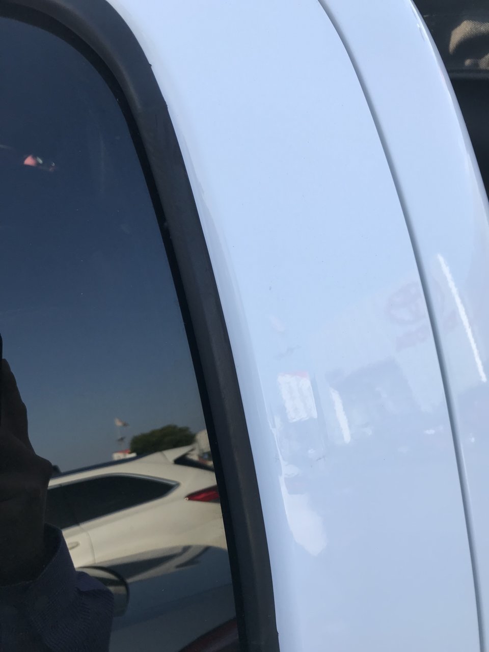

    Yes bought it completely new a little over 2 years ago. Not sure if that is primer or paint under there, but it really easily flakes off. Almost in the exact same place as the OP so I'm wondering if it's a larger issue with how they painted those areas.

    Dropped the truck off this morning and just heard back from the dealer. They will be repainting the area since it is still under warranty. Was also able to take care of the steering/surging tsb while there. Happy that Toyota is making it right!

    Two weeks later, looks good again!

    I just brought my truck in to the dealer and showed him the paint flaking off. Service advisor said he saw several white trucks already with the same issue in the same place so he already knew what the process was like. The body shop inspected it the same day and offered to repaint it which took about 2 weeks. Dealership provided a rental of any Toyota vehicle I wanted during the 2 weeks. This was at Longo Toyota in El Monte, CA.

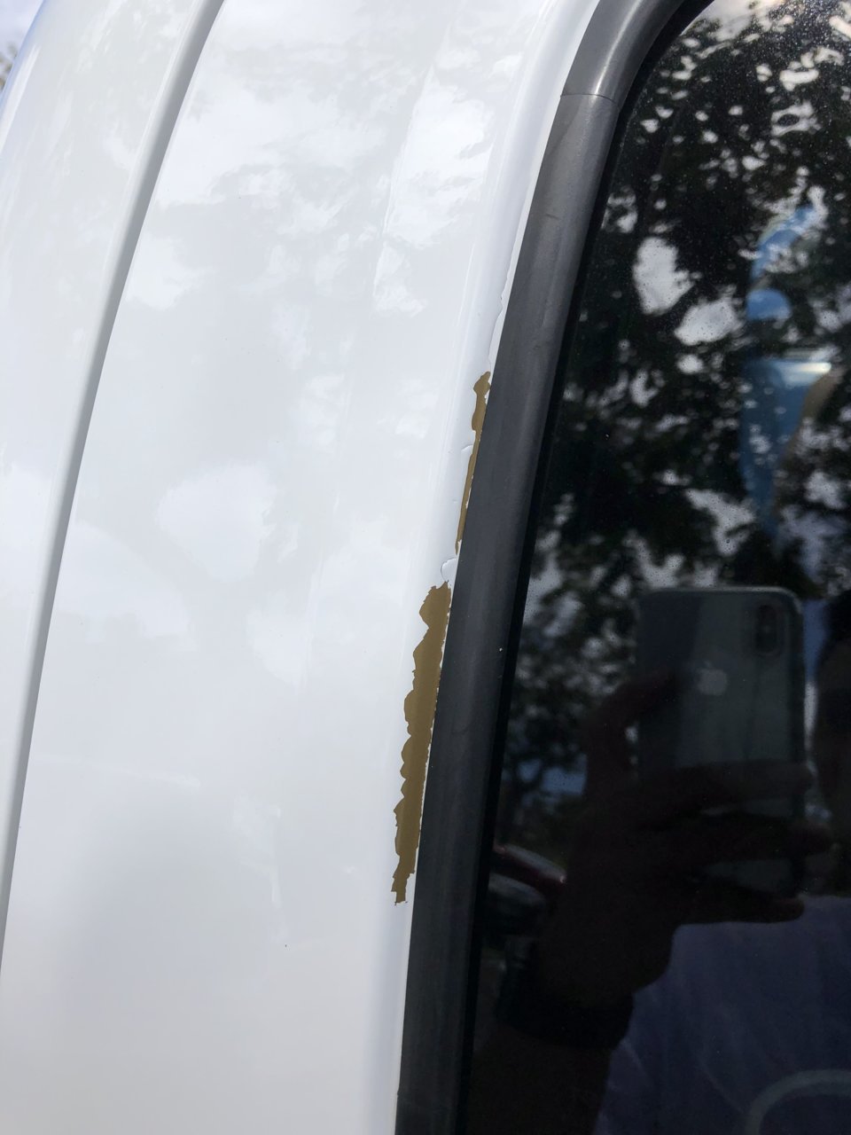

    That's 100% not a factory paint job defect. Someone had to repair and repaint that area - and didn't do it well.

    Looks like factory ecoat green underneath to me . A repair would be a grey or white sealer underneath unless filler was used in which case it would be a gray primer . Looks like there was a delay in the production line and the ecoat reached the end of the topcoat window and there is a bonding issue. Will be covered by warranty if he hasn't hit his mileage or time limit .

    Bodyshops dont have access to factory green E-coat.

    Wouldn't be surprised to find the manufacturing date is either the same day or really close to the point that the E-coat was the same batch number .
