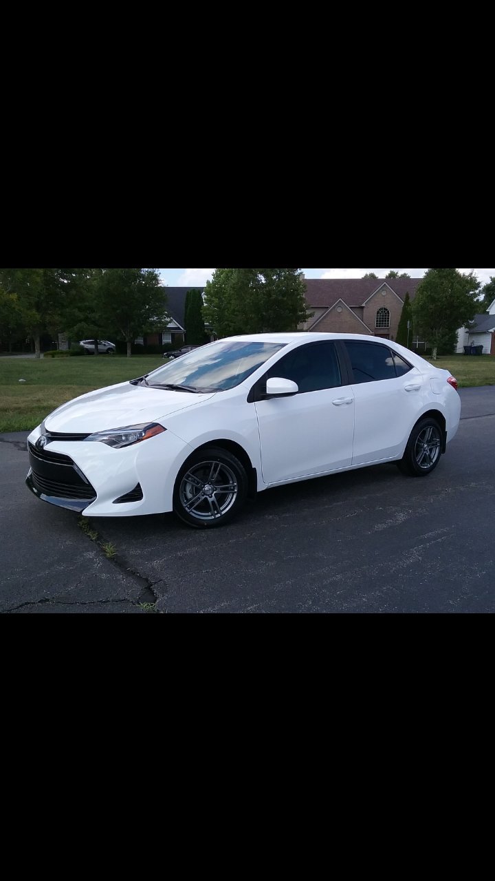

    All Toyotas bodies are dipped and fully submerged prior to painting into ED material then baked. This is really what provides the corrosion protection more so than the paint itself. Once this ED is baked it turns a drab Army looking green.
    As for the adhesive issue? I don't know. All bodies are processed and prepped the same way regardless of the color. My best guess would be a material issue with the supplier. The fact that it's happening across multiple models produced at multiple plants tells me it's a material issue not a process issues. I believe PPG and NPA provide Toyota with most of their paint...at least in N American. Not sure about other counties.
    I would say the majority of white vehicles are fine. But there seem to be batches that pop up here and there.
    My Tacoma and wife's Corolla....even my daughter's old 068 Polar White Yaris all look great.
