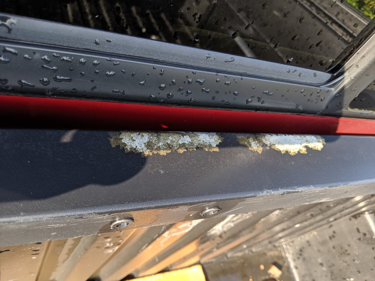

    Dealer ain’t gonna do anything you can see the damage to the rear window sill. Obviously the rail got scratched and is now corroding because of it

    Here's mine. I live in Texas, so I'm thinking its just sun blasted. I just bought the truck, and I'm looking into removing it to paint it, and was wondering what paint would be best? A flat black I'm assuming, but a "Rhino liner" type treatment might look nice as well. thoughts?

    I had the same Issue, I was blaming my dirtbike tires, because the peeling was right where the tire stop.
    The peeling on my 16 looked more like OP but right in the center and about the size of a quarter.

    or is that the reflection thru the window? looks like an old truck to me? where is OP?

    No, sorry that's a reflection. The OP had the seal damage, mine is just the paint area shown.

    Looks like something was rubbing on it, maybe the forks or a part of the bike

    Wouldn't hurt to wash it once in awhile. Pull the rail off and paint it......problem solved

    UPDATE: Took about 10 minutes to pull it off with a T30 star ratchet, and looks good as new.
    BTW: There is a factory applied tin strip of foam on the inside lip. I went to Lowes and bought this and it works great. Actually thicker (and at $3.40 definitely cheaper) than the OEM one, and it actually made a better seal once sucked down when the bolts are reattached.
    I used the Krylon Truck bed coating, and it couldn't of been easier to apply. Went on super smooth, no troubles!
