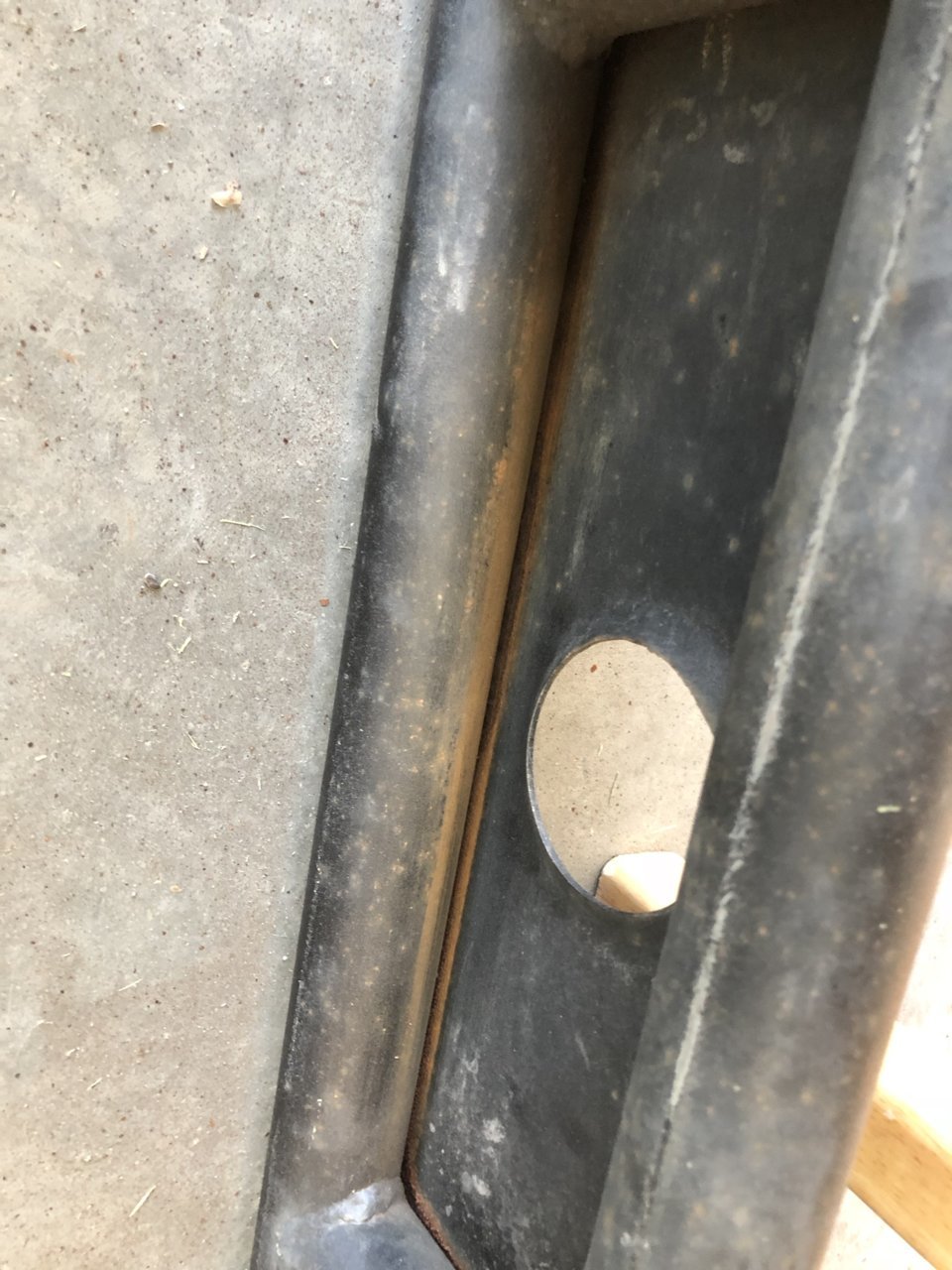

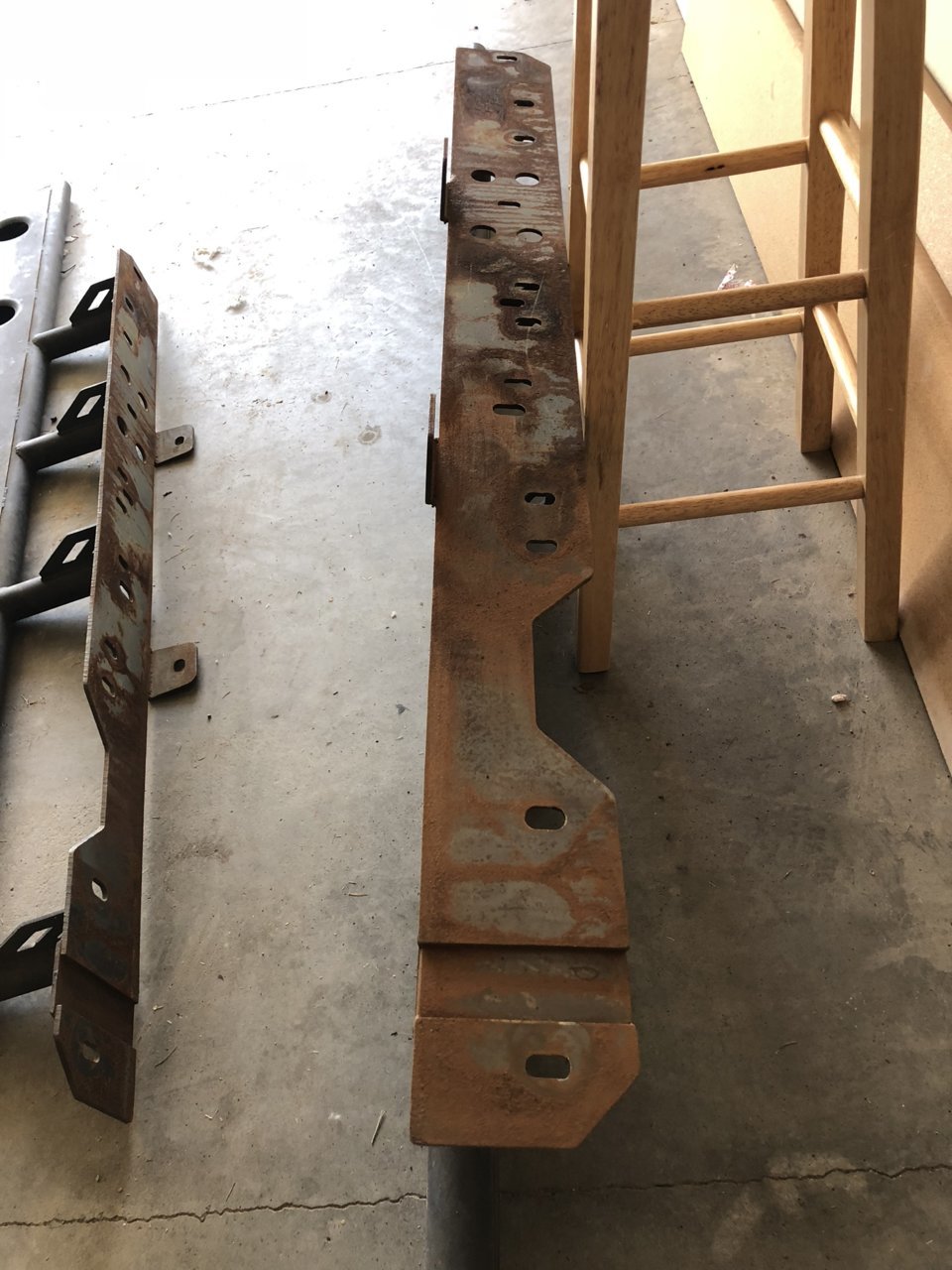

    I used por15. I think those that have had bad luck with it did not follow all of the steps. Degrease, metal prep solution then paint. I had a set of used sliders that I got that a rattle can was used on. Lots of rust spots from missed areas that are harder to get to without a brush.
    Edit the backside of the skids when purchased where not painted...I would not want that rust against my frame!!!
