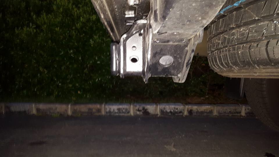

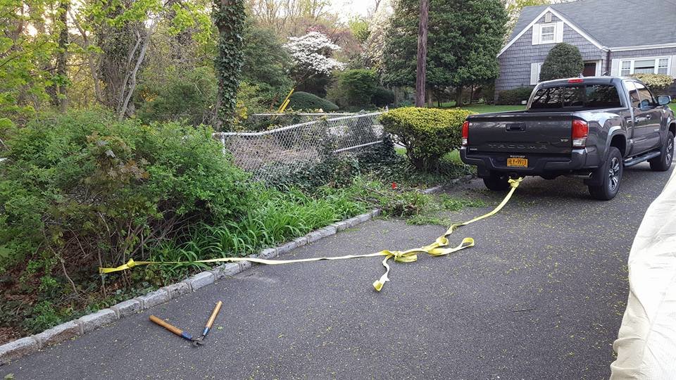

    I was pulling some bushes out & tried a stump that didnt want to budge, it bent the thing on the side of the hitch a little bit, i had a tow strap looped around it.
    Was able to bang it pretty straight with a mallet & some wood, but need to paint it.
    Anyone know what the OEM color is for Tacoma underbody?

    lol i know black, is toyota #202? or another color

    Honestly, I don't know. You might just try Rustoleum or something similar in a generic black, and just spray the whole hitch if you're concerned about it not matching.

    I would use Rustoleum gloss black.

    I would respray whole tow hitch

    Black sharpie! J/K, but good job on straightening out that hitch. Looks as good as new.

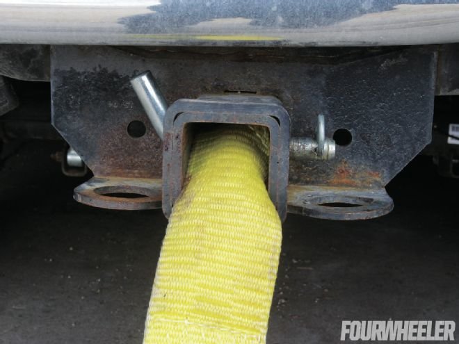

    Just a heads up for future it is much better/safer to put a hitch pin through the eyelet of your strap and put in the hitch...
    i imagine any gloss black should be close enough.

    It appears to be closest to satin black. I would get a little brush and a spray some epoxy primer into a can, paint with the brush, they top coat the same way with satin black.
