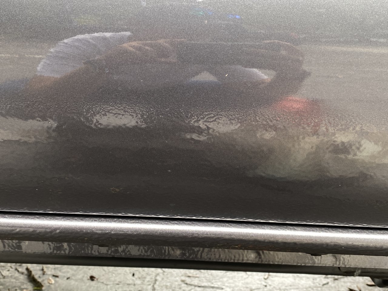

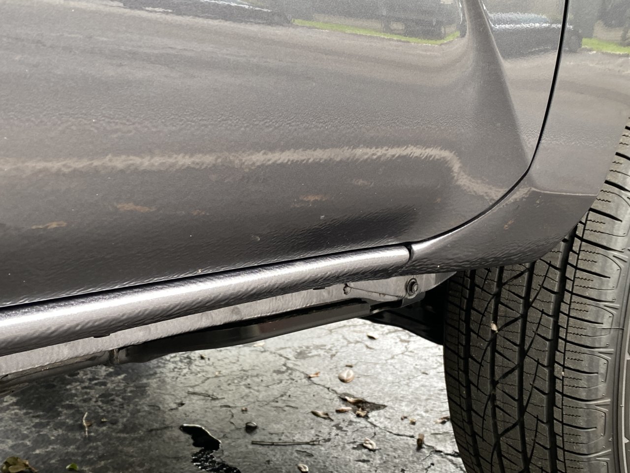

    I noticed this today. Truck is less than 2 weeks old.

    Yes. It's called orange peel and it's done on purpose to protect areas more likely to take rock hits.

    Rock guard. to guard, from rocks

    Kinda yes.
    Orange peel is the texture that clear coat gets after its been sprayed on a car. This is usually wet sanded and buffed to reduce it.
    What the OP has there is a thick coating they put on the lower half of the car to protect from rocks. The rocks will still damage the paint there, but they will not penetrate the thick coating under the paint causing rust.
    Most trucks have something like this, many cars have it too.

    Yep my truck has the same coating, congrats on the new truck and may i say, great choice in color!

    It's not orange peel, before the colour gets sprayed on, they apply gravel guard to the lower sections to rocks kicking up from chipping away into the bare metal of the panels. What you see that's orange peely is the gravel guard, It should run from the bottom of your fender all the way to the back of the bed.

    I wondered about this as well.. It looked too intentional to be a mistake. Now I know!

    Yep mine has it as well, nothing to worry about. Congrats and enjoy!
