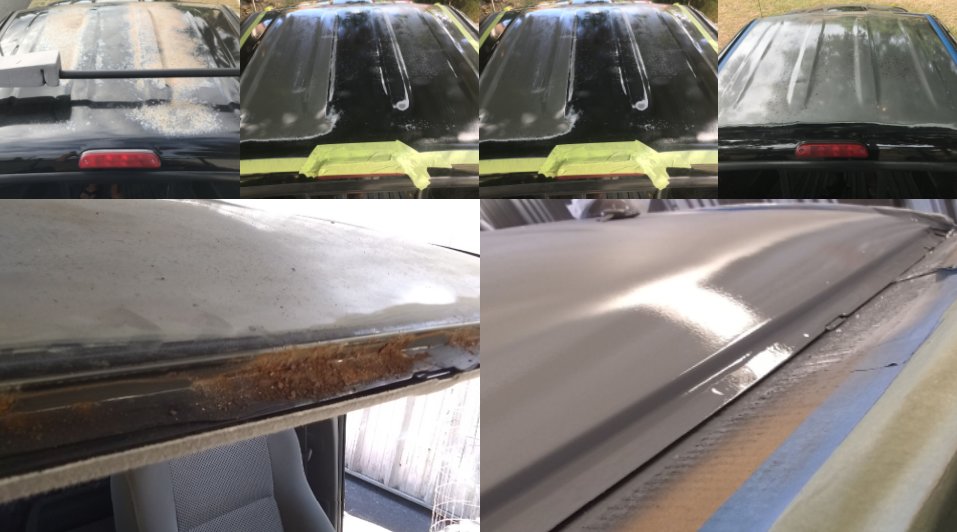

    Reviving an old thread here. My roof went from a few specks to a total bloom of rust. I worked with a paint guy to sand it to bare metal and put a rust treatment on it. Now in the paint shop and pulling the window we found the rust came from interior roof out. This is likely to poor treatment from factory rusting from air conditioning condensation.
    If you are sanding and respraying the roof. Pull the glass you will likely find problems there.

    Here are more comprehensive pictures. This should be a crime. On Hawai‘i seems like every Tacoma 05-15 has this problem. Maybe the sun and our content AC use.

    Rust it usually has to have a hole all the way through the metal. The problem is by the time that happens, it is well after the warranty is done. During the warranty it might start rusting but if it hasn't went through you are SOL.

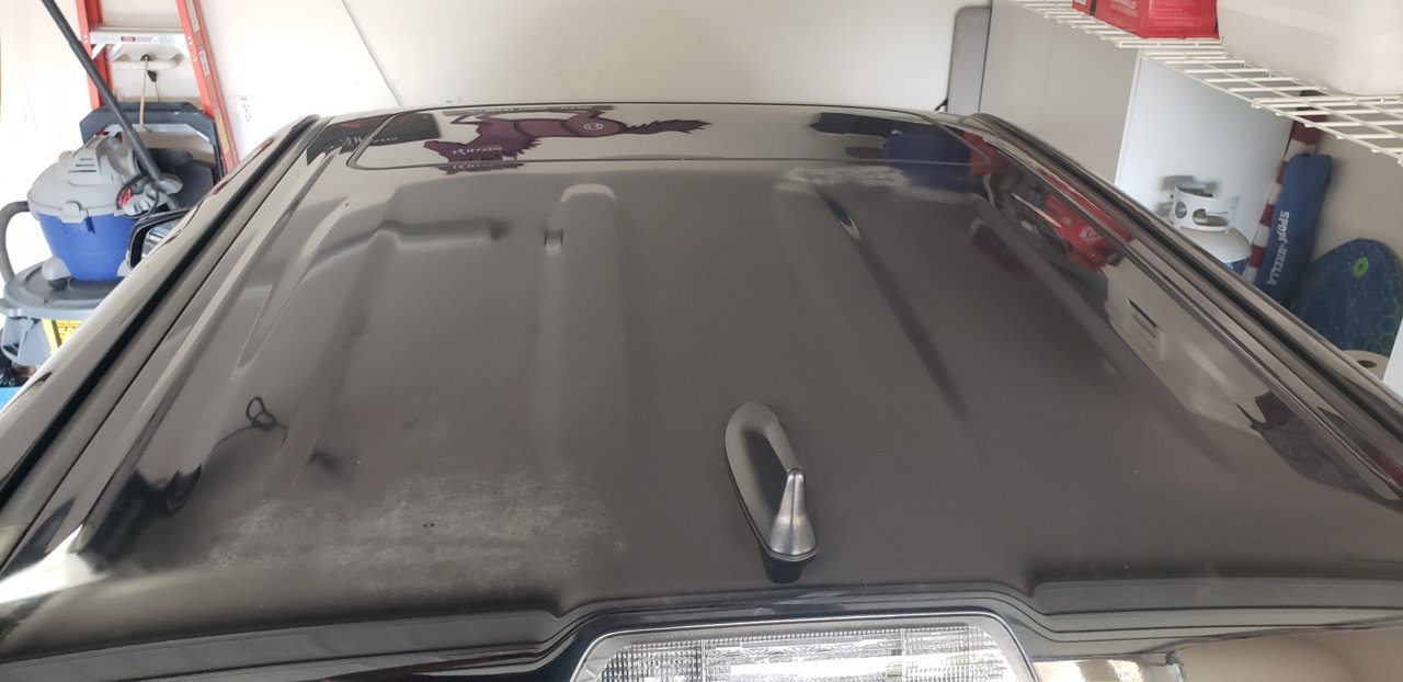

    I am having the exact same issues as everyone here with their paint on the roof of the tacoma 2016.
    It started with a small spot near the front. I brought it to the attention of Toyota less then 1year into my ownership, and they denied my claim. Calling it bird poo, or tree sap, now 4 years in and its all over the whole roof! I again brought it to Toyota's attention, yet again I get denied! We need to get this issue resolved! It needs to be fixed by Toyota like the 2004-10 models with paint issues on blue, black and red.

    Mines a black 2016, now with 75k miles.
    Bought sept 2016, first paint issue in Aug 2017 36800 miles. ( claim denied ) noticed how much worse just 2 weeks ago, and again ( claim denied ).
    There has to be a good contact to get this fixed and toyota to own up to their mistake in the paint.
