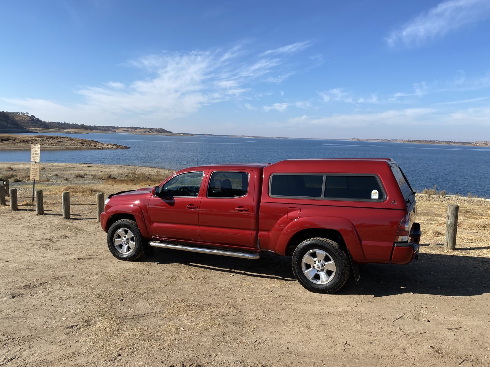

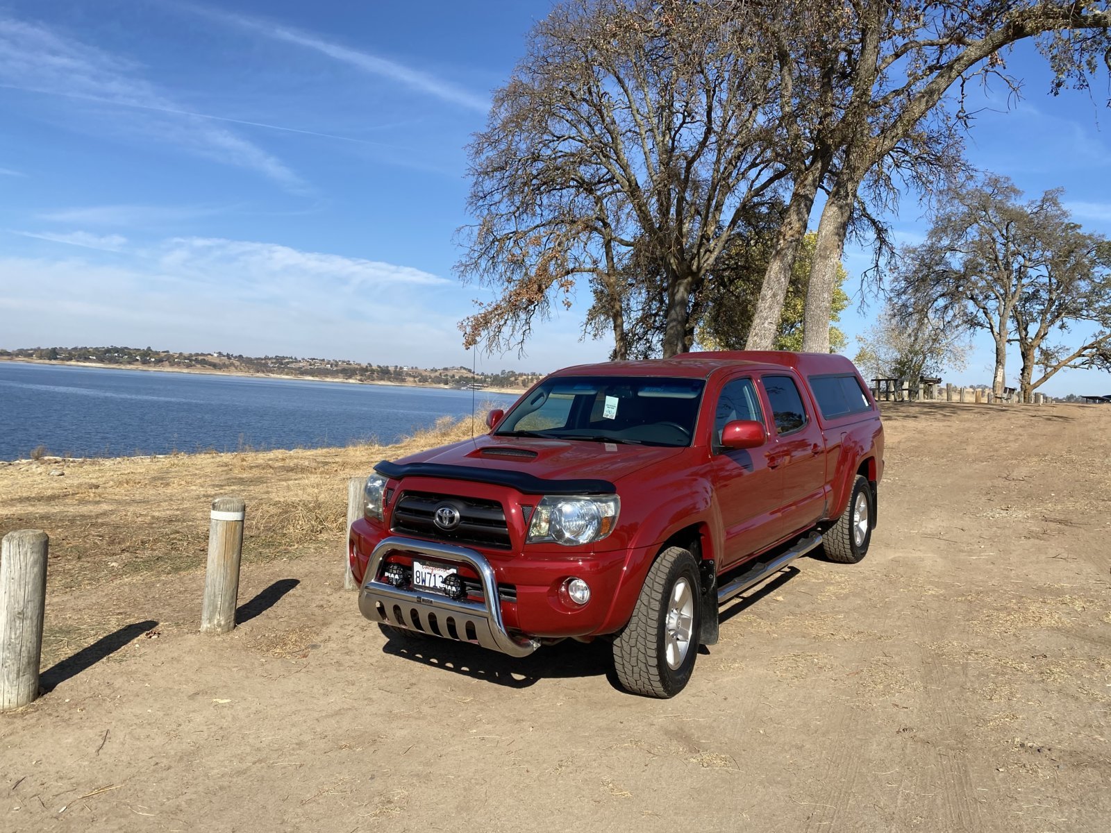

    Spending $6000 to $8000 on a 2006 prerunner paint job is insane. You will never ever ever get your $$$ out of it. Heres what I did with my 2009. Paint was fading clear coat peeling. I live not far from you in Elk Grove. I took mine to Maaco in Rancho Cordova a block from Costco. I didn’t do any prep. Just dropped it off and picked it a few days later. That was 4 years ago. It still looks like new. I got the 2 stage paint job and it looks as good today as the day I picked it up from the shop. They also painted my camper shell. Cost at that time $2500. I believe the guaranteed it for 4 or 5 years. I get compliments all the time on my truck. My neighbor across the street took his Chevy truck to the same place a month before mine. He loves his and it still looks great. A lot of people will bad mouth Maaco but my neighbor and I are completely satisfied with their work.
    Here’s a couple pics of mine

    Wow, your truck is gorgeous! If Maaco did that, then I am very impressed and will be setting up an appointment with them right away.
    Edit: Side note: Looks like these photos were taken at one of my favorite spots: Dike 8 on Folsom Lake (now known as Folsom Point, I do believe). Great backdrop. :)
