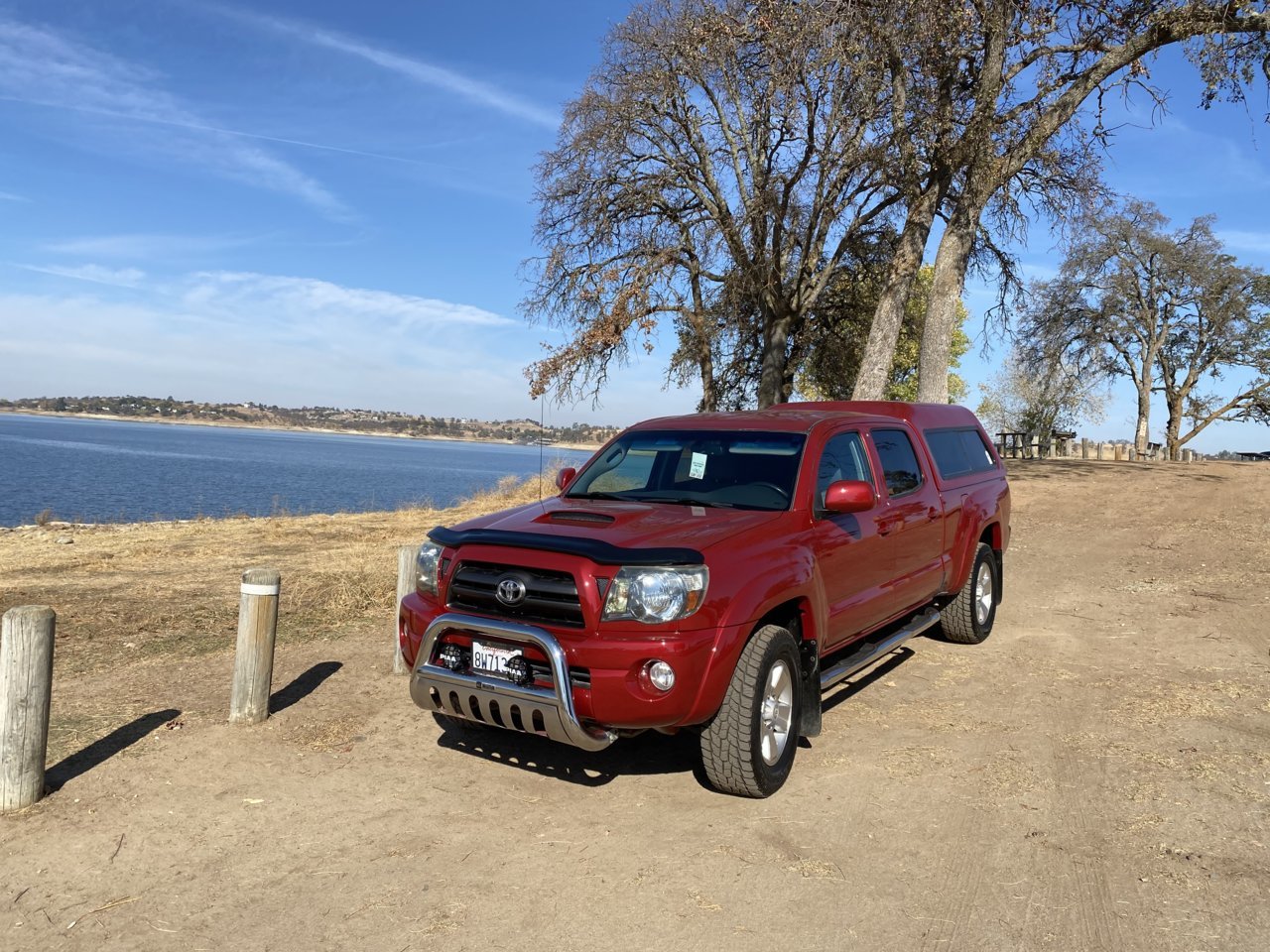

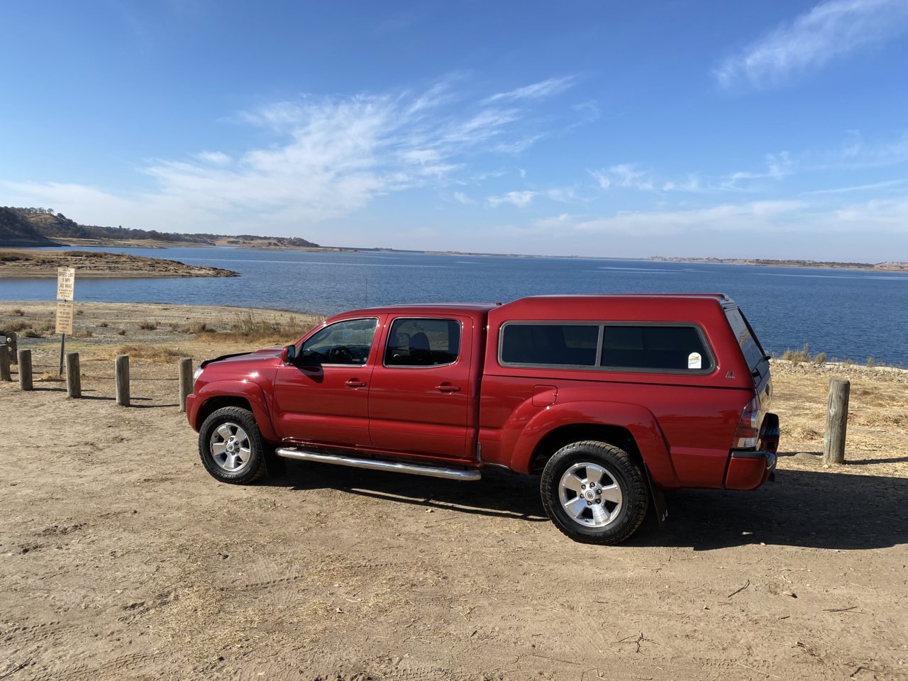

    Maaco varies from shop to shop. I got my complete truck and camper shell painted by a local Maaco shop almost 4 years ago. The truck looks awesome 4 years latter. I got their best paint job and paid only $2500 (they were having sales and discounts). I couldn’t be happier with their paint job, looks like new still today.
    Not all but the vast majority of people who bad mouth Maaco do so based on second hand information and not personal experience. I’m sure some of the negative comments are true, but again I’m happy with the job they did. Here’s a couple pics of the paint job (and the truck was dirty when these were taken)

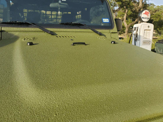

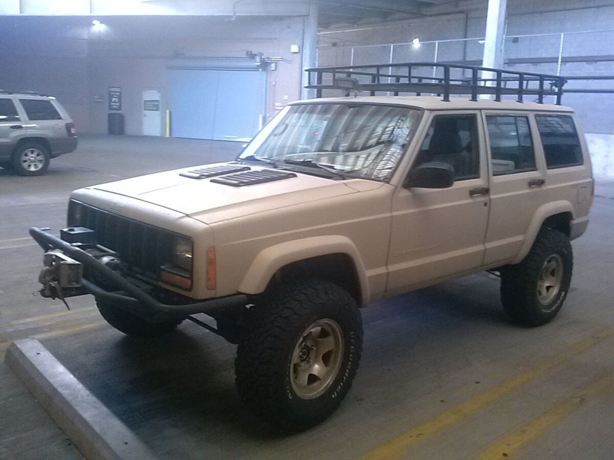

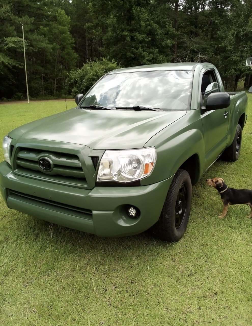

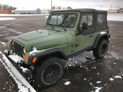

    so Amazon is saying $150 for Durabak and these are the pics I found so far
    Need to look into this one more
    Looks good…

    Durabak is a bedliner type material but in several ways is superior to Rhino or Raptor brands, particularly chip resistance in very cold weather. It also adheres a little better to some substrates. The non-textured version isn't glass smooth, it just doesn't have the "chunks" in it.
    Just make sure you rough up the existong surface (60 grit wet/dry), degrease (I like Simple Green), and mask (quality blue tape) before application.
    It also comes in a tintable formula but the tint (urethane tint) is obnoxiously expensive.

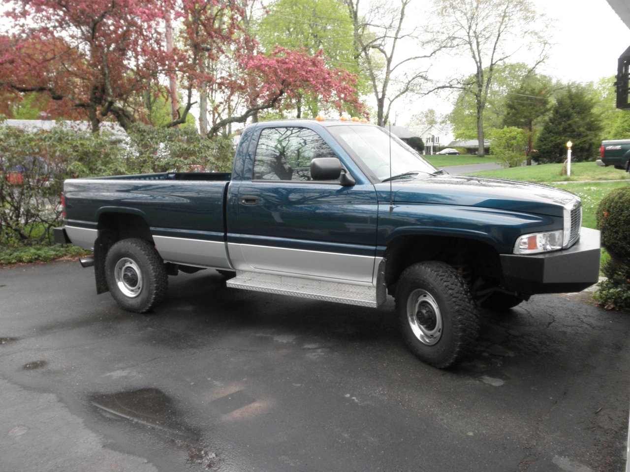

    Also, as another option: a vocational high school that has an auto body program would be a decent alternative. I had my old truck stripped and painted for the cost of the supplies and $400.00 “labor”. That was back in 2011 and the cost was 1300.00 to redo a Dodge Ram Cummins 2500 - lots of sheet metal on that pig.
    Edit: here’s the $1300.00 paint job done by high school kids at the vocational school. Bed painted as well.

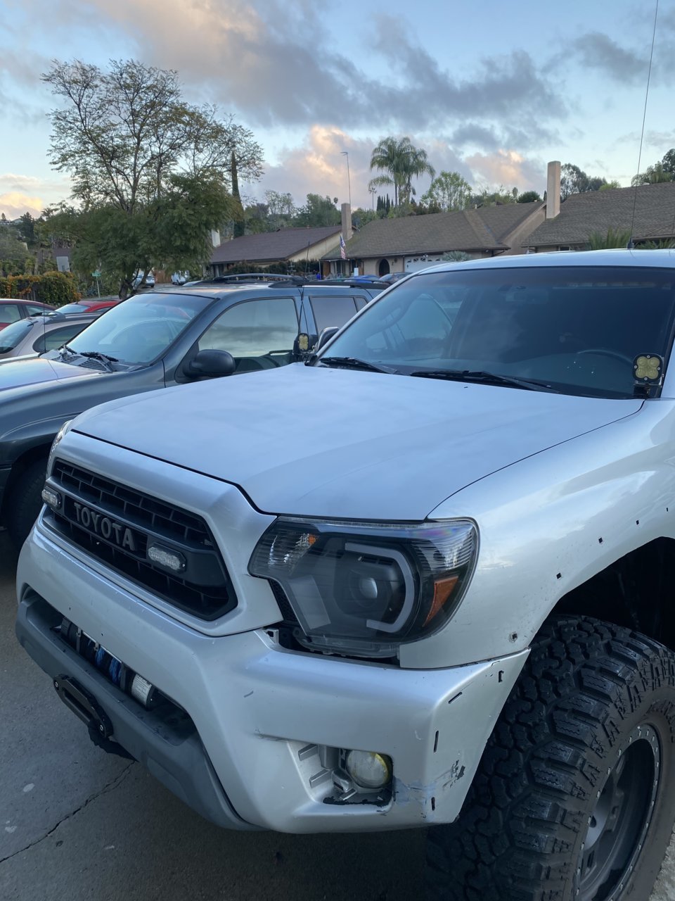

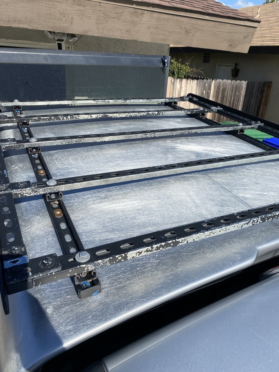

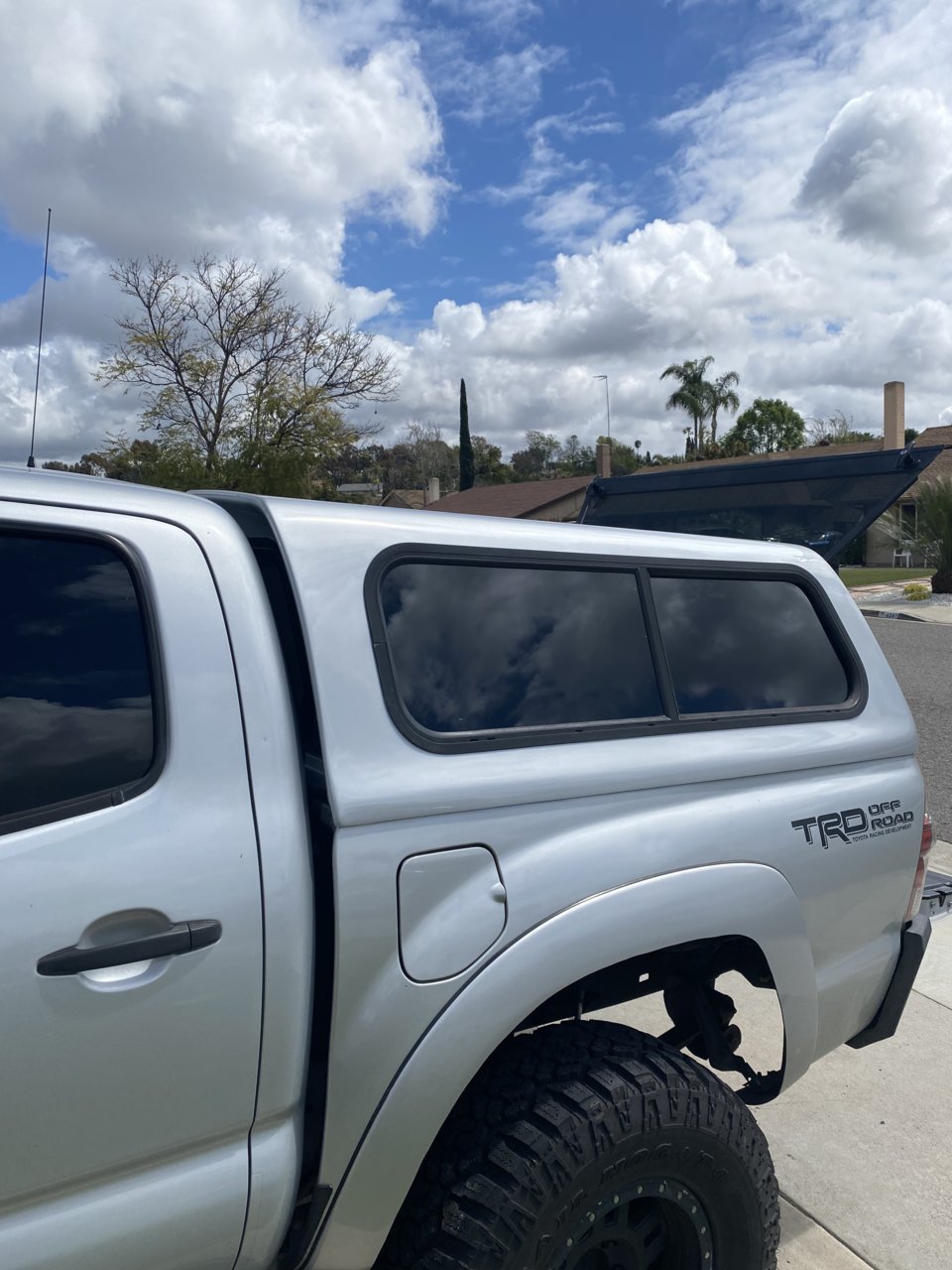

    I’m unfortunately also in the repainting the truck boat. I’ve looked at multiple shops in my area and they are all very expensive. I called Maaco in a city about 45mins south of me and it was significantly less expensive. However, that company does not have a good reputation and the online reviews ranged quite a bit. I’m still unsure of what to do at this point

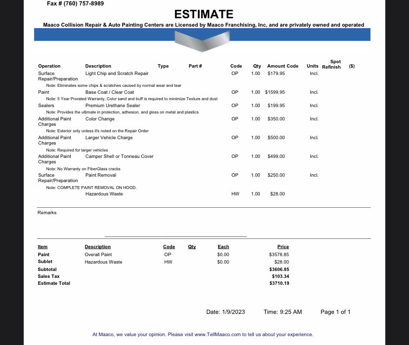

    Here was my full paint job estimate from Maaco 2CCCD8B4-E1BE-4198-9780-FE42D5A5C095.jpg
