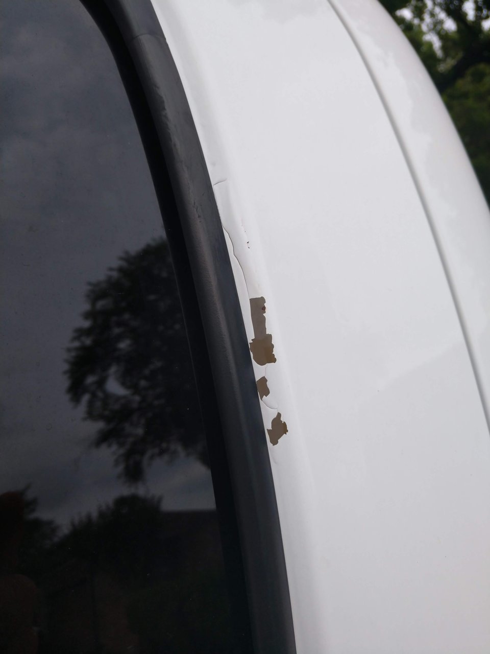

    Single stage 040 white is tough urethane that can be buffed down multiple times to renew. The downside is that it oxidizes faster than a clear coat. This is the more utilitarian option. The Toyota white 2-stage paint looks better because the gloss coat is specifically targeted for appearance. But the paint layer below is not as tough as single stage. I sprayed my 260z with high-end 2-stage pearl black in the garage a while ago and have sprayed Tacoma parts with the 040 single stage (PPG brand) in the front yard. The two paints definitely serve different purposes. I always suspected the white was single stage since that was the traditional work truck color, but I have no idea if this was part of Toyota's thinking.

    Since you don't list your location I am curious where you can get it done for $450 and have it look as if nothing had happened
    The quote I got for mine is just north of $1100 and that is not blending into the adjacent panel

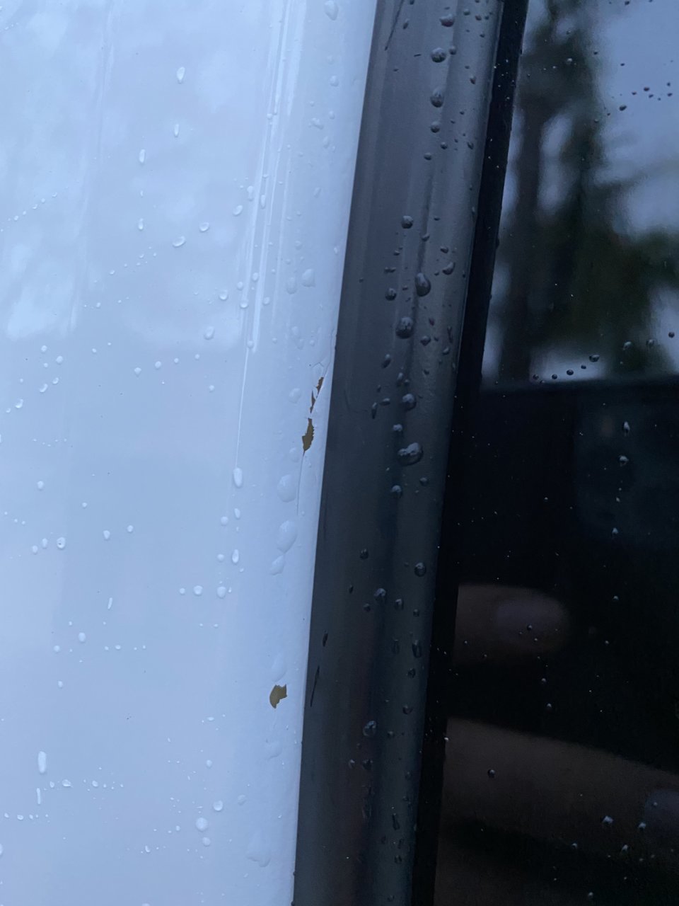

    My local dealership took on the repairs of the paint flaking off from the driver’s side. They did a decent job. The paint matches, but there is a little ripple at the right lighting. I’m not too worried about it at this point.DA4EA31F-9550-4135-B531-BE7355FD2B4F.jpg

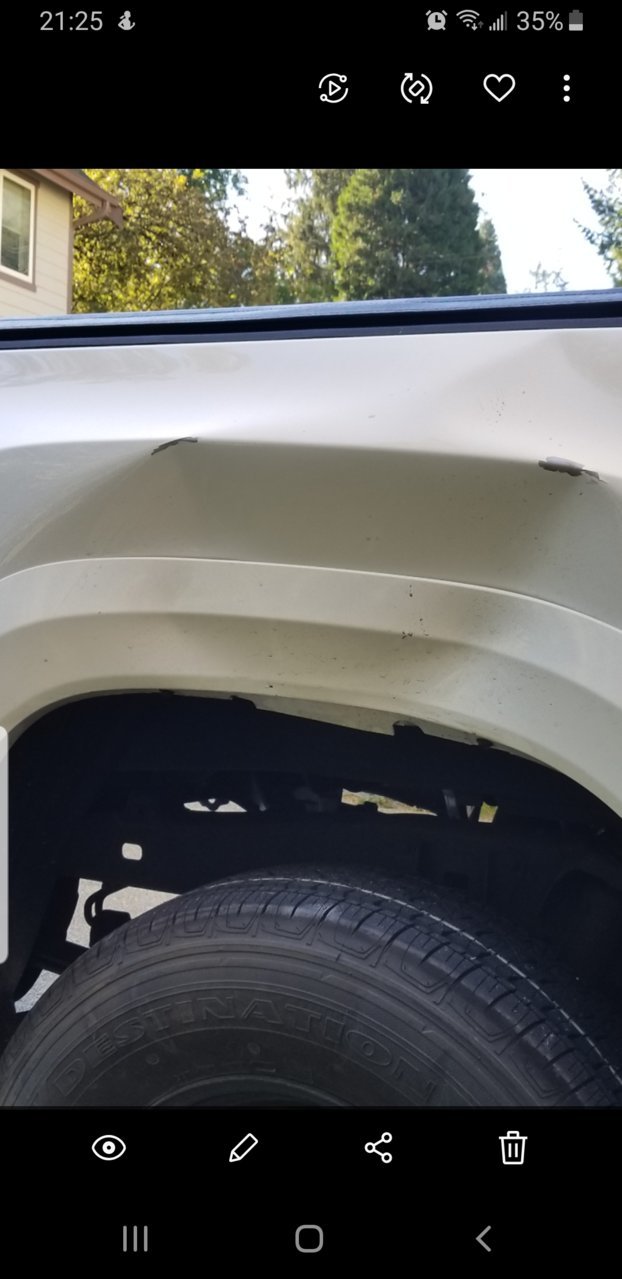

    Mine 2017 white and no paint issues. I have about 5 pretty small rock chips so far. The paint is tougher than my windshield.
    I bet the primer is ef'ed up.
    BTW, my truck has a grey color primer.

    Uuuummmm. Not sure what type of point you're trying to make by showing us your screwed up bedside. Yeah you might not have had paint issues but now that your bedside is bashed in by a foot you sure as hell do.

    Color of the primer...
    Folks with the paint issues have the same color of the primer as OP. ( see other threads on the same topic )

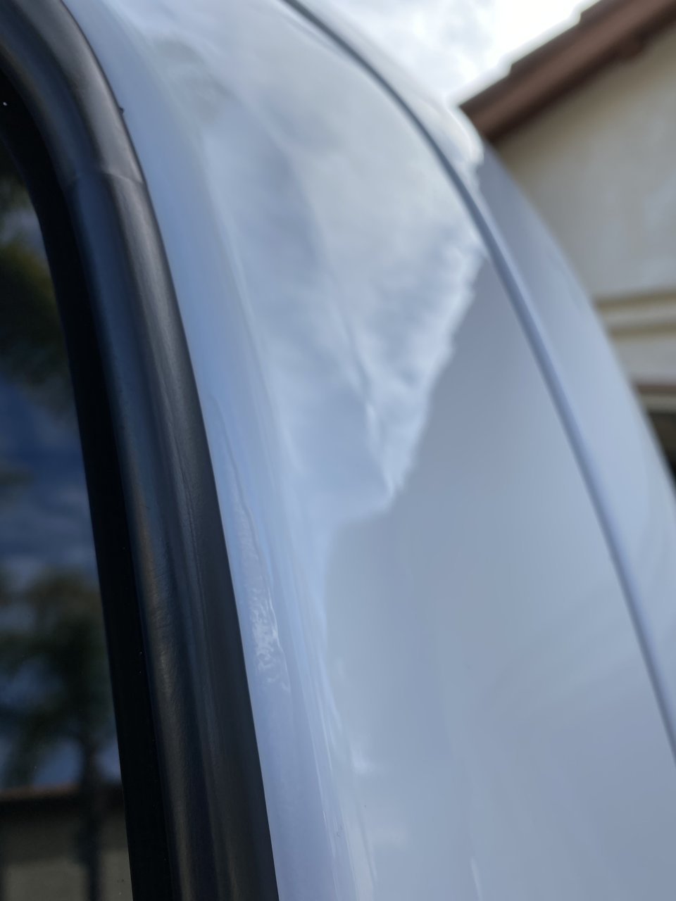

    2C4463F6-55AE-4A7D-825F-73BF4DB1E30C.jpg I just noticed the passenger side is starting to have the same problem :mad:
