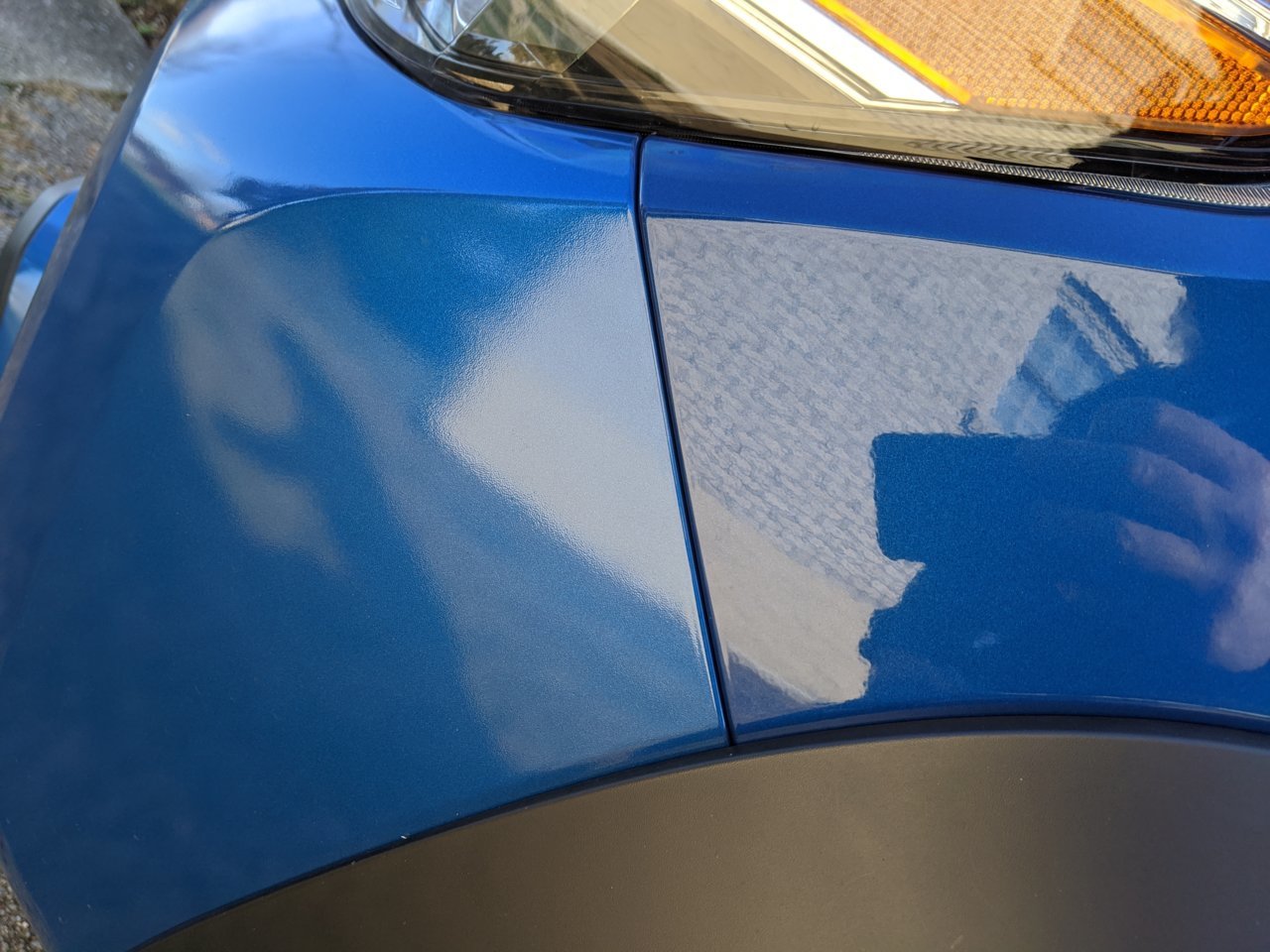

    I bought the truck new, and noticed a while after I got it that the paint on the fender doesn't really match the paint on the bumper. Is this pretty common because of it being metal vs plastic, or does it look like the bumper was replaced or repainted?IMG_20191127_143306.jpg

    That is some really heavy orange peel. Though the plastic base may be a contributing factor, the clear coat wasn't applied properly.
    It can be corrected with some wet sanding, compounding, and polishing, but that would be best done by a professional detailer or paint shop. Doing it properly will require the use of a paint meter to track how much clear coat is left as it is leveled.

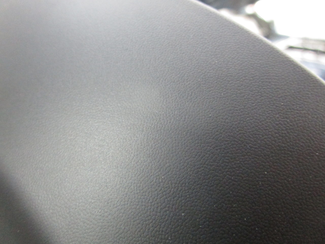

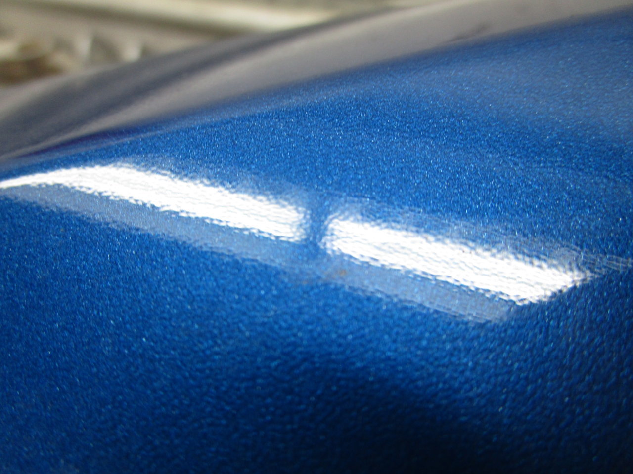

    The bumper cover and flares have a slight texture molded into the plastic. Here are a few photos of an unpainted flare and a painted flare from a job we did last week. This tends to make these parts less glossy. If your bumper was repainted you would entirely lose the textured appearance and the bumper would be as glossy as the fender.

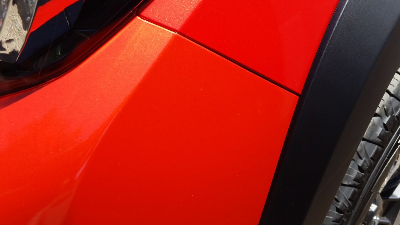

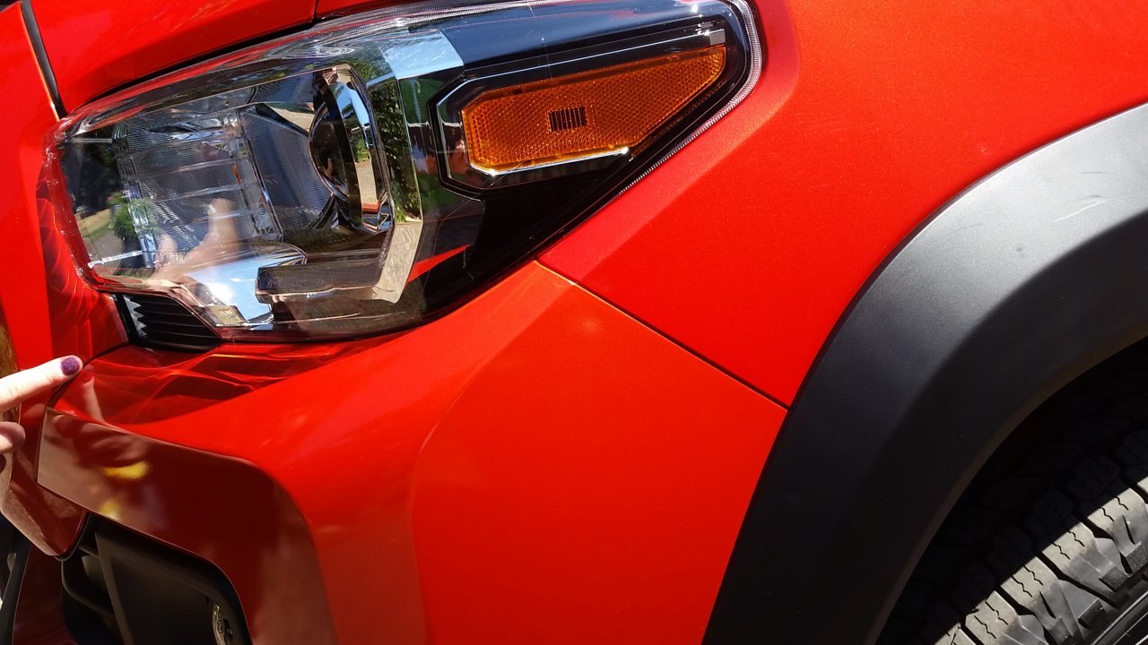

    That's normal. Go to the dealership and check out the different colors to compare. Some colors are worse that others but my Inferno shows a difference from the plastic painted surfaces compared to the metal painted surfaces. My buddy just bought a 2020 in Cement and his also shows a difference in color. Not saying it's right but it IS normal.
