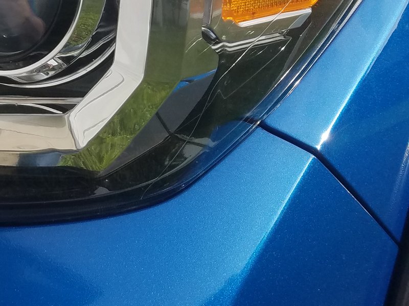

    The orange peel/texture looks normal but the paint matching looks off on your truck. My 2016 BBP doesn't have a transition that drastic, not saying that others don't though. I'd be a little pissed if I had a difference that drastic on a new vehicle.
    Bad photo as example but only one I had on hand with sunlight on it:

    Stop with the orange peel already, in that pic the body panel has it too. There isn’t Toyota on the lot doesn’t have orange peel.

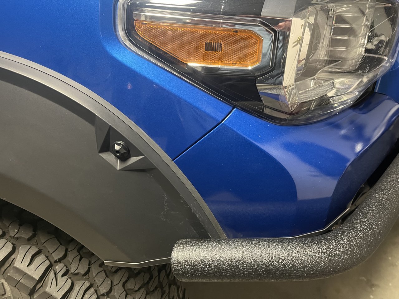

    This is the old blue, it that helps?
