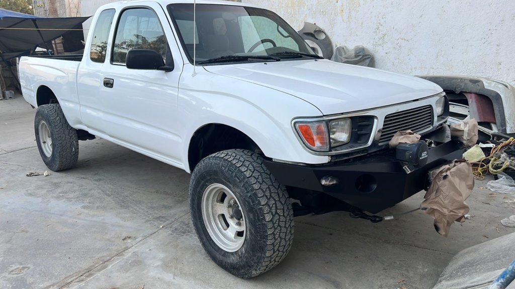

    Where in the US are you located... ~ $1500 in Tijuana, Mexico. No EPA paint either.

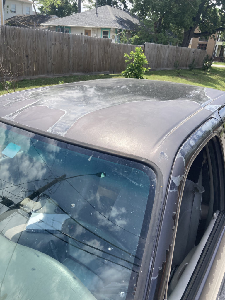

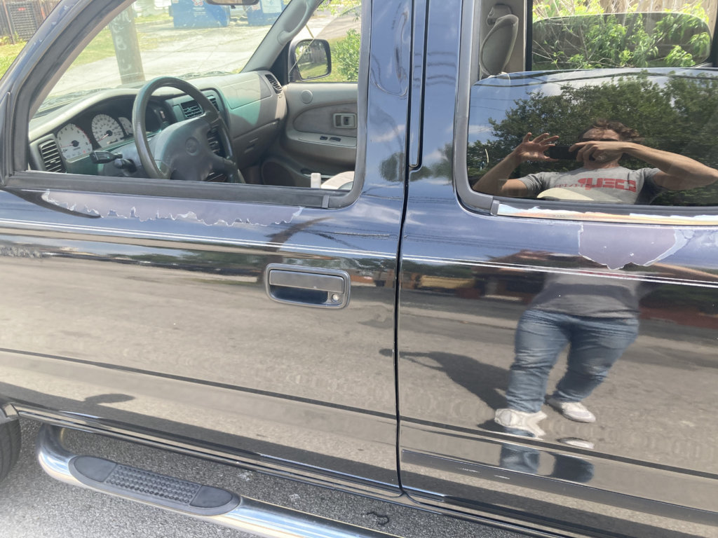

    Maybe try this… carefully remove as much clear coat as you can from the drivers door. Try plastic razor blades and maybe some wet sand paper. Follow that with some high quality clear coat. See what they have at auto zone or even better at an automotive paint shop. Maybe even Summit racing. After you finish the door, you will at least have some idea what to expect and what it took to achieve that particular result.
