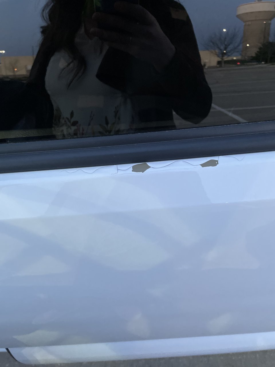

    My Tacoma has had the same issue. I called them just a few weeks out of my warranty and they wouldn't do anything for me. Dealer didnt and Toyota Customer department didnt after I submitted a case. I suppose I could have yelled at them, but you're really just yelling at a random customer service rep who just wants to work 8-5 and go home.
    Ive posted on my local FB group about starting a class-action lawsuit. If someone else does, I will gladly join.

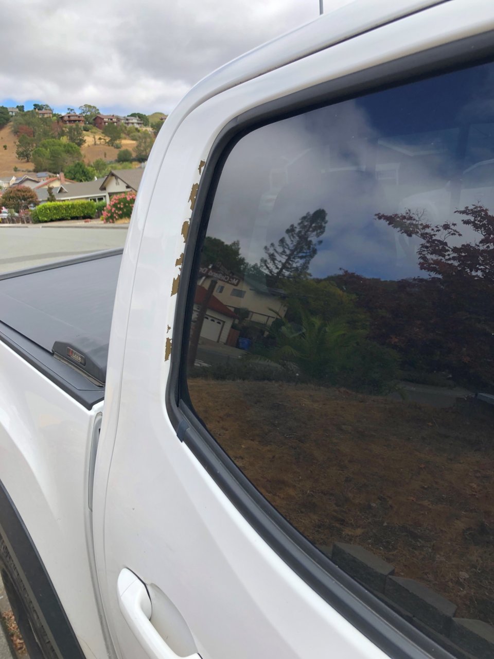

    Toyota fixed this issue on the drivers passenger door on a goodwill basis back in February 2020 (at 48,000 miles). In September 2021 I brought it into my dealer with 4 more areas and they got regional customer service to agree to repaint (at 60,000 miles). When it finally got to the body shop, last week, they found eleven (11) more places where the same flaking was happening. When this was brought up to regional customer service, they refused to add the new areas to the estimate and reneged on the original deal to repaint the first 4 areas I found.
    Needless to say, I was dumbfounded. I called Toyota at 800 331 4331. I was stonewalled. "Not covered, Out of Warranty, Not included in the current ZKG Customer Service Program"
    I have been a long time Toyota customer - at least 6 Corollas, a Camry, a Sienna, three Prius. Then the Tacoma. Given the estimates from the body shop to repaint, my truck is now worth only about half of its Blue Book.
    My dealer said to continue to call Toyota to complain. Anyone that has this issue with 040 Super White on a Tacoma should call. Toyota needs to see complaints to pile up in their database so it becomes obvious to them that they have a ton of unhappy customers that will buy elsewhere in the future if they continue to be treated secondarily compared to owners of Corollas, Camrys, 4 Runners, Avalons, GX470's, RAV4's, Scion xB's. Those owners are being treated fairly over this matter.
    I am only uploading one pic. No need to see all 16.
    If you are affected, call Toyota Customer Service and complain so we can make this right for all owners with this problem.

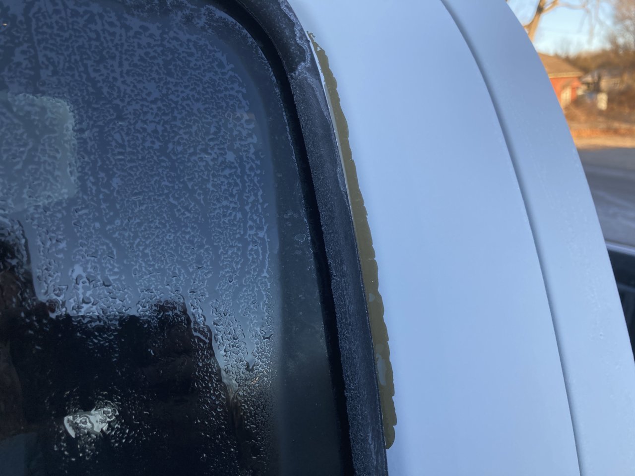

    Called the Corporate line and they didn't want to do anything for me until I pushed them-- mentioned this forum and how many folks were dealing with the same issue. Then they finally said I could file a claim if I provided an estimate to fix the damaged area. What's precarious about this is that it seems like we all have the paint peeling in the same location.
    This really should be a class action suit. It's clearly a manufacturing error. The way Toyota tries to dodge doing right by its customers is the part that irritates me. I've only bought Toyota vehicles. If they don't fix this I'll never buy a Toyota again.
    This is a photo of the rear door on the driver side of my 2017 four door Tacoma TRD Off Road
    See image below.
