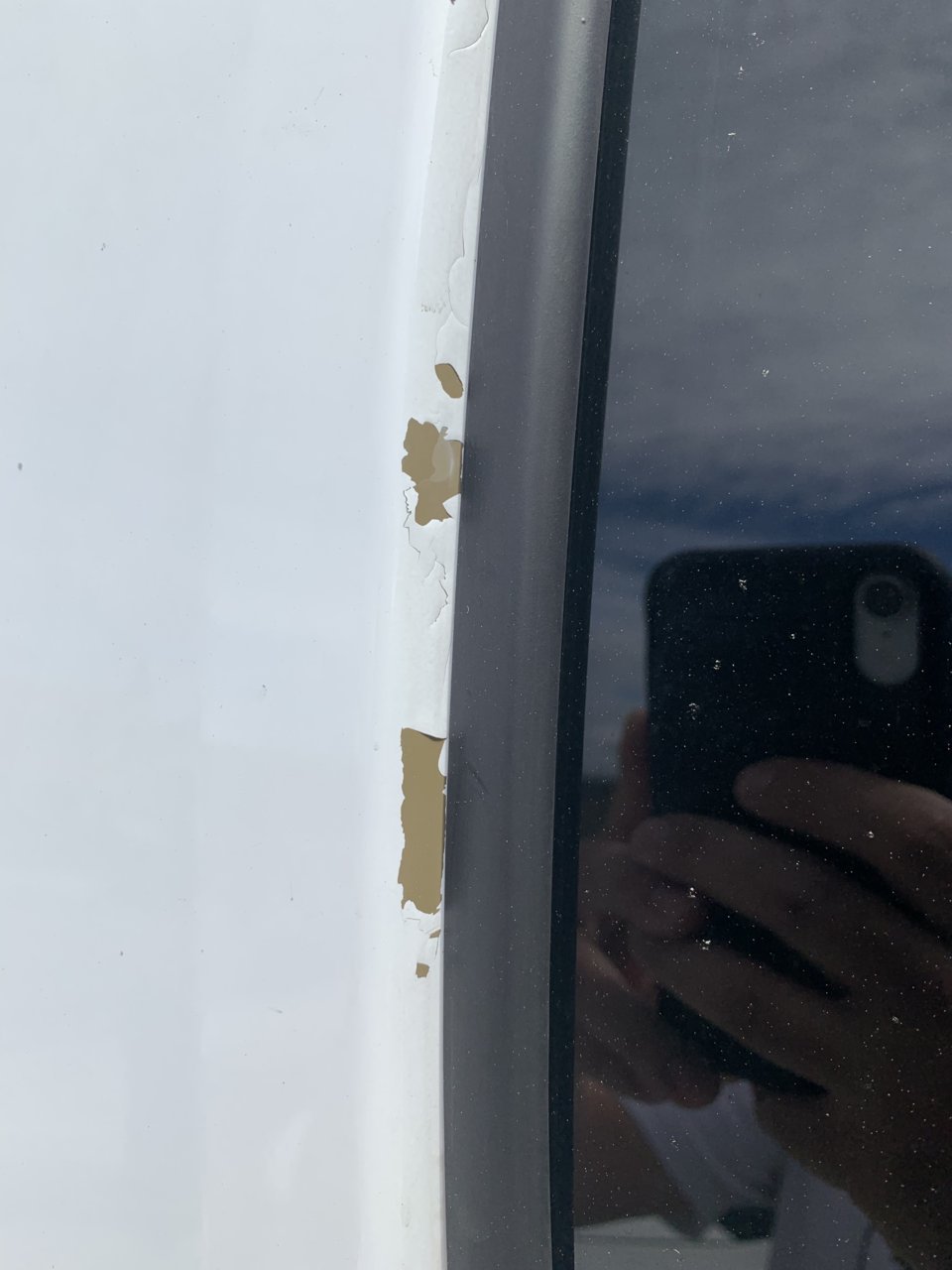

    Just fyi to taco brothers that don’t know yet. My 2017 Taco paint is pealing on both rear doors and getting worse by the day next to the window. Good thing is Toyota is aware of it and is a recall but a new recall that has not been sent out yet to Taco owners. If u enter ur vin# on there website it won’t show up because it’s not approved yet but will be soon according to Toyota. Check ur paint!

    Had inspection today at Toyota. Was approved but still has to be approved by Corporate. But what makes me mad, they only approved to paint the two rear doors. Do u guys think it will be noticeable having two doors freshly painted? I’m going to be pist if it doesn’t match Toyota is slowly losing there good name for building solid vehicle's. New Toyota’s are falling apart like a damn Ford.

    Im no paint expert but wouldn’t u think if it’s peeling in two areas on opposite sides of the truck, the entire truck has a shoty paint job. Wouldn’t u want ur entire truck repainted after paying $40K for a truck?

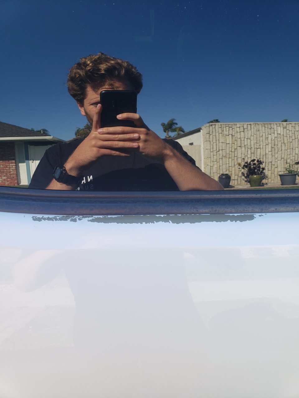

    I just bought a 2014 super white Taco and have peeling on a couple of my doors. Do you know if I will be covered since I am not the original owner and no longer under warranty?

    you just answered your own question.
    because if you were, you would know that this is an adhesion issue that only affects the leading edges on white(040) colors which Toyota to this day shoots as a single stage application from the factory.
    You get a high speed impact like a rock chip, and the surrounding area starts to lift and delaminates from the ED coat.
    this is a well known and well documented issue with multiple Toyota models, across broad year ranges of white vehicles.
    For a half decent painter, solid white is the easiest color to match, and can be panel painted without requiring any blending to adjacent panels, so you will get what you deserve and have only the affected panels repainted.
    This will never happen on your tailgate, so re- painting the entire vehicle becauae you think they should is not a logical reason.
