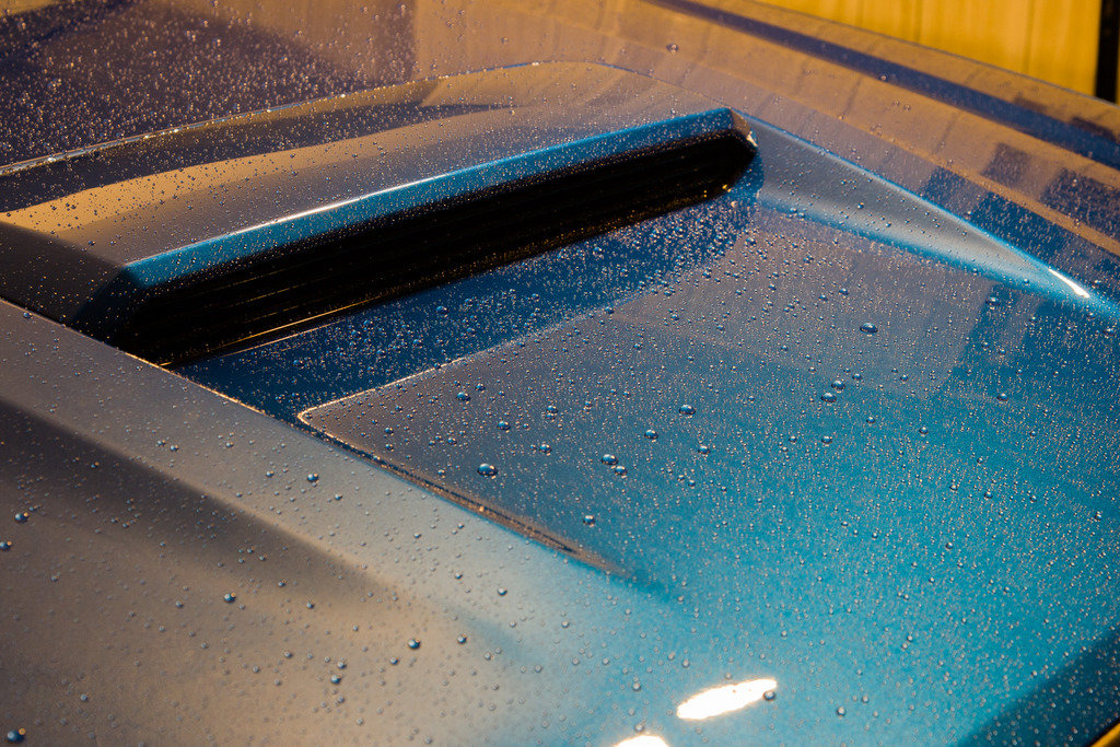

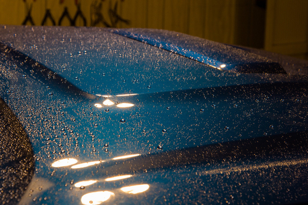

    here is how Carpro Hydro2 beads. I stopped using waxes years ago. Sonax Polymer net shield, coatings and things like Hydro2 are far superior in the hydrophobics and durability

    Awesome. Yeah, I'm a convert too. I just did Duragloss 111 plus the 601 bonding agent and the gloss/shine is insane! I've been curious about the Sonax PNS. Heard its good stuff.

    Is the hydro the stuff you spray on and just rinse off with water? Hard for me to believe that's enough to to make it stick! But clearly, it works.
