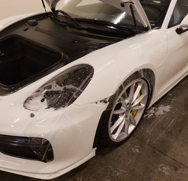

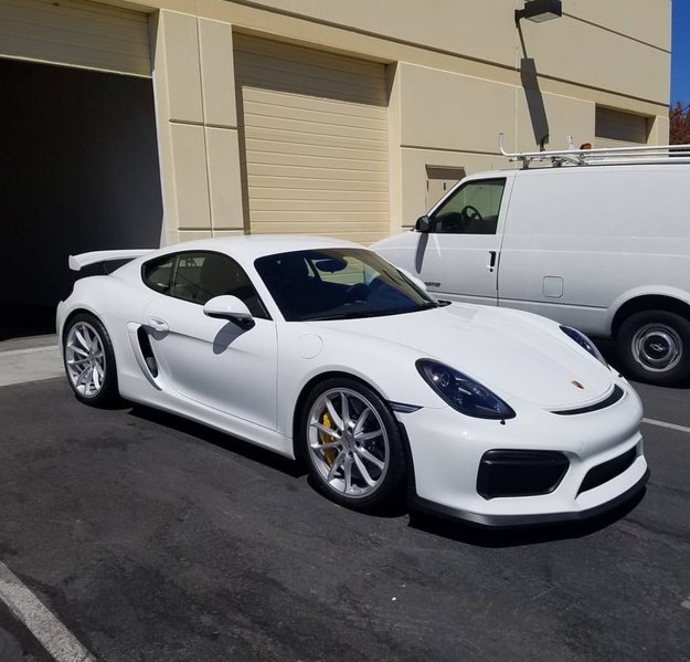

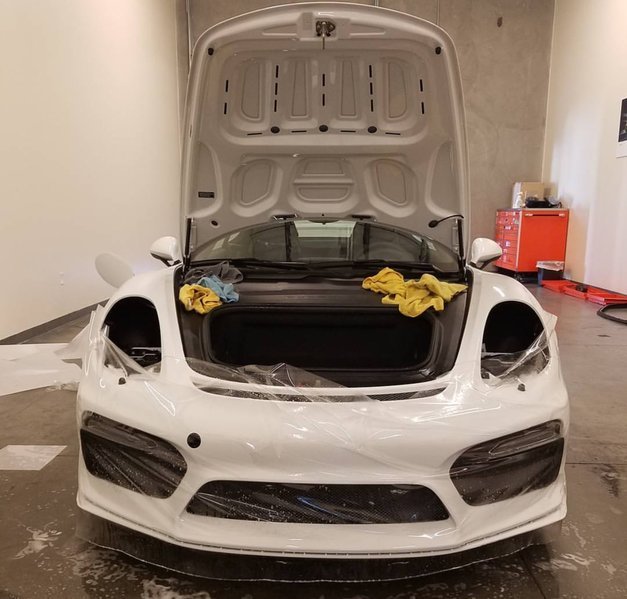

    I had my gt4 wrapped in Xpel ultimate.. Now if the protectant wrapped they used is a good quality one it won't mess up your paint and the film will not turn yellow. As far as the bubbles and creases, the air bubbles may come out once the wrap has some time to be in the sun and cure. If the bubbles don't come out take it back to the dealership and have them re do it again. Tell them your not happy with the way it came out. Usually the shops that do the paint protectant wraps for the dealerships just hurry through the job and don't take the time to actually lay the warp down right... It's good to go to a reputable shop to have something like this done.. But keep a eye on it. But I would take it back and make them do it again if your not happy.
