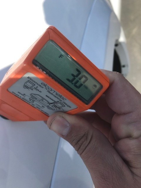

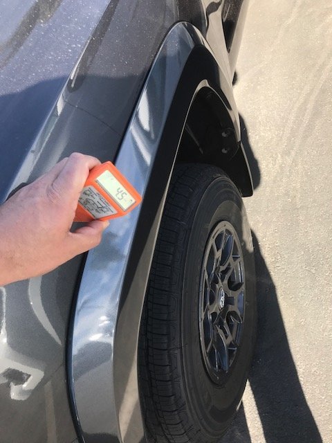

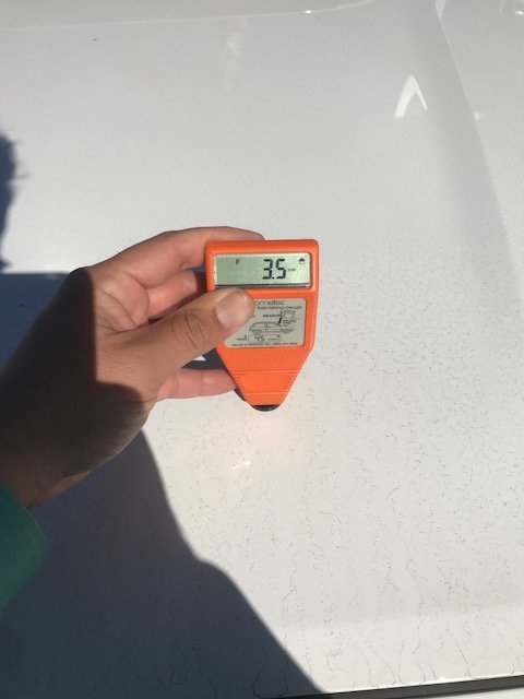

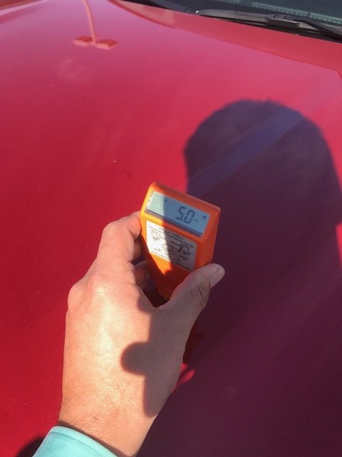

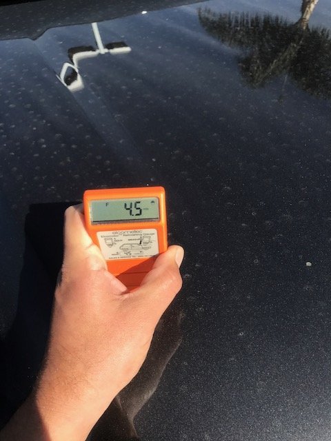

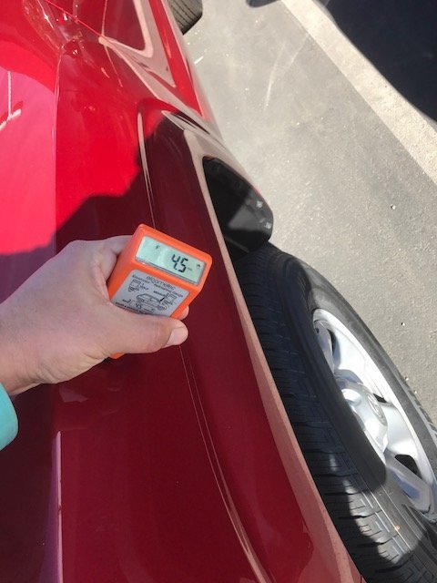

    I know the 040 has clear coat, the general online consensus is that its an integrated clear coat though, which means the 040 paint is thinner than the other metallic and pearl paints. There doesn't seem to be a definitive answer but there are several threads on various forums where people have posted letters from Toyota reps saying exactly that.
    Not saying you're wrong as you seem to know more about paint than I do, but I did find this interesting... Have a Toyota store right next door to my Honda dealer so I grabbed a paint meter and found this:
    Super White fender/hood:
    Metallic Gray fender/hood:
    Barcelon red fender/hood:
    All the metallic paints varied between 4.0-5.0 while the super whites consistently read 3.0-4.0... which is consistent with the general online consensus that the super white is single stage and thinner....
    This isn't definitive proof as I only measured about 10 tacomas and there are other variables... but I did find this interesting and seems to support the idea the super white IS thinner.
    Maybe its just a coincidence or theres another explanation?? Maybe the metallic paints give different readings because of their material and are not necessarily thinner or something??
    Edit: just asked the bodyshop manager and he seemed to agree with you, said the super white is TWO stage, but said the pearl whites and THREE stage which would make them thicker. He seemed to think the metallic paints are two stage just like the super white but he didn't seem confident in that answer and when we paint metered a few and saw the super white is thinner he didn't really know why :notsure:
    This may be one of those things where we'll never have a REAL answer
