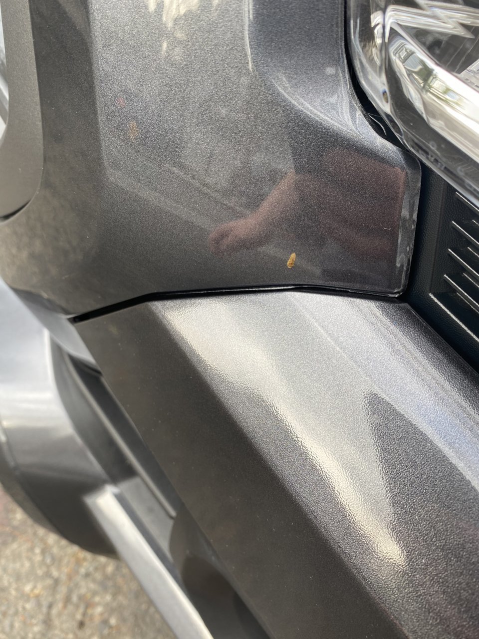

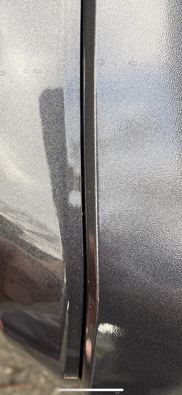

    Just picked up a 2021 sport and looking over the paint the bumpers and fenders appear to be quite a bit different. There’s a def orange peel look and less clear coat it appears on the bumpers and fender flares. Is this normal for the Tacoma’s? Thank you

    Very similar to mine, although yours seems more pronounced. That’s just how they are it seems. Bumpers and sheet metal use different paints, more flex additive

    Different materials being painted. The plastic bumper seems to have a slight texture which will obviously differ from the metal sheet metal/body.
    Normal imo

    I appreciate it guys. I assumed this was the case and not some gross abnormality on their painting job. I appreciate the input

    Just went to my local dealer and looked on the lot and all of the Tacomas and other vehicles looked like that. This is a diff dealer than I bought from. Appreciate all the help

    Painter here. Bumpers have texture that’s what’s Telegraphing through finish. Normal

    The lower panels of the doors and fender that appear to be orange peel is because it is suppose to be more abrasive resistant. It to provide some protection against slinging rocks from your tires when off roading, to avoid paint chips and such.
    Edit: It is very pronounced on my Taco

    Rocker texture down low. Chip guard etc.

    cause tacomas have one size fits all flares and bumpers. they are all textured.

    You can polish with a little compound and polish then wax would look a little better if it bothers you but as stated above the bumpers have texture

    different materials take paint differently apparently. My flares look a little different then the rest of the paint on my truck

    the actual plastic on the bumpers have a little texture

    Normal. Can't say for the fender flares since mine aren't painted, but my front bumper appears textured. It's plastic though and I kind of figured it was done by design.

    I believe what you're referring to on the side panels is actually a 3M material below the paint. The 4Runner also has it.
