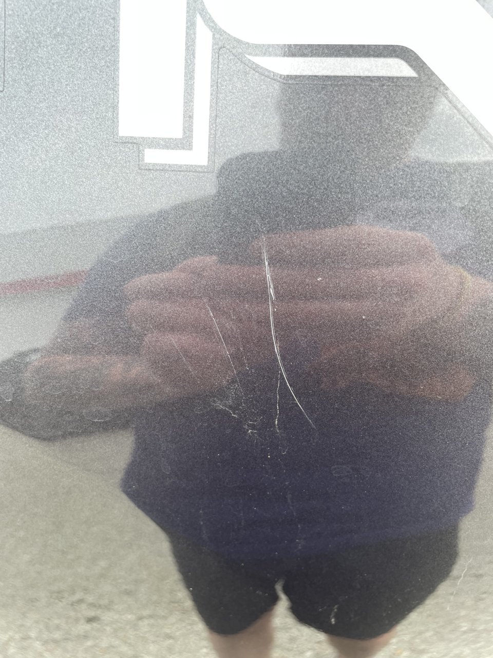

    Hello,
    I noticed this starch today on my 2021….
    Can someone give me advice on how to fix this? Touch up pen?
    Thanks,
    Zach

    It appears a bit deep scratch but check Chrisfix on YouTube.

    Did the scratch go through the paint? It appears the scratch is on the clear coat.

    Highly recommend NOT using a touch up pen. I bought a higher-end scratch fix kit from autozone the week after I bought the truck because my wife’s fkn wedding ring put a 3 inch scratch on my passenger side front door. I followed the directions to the letter and put some wax/polish over it and you can just barely tell where it’s at only if I pointed it out to ya.
    your scratches look super shallow like mine did. I’m betting a good scratch kit will do ya well. I paid like $20 if I remember right. Good luck brotha

    Can you feel the scratch with your finger nail? If you can then there's not much you can do. If you can't then a good polish will clear it right up.

    I would start with a light cleaner or polish compound before something more harsh.
