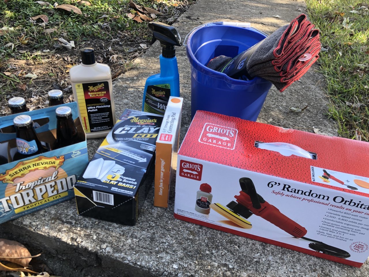

    This what I went with guys. Thanks for all of the help!!!! I’m going to try skipping the compound for now. I couldn’t find an iron remover locally so unfortunately I will be skipping that step this time. I plan to do this again in the Spring and I will order an iron remover prior to starting.

    Sweet. You will be okay without the iron remover. Unless something crazy happens, you shouldn’t have to do this in the spring or at least not a complete paint correction.
    Remember take your time and more importantly have fun!

    I see you got the IPA covered.

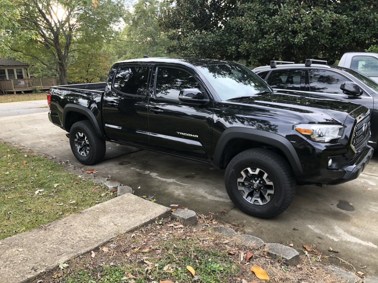

    I haven’t started polishing yet, but I did foam spray, 2 bucket wash, and clay bar. I plan to polish in the am. The forecast is calling for light rain almost the entire day tomorrow. Is it ok to polish in light rain?

    If rain drops are hitting the section you're polishing then it's just going to water down the cut/polish ability. If it's more than a few drops per 2x2' section probably best to hold off.
    Truck looks good by the way, from this picture and distance, you can't see a single blemish. Do a test spot on a rear door and see if you're happy with it before proceeding. Try to keep whatever you do there the same throughout the whole truck, don't rework that section multiple times. I found my paint to be the thinnest at the top of the bed. Basically where your TRD sticker is anywhere in that section along the top of bed. Though I have white paint on a 2016 which is supposed to be single stage. I've heard conflicting info on whether this is true for other colors, generally ones that do not have flake in it.

    Looks like all good stuff. How many pads did you get? Edit:I see the polisher came with a pad and also some nice all in one polish/wax, that's actually some good stuff. Good buy!
    I will try to find a really good article about the versatility of the M205 you got. You can cut and polish with it. It's good stuff, if I didn't get a crazy deal on a carpro bundle of clear cut and essence, I would still be using the 205 for most projects, I still use 205 a fair amount. Including this old Chevy, heres a few 50/50 shots, I was using M205 with 2 different techniques, an orange pad and that griots GG6 you have.

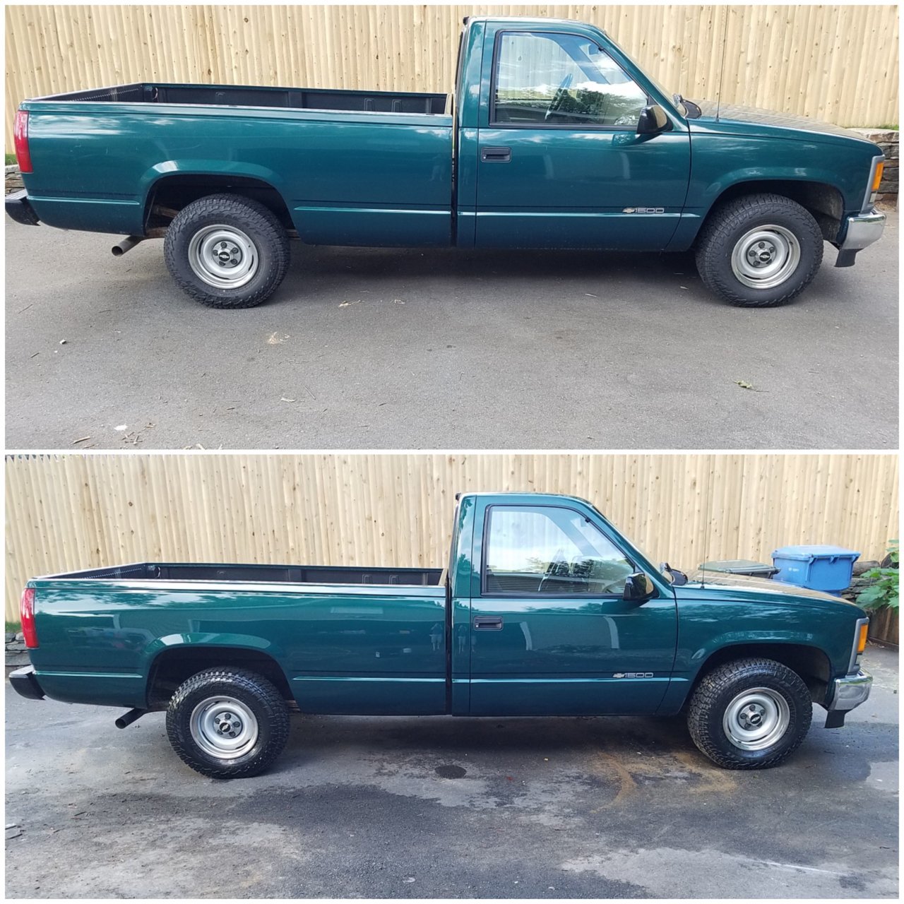

    your Chevy looks really good. It’s good to see how versatile Megs 205 is.

    What techniques did use for that finish?

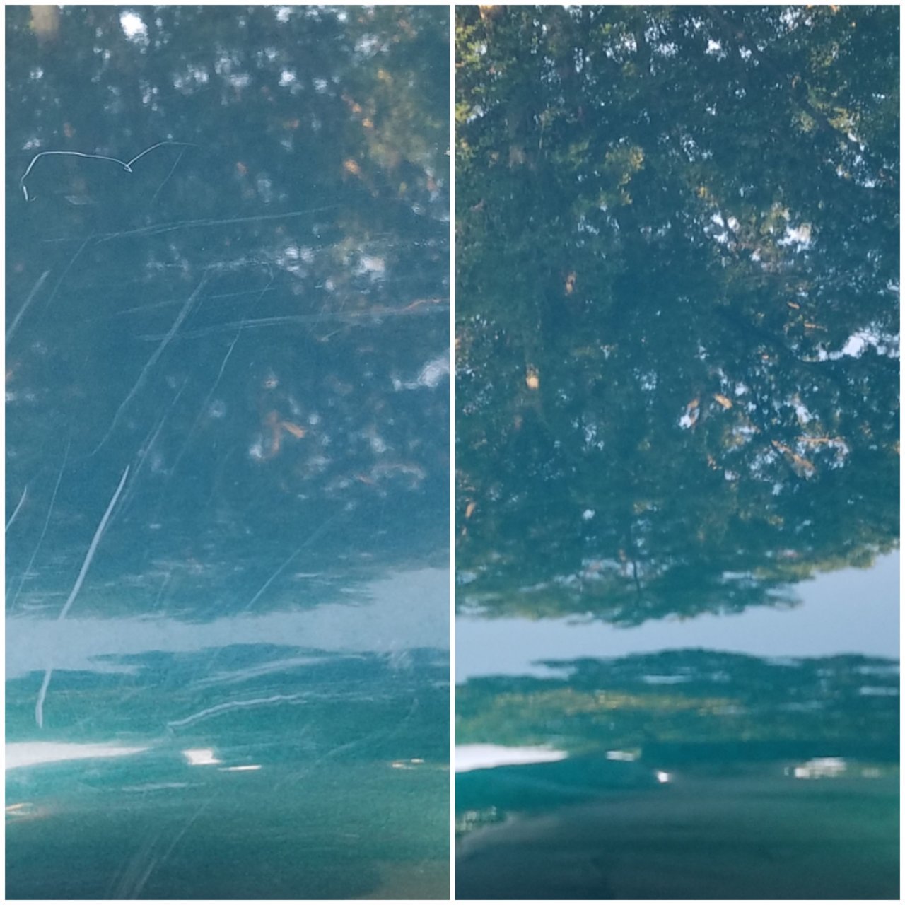

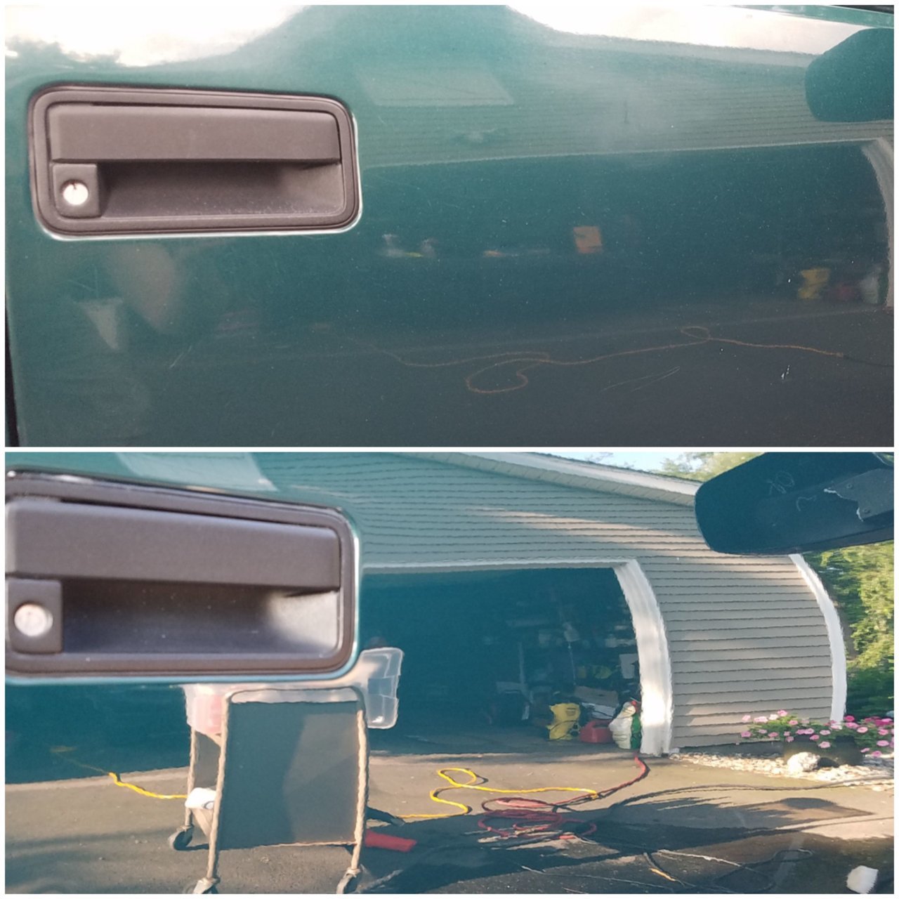

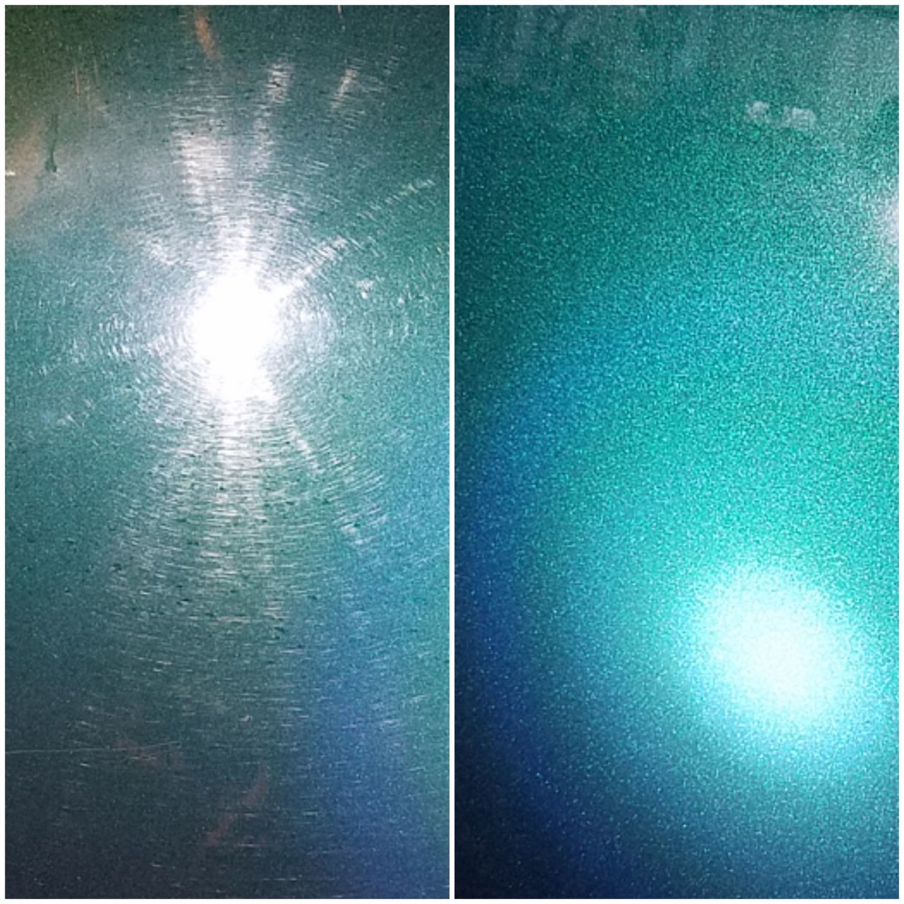

    The usual steps of foam wash, IronX, nanoskin clay mit, then wash again.
    I used my griots GG6 with megs M105 and M205 to buff out as much of the damage I could.
    For the deeper scratches, swirls, and heavy oxidation I used M105 with 5" LC yellow cutting pads and Megs 5" MF cutting discs. A few spots that were really bad but repairable I used a 5" wool cutting pad.
    Then I buffed out the whole truck with M205 on 5" LC orange pads and buff and shine urofiber pads. I used the technique that I linked a few posts back, lots of product on saturated pads. This gives the M205 more cut and really works well.
    Then I went over the whole truck again with some 5" LC black finishing pads. I used normal polishing techniques for this step.
    Once I had the paint finished to the best I could get it I wiped the while truck down with Carpro Eraser to make sure all the polishing oils were gone and the paint was ready for some protective layers.
    For a sealant I went with Jescar Powerlock with a 6" red pad. The powerlock was really nice to work with and added a lot of gloss and depth to the paint, I did 2 coats and waited about 12 hrs between coats.
    I'm sure I missed a few steps somewhere in there.
