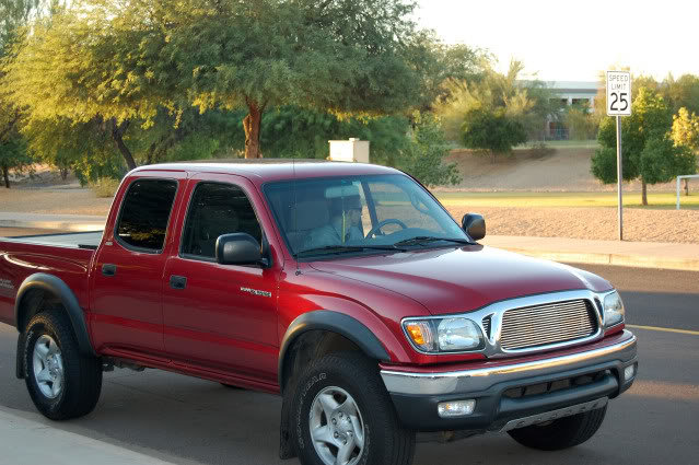

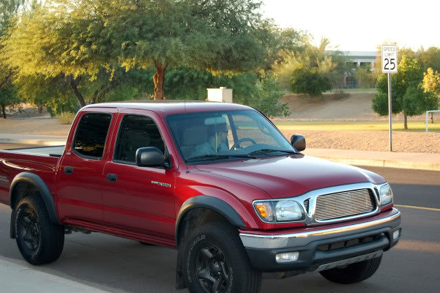

    Here is a picture of my 2003 tacoma with the rims unpainted
    And with the help of photoshop here are the rims painted black
    Yes or no? Opinions?
