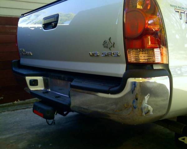

    I painted my bumper today with Dupli-Color Truck Bed coating. Badges are on the short list and I have some decals coming from SockMonkey.
    Before:
    After:

    I just sanded the bumper with 100 grit and used a degrease/dewax spray to clean it up.

    any more pics of your bumper after everything dried? Any streaks or noticable spots, i guess what i mean did everything go on even? Bout to do this mod next weekend. After sanding, did you use a primer then paint.

    I didn't have any streaks on it. It turned out well and was very even. Keep about 1 foot away when spraying and use multiple coats for evenness. It might be a good idea to take the rubber pads off (steps). I noticed it wasn't very complete close to the pad. I didn't have any cracking or peeling but the temperature here is pretty steady.
    For sanding it, get it as dull as you can and clean off any debris well. I didn't use a primer but it might make it stick better over the long run. Mine was only painted for about two months so I can't say how well it would have held up.
