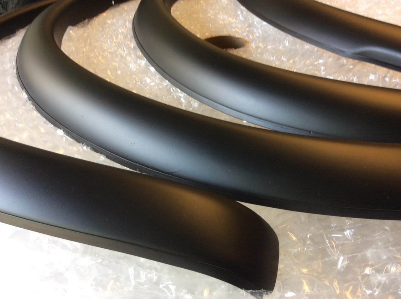

    Works on just about any surface. It’s all about prep work as mentioned above. Denatured alcohol to clean the surface, some fine sand paper for any deep gouges, and spray away. Plenti of other users around have done the same. Holds up better than expected too w/ road/trail debris.

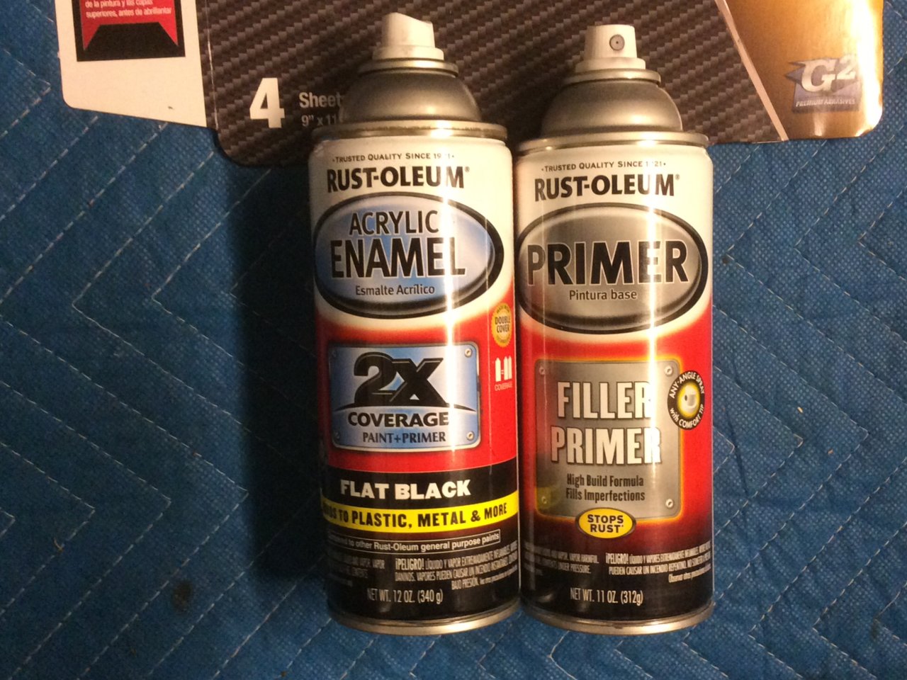

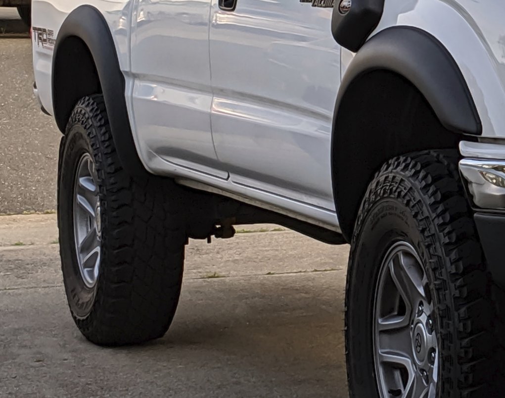

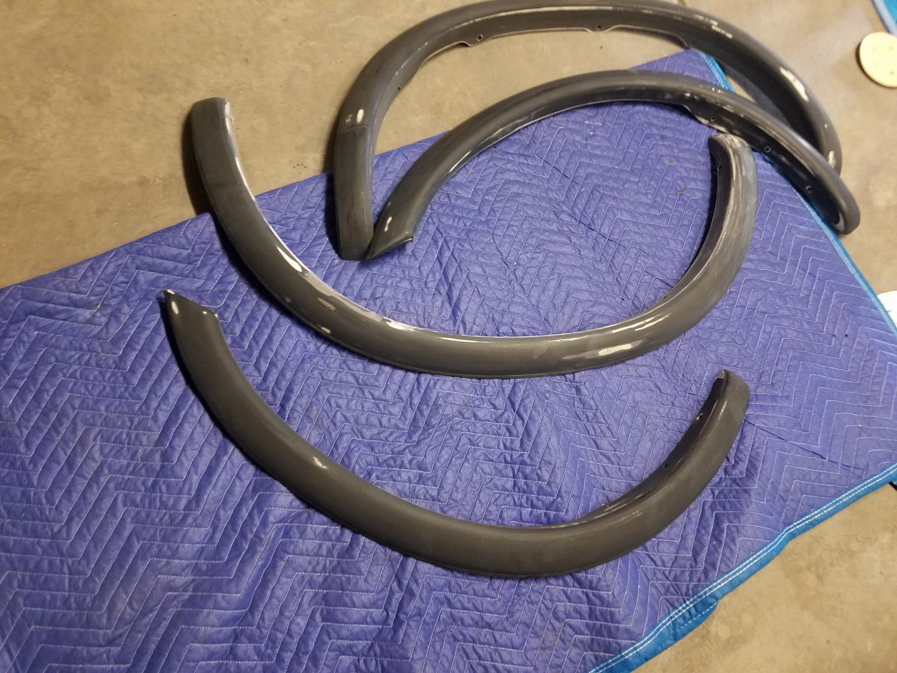

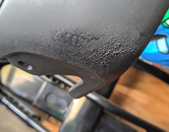

    As everyone mentioned, take your time and prep properly. Use a plastic friendly degreaser/wax remover and then a light sanding.
    I went with Dupli-Color's Premium Acrylic Enamel Flat Black. PAE102 I believe. Didn't bother taping anything on the flare (rubber seal) - just spray evenly light coats and then on the 4th or 5th a heavier coat.
    Did I mention prep-work? :anonymous:
    This is what happens when you don't properly prep -
    Satisfied with the end result -

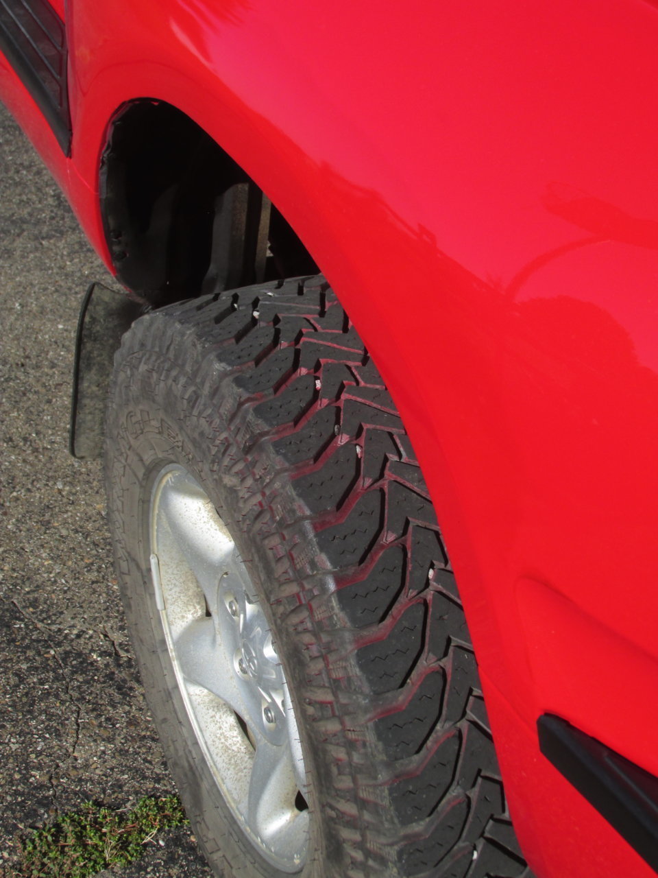

    I did the plastidip thing on mine. Took them off to sanded them down because the clear coat was peeling off (color match flairs). 4 or 5 coats of plastidip and it turned out okay. It's one of those 30 foot paint jobs... looks okay from 30 feet away. Get up close and there's a few spots that chipped off. But it's also seen a fair amount of texas pinstriping, so I'm pretty happy with it.
    When ever I end up doing it again, I'll just use something more permanent, maybe even a bedliner if I can get one with a smooth finish...
    Don't really have a closeup, but this was how they looked a while ago.

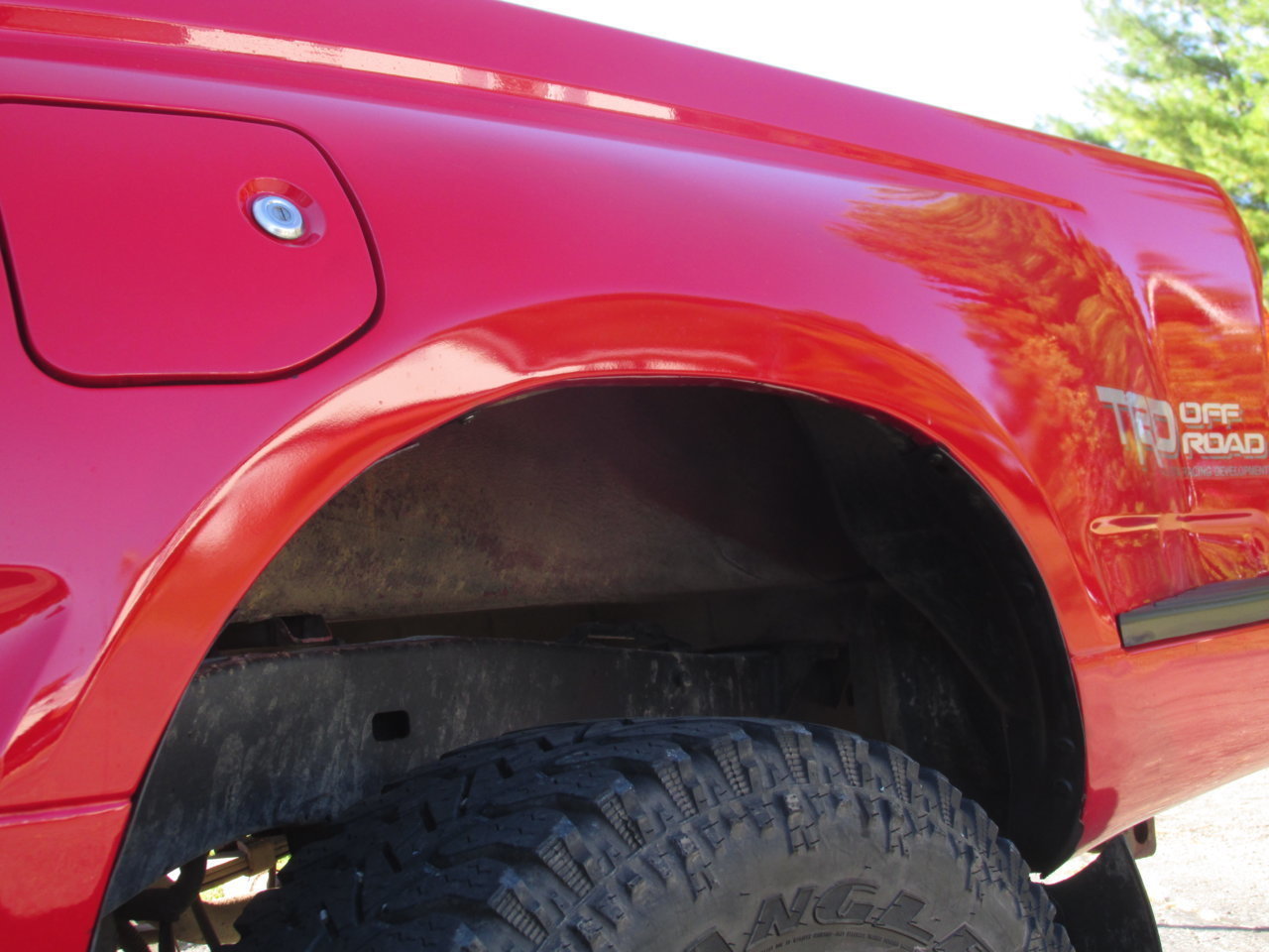

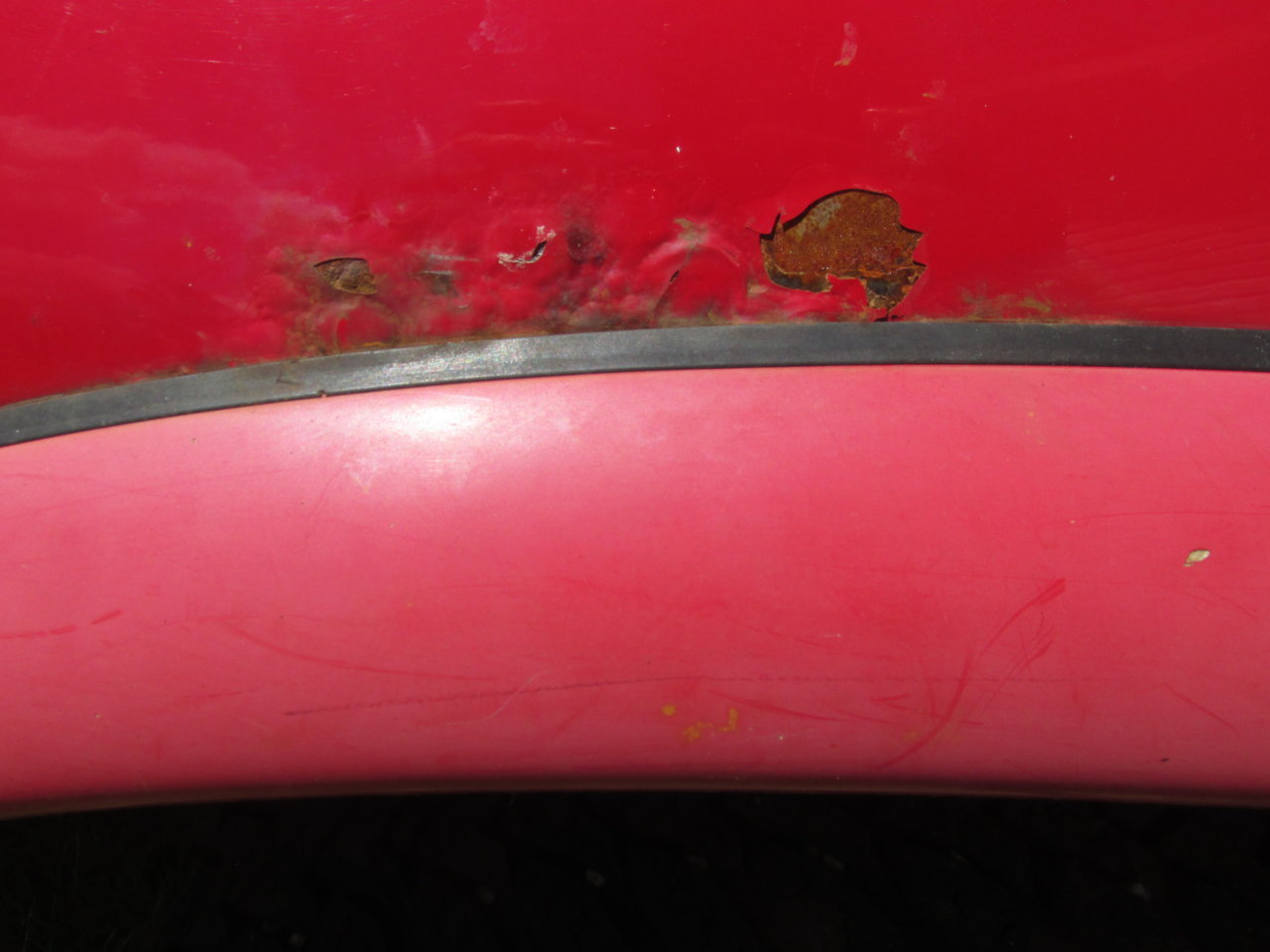

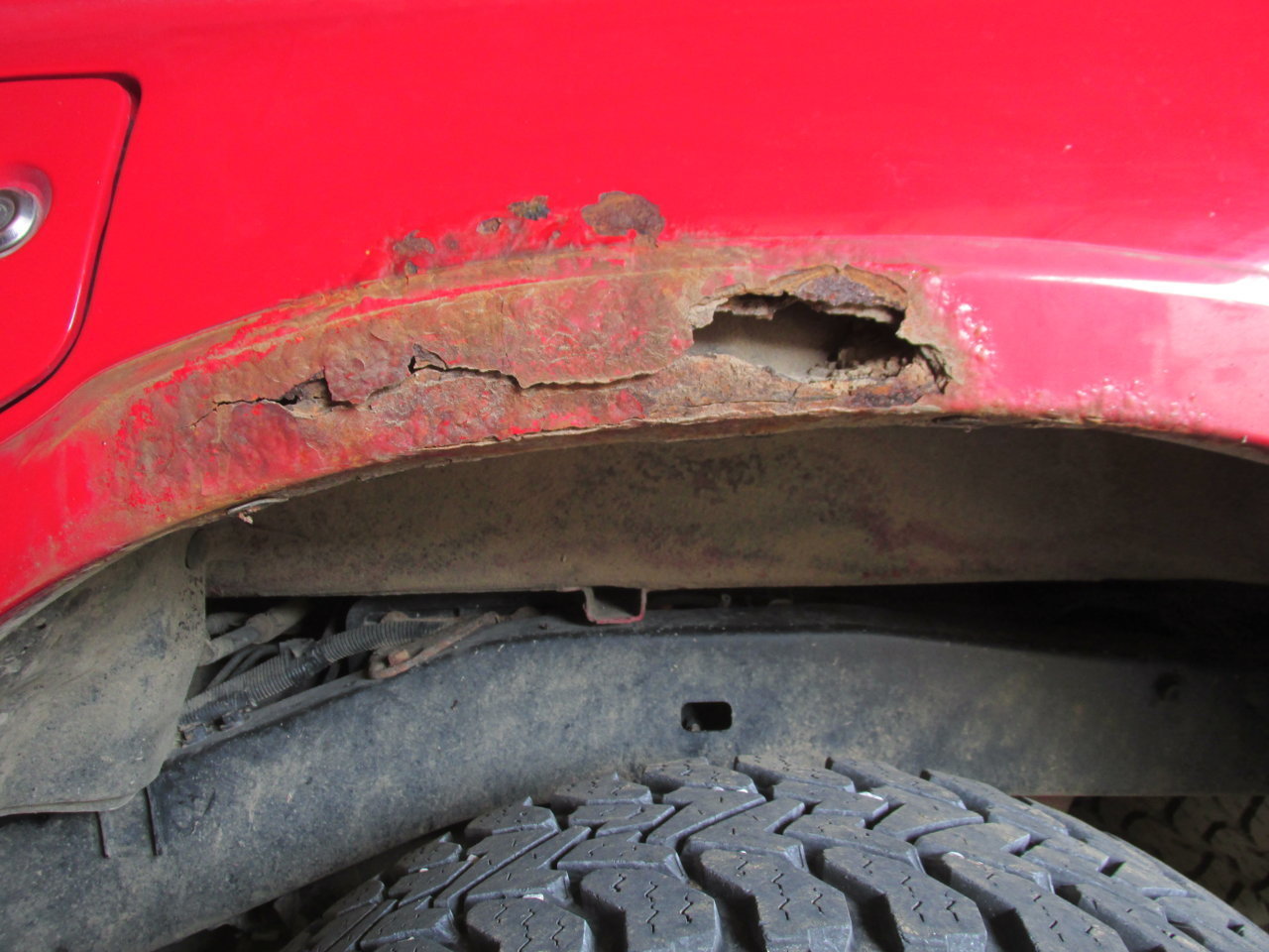

    I was going to either paint my faded flares black or get new ones. After finding what they were hiding, I decided not to put them back on. It was a nightmare, but the body shop did a great job welding and matching paint.IMG_5107.jpg IMG_7281.jpg IMG_7279.jpg IMG_8763.jpg IMG_8765.jpg
