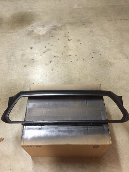

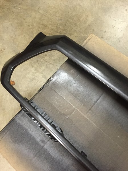

    Painting my front grille surround was my little project to start of the summer with my truck.
    With how impressed I am of the results, I have decided to share it with you all.
    I have just completed it and it's finishing its final drying stages and I'm letting it cure overnight before I put it on in the morning.
    Here's the steps I took:
    First I sanded the surface with 120 grit paper
    Next I cleaned the surface and preped it using prep solvent.
    Then I used dupli-color adhesive promoter(3 coats, followed directions)
    Next I put on 3 coats of dupli-color self-etching primer.
    Then I used the base color which I ordered off of here:
    http://www.automotivetouchup.com/spray_paint_clearcoat.aspx?gclid=CJaI653mm80CFYSAaQodXzYMpA
    I ordered the grey metallic color for my Tacoma and it matched PERFECTLY
    I also ordered the high gloss clear coat from here and added 4 coats of that the ensure a glossy look that matches the body.

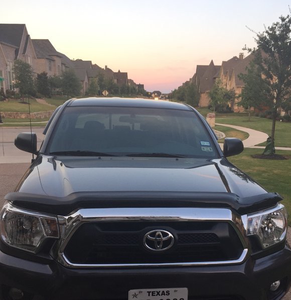

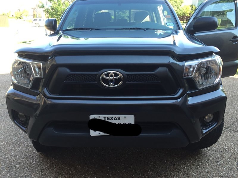

    Before:
    After:
    ManBeast, irish_11 and Gamble819[OP] like this.

    @Gamble819
    Nice work! Definitely looks OEM! The chrome grill on mine was cracked and glued (to keep the logo on) by the previous owner. So my replacement was not just a frivolous and narcissitic act, but one out of necessity too. I figured that since it needed to be replaced anyway and considering my strong dislike of chrome, the TRD would be best. :)
