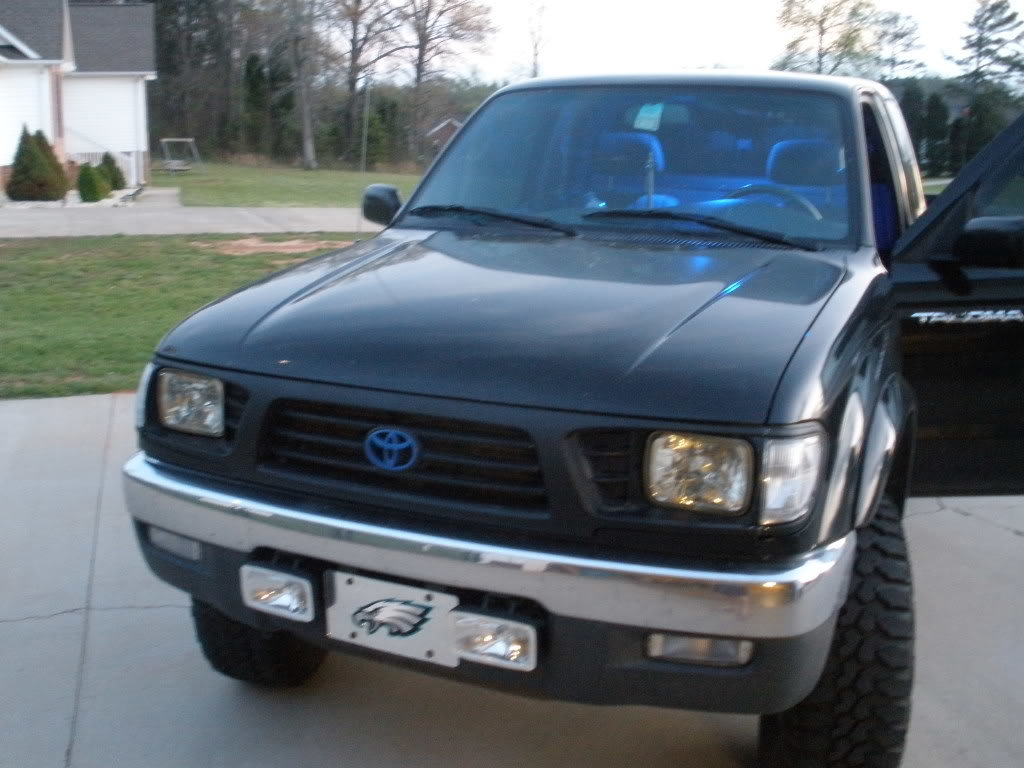

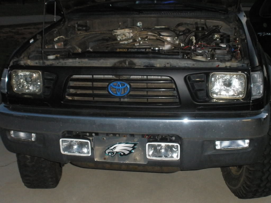

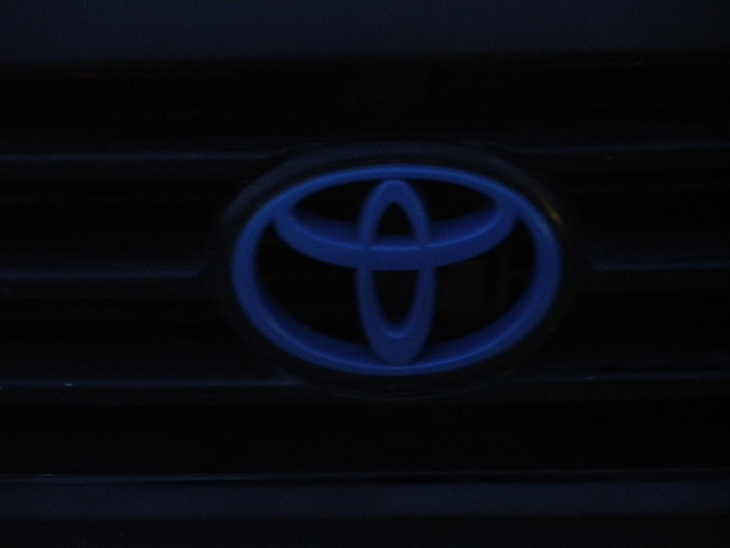

    Well i saw a bunch of guys on here doing it and said damn that looks good ill do it to my truck :D

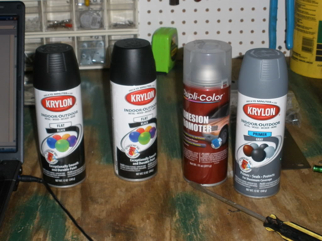

    The Supplies
    Tape Her Off
    Then Paint
    (I had some blue paint and i had the 48 led blue interior light so i painted the toyota emblem blue.)
    On Tuesday I am going to paint my bumper!

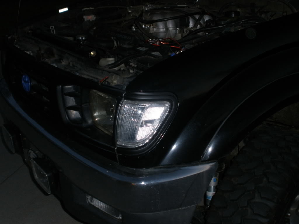

    looks great TJ!!! the trim on the corners looks good too!

    yeah there is a little place where i missed and you can see a little bit of the chrome but other than that it looks good

    it was easy
    1)sand the chrome
    2)tape everything off
    3)spray 4 coats of adhesive promoter
    4)spray 3 coats of primer
    5)spray 4 coats of paint
    let 3-4 mins to dry in between each coat
    easy as pie dude

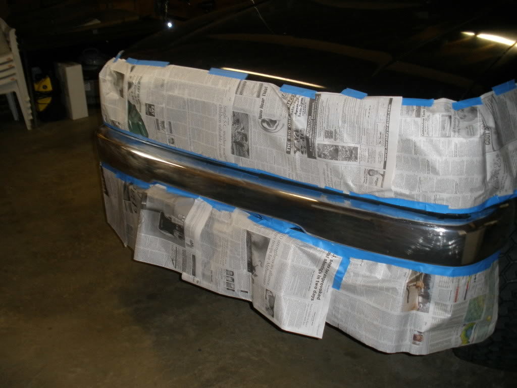

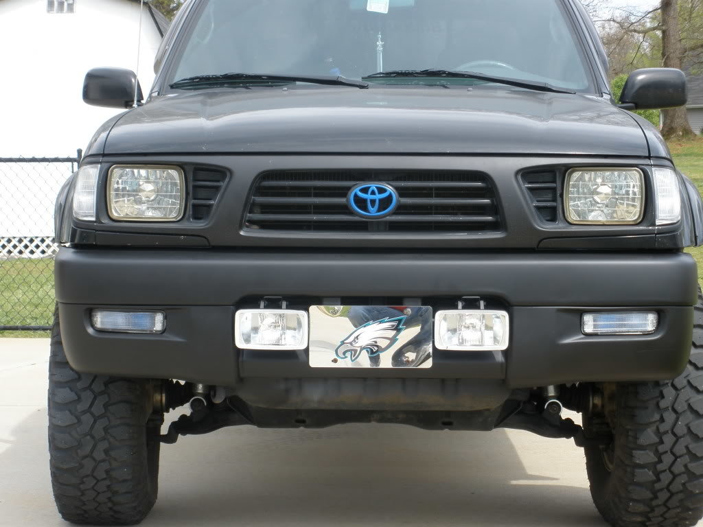

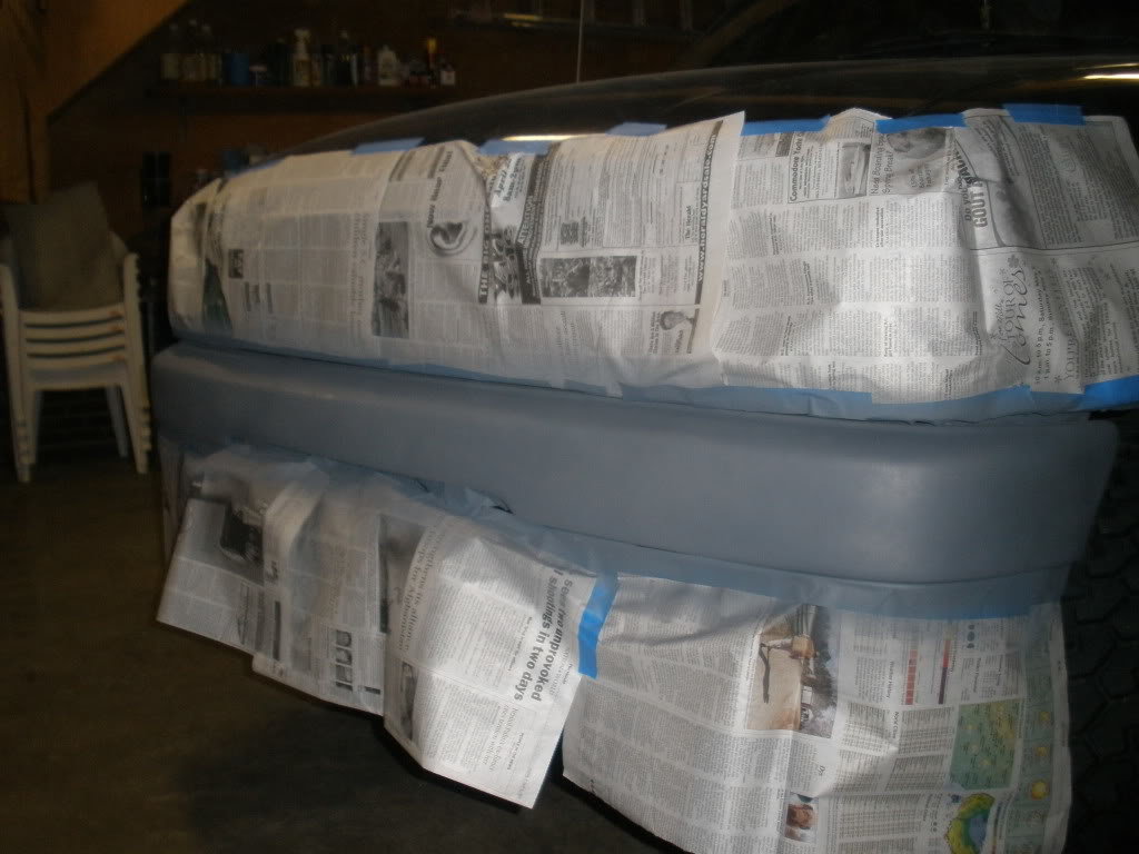

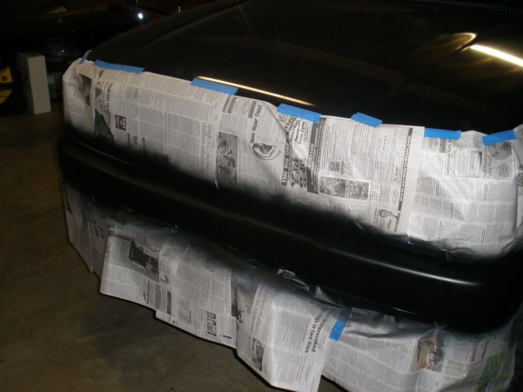

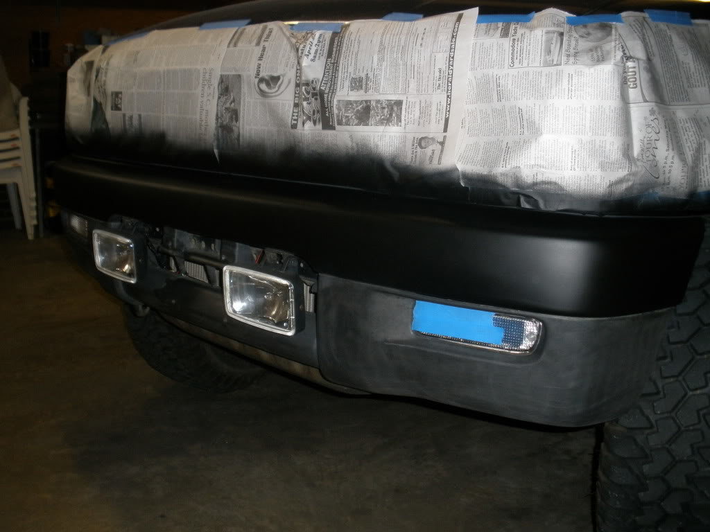

    well as said before i was going to paint the rest of my bumper and here it is :D
    Taped off
    Primer
    Paint
    Took the Bottom Paper off and realized that i need to paint the bottom portion also
    Finished Product
    And I Love It
