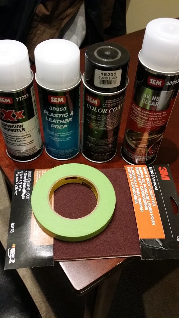

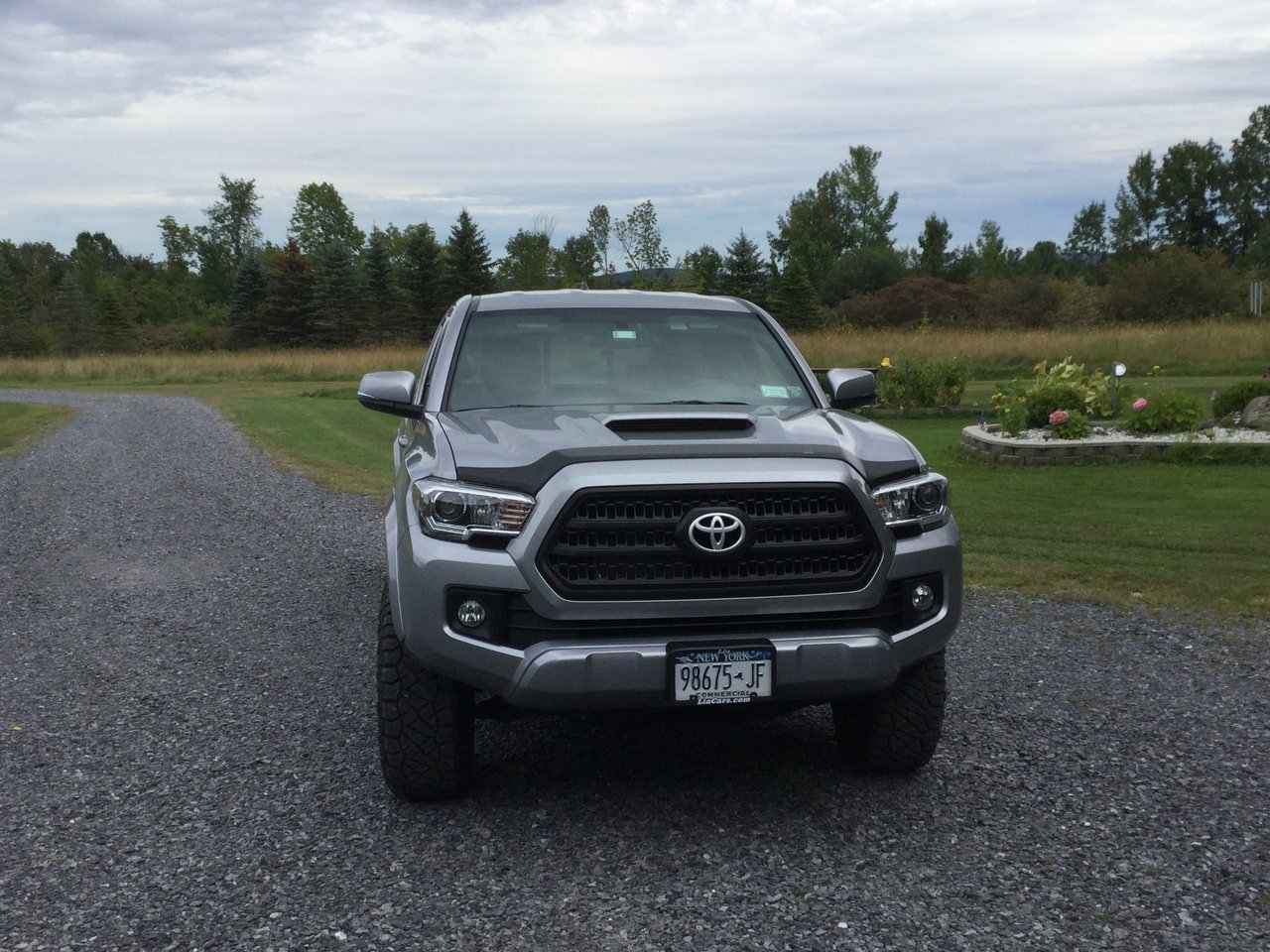

    all tore up already
    I went for more of a gloss look to match the rest of the truck since sport

    Wow.. I'm glad I asked. The grills look awesome. I'm super excited to get it done. Thanks for showing me the paint can too. That helps a lot.

    all tore up already
    Id like to take credit but all i did was call the sem paint help hotline and asked what in the heck would actually work on chromed abs plastic
