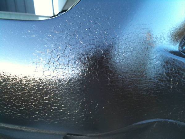

    Okay I am half way through this and something went wrong.
    I sanded the old paint to roughen it up, then primed no problem. first 2 coats of black no issue. I then let it dry 24 hrs, and thought I'd sand it and do 1 or 2 more top coats of black, then finish it off with a few coats of clear.
    But after sanding the black smooth to put on the top coat of black this happened!
    It peeled up on me!?!?!?!?!? What did I do wrong! and how do I fix it!
    I'm hoping it just got too hot on me. I'm letting it dry and will sand tomorrow, then I will let it get cooler and then try painting again. Such a piss off.
    Let me know if you guys can think of anything else!

    I'm not a paint and body man, but I'd lay odds that the first two coats of black were still "off gassing" the solvents when you put another two coats of paint over them.
    You should have done all the coats in succession, after the previous coat flashed off, so that the new coat would bind with it.
    If you couldn't do that, then you should have waited until the first coats completely dried, measured in weeks not days, and then sprayed your last two coats.
    What does the actual spray paint instructions say? It should tell you right on the can.

    Agent Smith,
    Thanks for the reply. The paint doesn't have instructions on it per say, it's a custom mix. I was going by my other can, which says re-coat after 15-30 min or after 24 hrs.
    I sanded it down again today and tried again, same thing. So I'm pretty sure it doesn't have anything to do with it being outside, my other project under the same conditions was fine. I used solvent (xylene and paint thinner) to remove all of the black paint. It basically wiped off to the primer.
    I'm gone for the weekend, but I think when I get back on sunday I will re-mask, re-prime, and re-paint all in one go and see if that works.
    I also just sprayed a small section with primer to see if that would wrinkle and it didn't. So at least that is good.
  13. Jul 30, 2013 at 1:05 PM
    #133
    Slesse
    Slesse Tacoma level 27
    Aug 19, 2010
    #41934
    208
    Kyle
    Port Coquitlam
    08 Tacoma
    Pro Comp Rims;32" Duratrack Tires; OME heavy duty lift in rear; 2" spacer lift in front; custom raised bed in box; Lear canopy; grillcraft grill; Rosen Head unit; Trail gear sliders; Tinted windows all around; Intermittent Wipers; White LED dash; Deactivated seat belt buzzer; Blue Sea Fuse panel; BAMF light bar running 4 Lightforce 170's (2 HID); FX-R retro HID's 4300k, with amber halo's, BHLM with black reflector bowl; stealth mode; Fenix Hide-a-way flashers as DTRL's; VIAIR OBA kit with 2.5 gal tank; 14" Magnaflow stainless steel cat back exhaust; de-badged; Hybrid badge applied; seasonal 4wheel camper "Fleet"
    So, I stripped the paint off back down to primer. Re-masked and re-primed, re-painted and laid down my top coat. So far so good. I let the primer sit for 1 hour before painting as per instructions. Then painted 3 coats black 15 min apart as per instructions. Then let that flash for 1 hour as per top coat instructions and laid down 5 coats of clear 5 in apart as per instructions, looks pretty good. I'm going to let that cure for a few months and then I'm going to polish it up nice and smooth.
    It's pretty smooth now even.
    Thanks for the help. TW to the rescue!

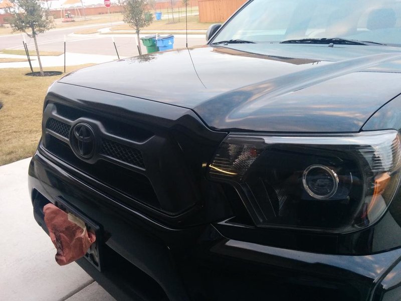

  16. Mar 19, 2015 at 5:45 PM
    #136
    itzyoboipaul
    itzyoboipaul Well-Known Member
    Jul 18, 2013
    #108518
    2,922
    Paul
    PFville, TX
    2020 TRD OR Cement
    Did mine today. Happy with the results
