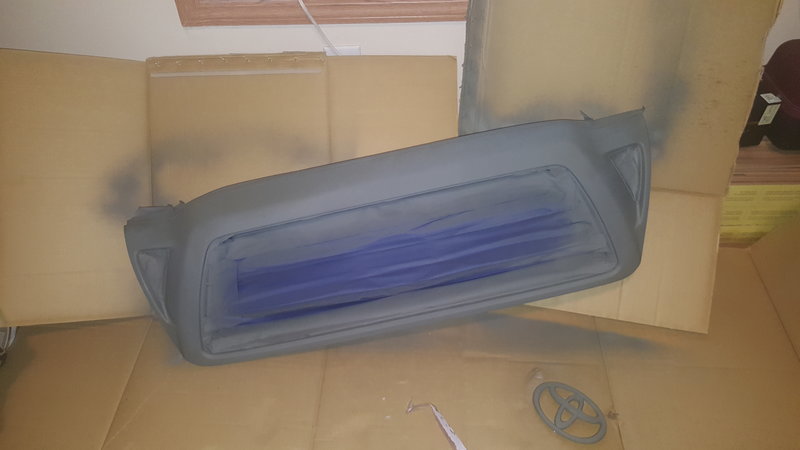

    does anyone else get to do this inside the house??? Rain here this week soooooo....
  6. Jun 22, 2017 at 3:29 PM
    #166
    99TacoDriver
    99TacoDriver Well-Known Member
    Jul 8, 2011
    #59531
    6,880
    South Louisiana
    OME 885x/5100s/LR UCA/3 leaf AAL/275/70/17 Terra Trac X-Venture
    :eek::eek:
    i probably would have waited

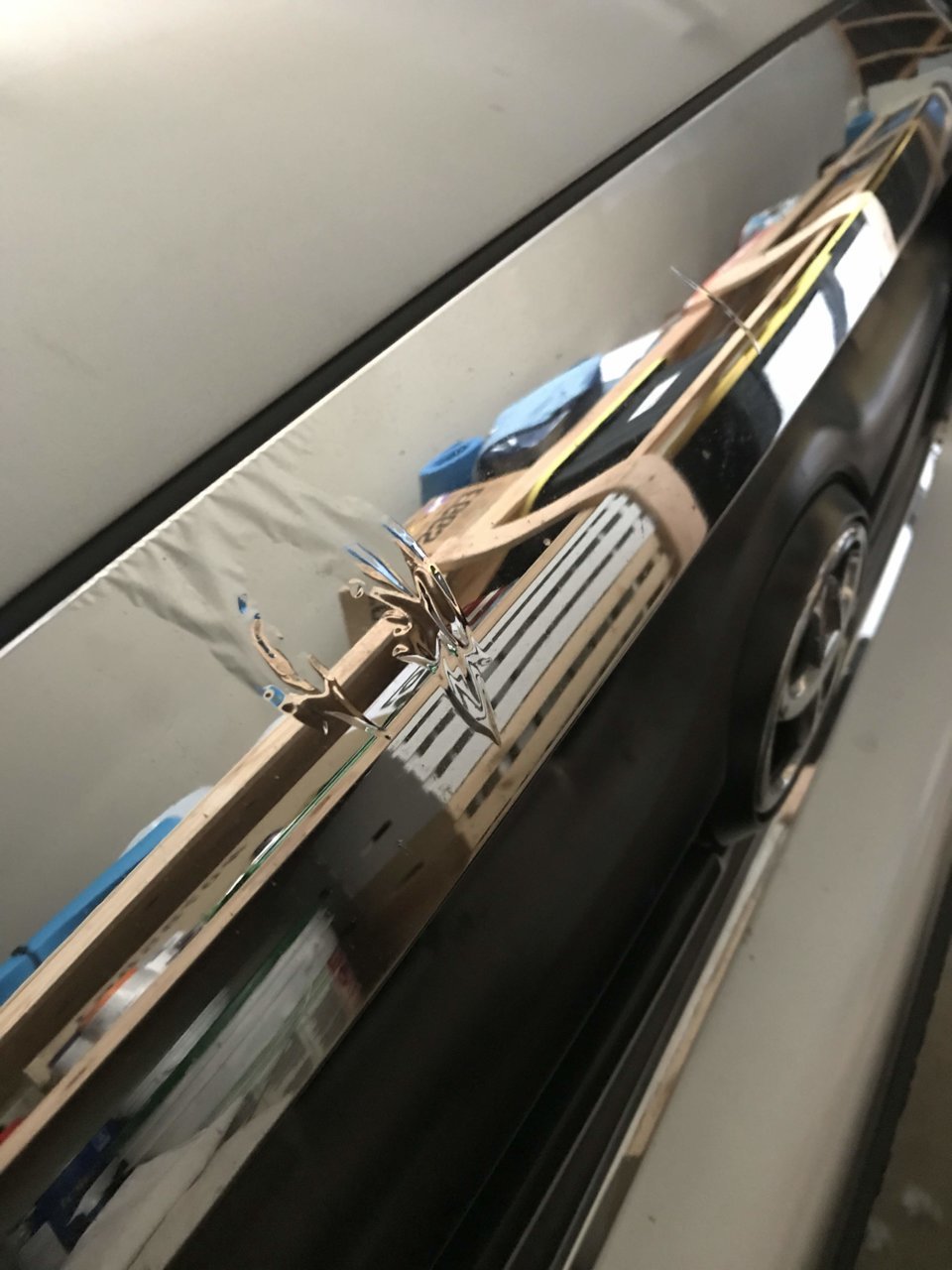

    #177
    Wajical
    Wajical KEØWAJ
    Jun 2, 2018
    #255313
    33
    Colorado
    2008 Tacoma, Silver Streak Mica, Double Cab, SR5 Base
    Pop a lock tailgate Stereo head unit w/ CarPlay Refinished headlights Phone and radio mounts

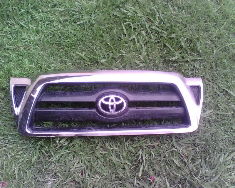

    What do you do if the chrome is already starting to peal? Here is pic of my 08...
  18. Jun 19, 2018 at 9:02 AM
    #178
    PackCon
    PackCon Well-Known Member
    Jul 14, 2015
    #159449
    11,569
    Connor
    2017 Subaru Forester Limited
    Sand all the chrome away and repaint it.
    You should always sand the chrome off even if it wasn’t peeling. Paint does not stick to chrome.
