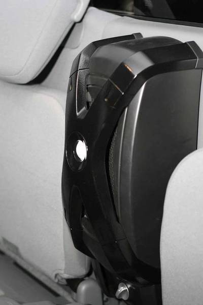

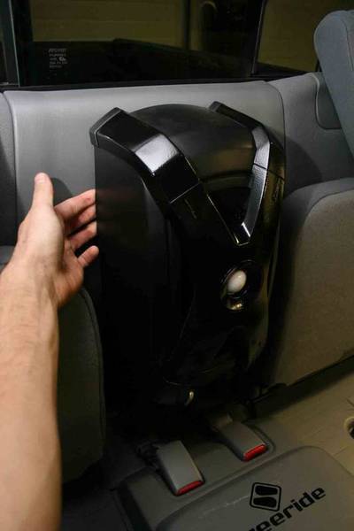

    well i scratched the crap out of my sub enclosure on a long road trip , just from a suitecase rubbing it so i decited to paint it up. i went with black just because i felt it looked a little tacky the way it was. anyway let me know what you think.

    The paint looks great, but I'm still not used to seeing those things back there!

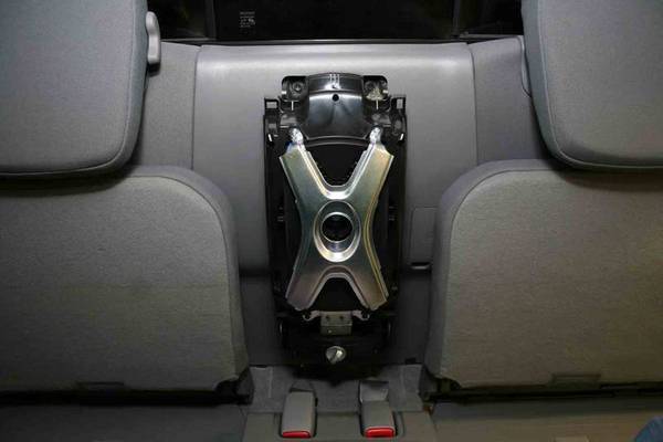

    okay so here is how to remove the enclosure. its real easy.
    1. at the bottom of the enclosure there is a small cover that is attached by 2 clips on the inside. just reach from either side and work it out.
    2. the main plastic piece comes off next. there are 6 clips that hole this on. i found it easier to start from one side. once you get one side partially out then you can goto the next one and pull on it. it gave me a bit of trouble so i used a thin allen key to get behind it and help me pop out the clips
    3. once thats out you are left with the sub itself. its held on by 4 10mm bolts. the ones at the bottom can be a bit tricky.
    4. the last thing to do is disconnect the wire harness from the bottom! and this is what you are left with.
    see! easy.
    as for painting. i just prepped with some 400 grit sandpaper. and gave it 3 coats of black paint and 2 of clear coat. I reccomend using a paint called krylon fusion it bonds really well with plastic and you can even get it at walmart.
