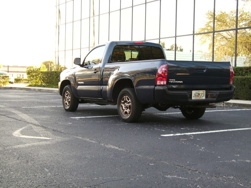

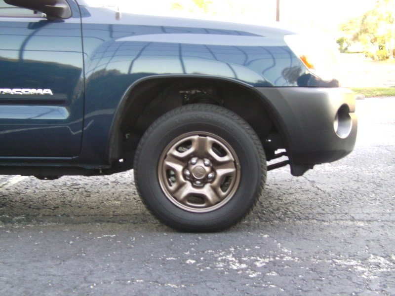

    Just finished painting my wheels today, got the winodws tinted with 5%, and removed the hideous pinstriping that was poorly put on by Toyota. Let me know what you think!

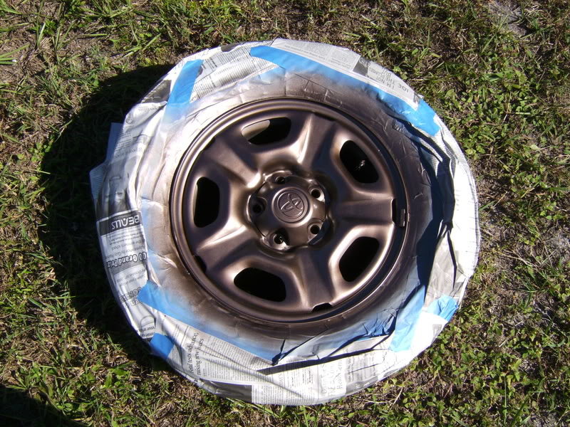

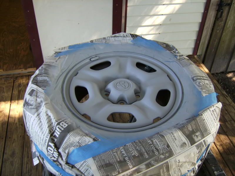

    Looks great, I'm planning on painting mine. can you tell me how you prepped the wheels?

    Take them off....Clean them with a contact brake or brake dust cleaner. Dry them, then rough them up a bit with some 800 grit or so. Shoot a coat of primer (if you want) and then your color. Get a few coats on and make it a smooth and clean as you'd like. And put them all back together.
    Duplicolor makes "Wheel Paint" and "Wheel Clear Coat". I used regular Duplicolor for my wheels and it's been fine so far.
