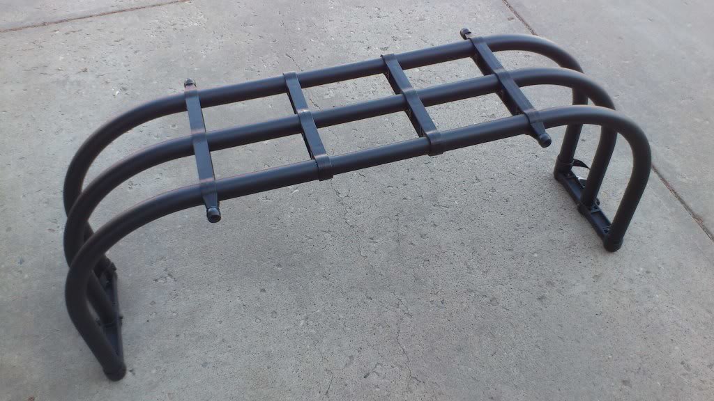

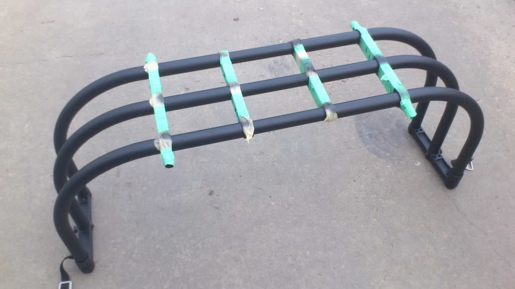

    Since it was a bit banged up and to work with my no chrome black/white theme of my truck, I decided to paint it flat black. Decided on one of the truck bed coatings instead of spray paint as I thought it would be more durable that way, while better looking.
    Used:
    1x 80 grit 3m sanding pad/sponge.
    1x 150 grit 3m sanding pad/sponge.
    Tremclad Grey Primer http://www.rustoleum.ca/CBGProduct.asp?pid=203
    Rustoleum Truck Bed Coating http://www.rustoleum.com/CBGProduct.asp?pid=367

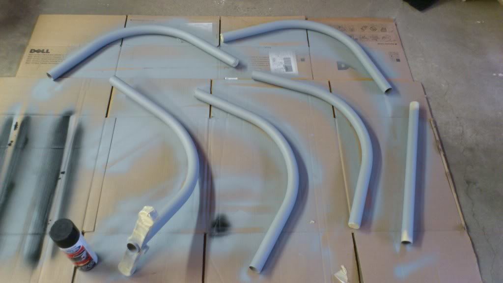

    Took it apart, taped parts I did not want to be painted. Cleaned and scuffed it up pretty good with both sanding pads. Cleaned thoroughly again. First I sprayed several coats of grey Tremclad Primer. After that I sprayed several coats of Rustoleum Truck Bed Coating.
    Here are some pics of the progress:
    1) Tremclad Grey Primer sprayed on.

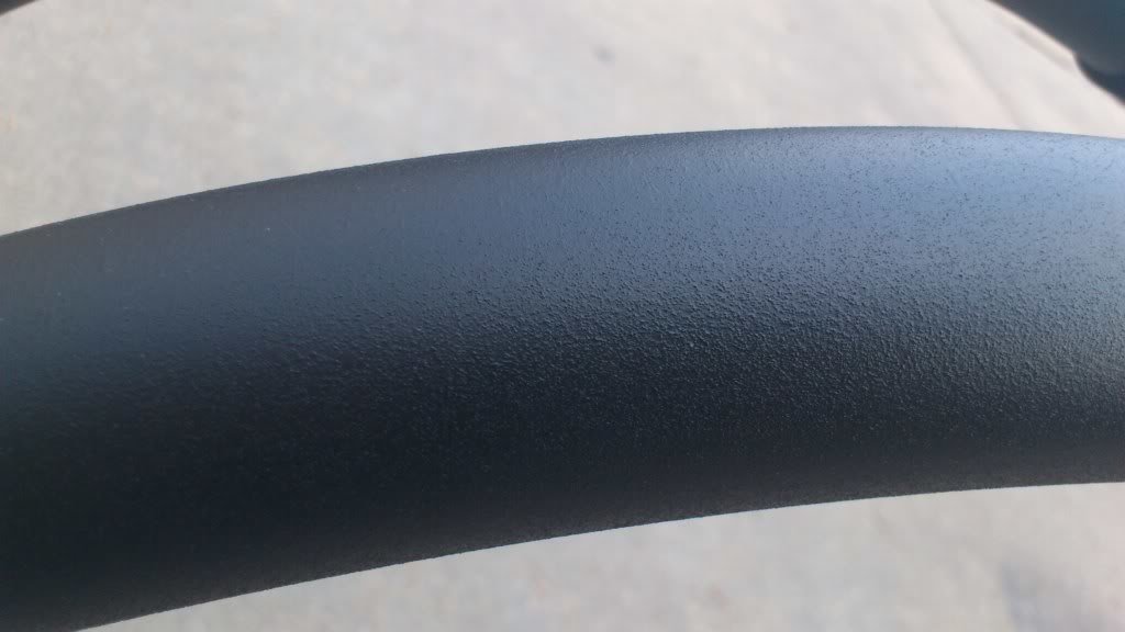

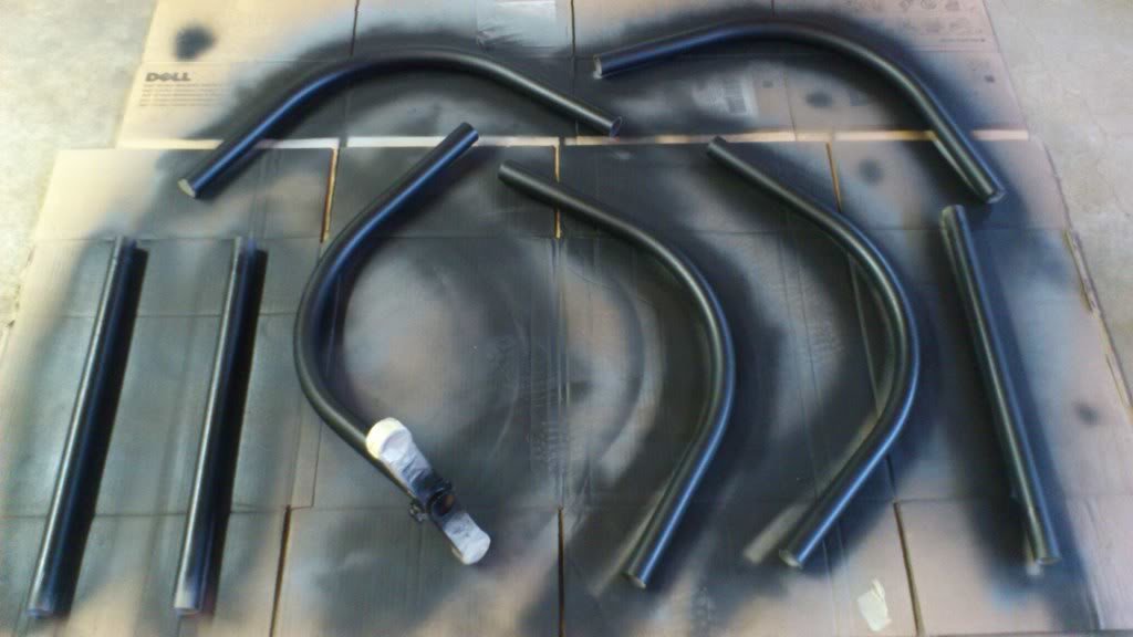

    2) Rustoleum Truck bed coating sprayed on.
    As of right now I have the extender fully assembled again. I'm quite happy how it turned out. The texture looks very nice, but I'm not too sure about the durability of this yet. While assembling it, I had to slide in the plastic stanchions and I managed to scratch the finish in few places. I touched up wherever needed, but I'm still debating how to make it more durable.
    Would a clear coat be a good idea for this?
    Once this is done I will proceed to mount the bracket kit on my truck and will post more pictures of the finished product on the truck itself.
    Stand by for updates. :popcorn:
    Updates:
    3) Finished painting and assembled again.
    4) Rustoleum texture:

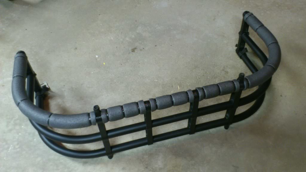

    5) Added pipe insulation for transporting kayaks so they don't scratch. Not the prettiest, but will do the job I hope.

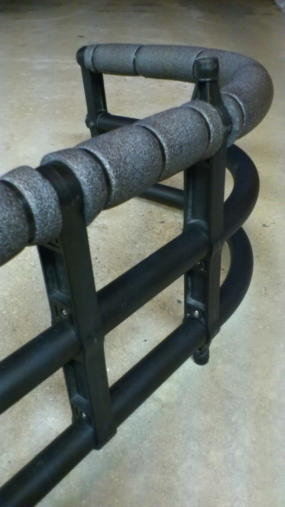

    6) Closeup:

    Some more pics of the progress. Touched up a few spots that got scratched while being assembled again.
    Here is the texture. Rustoleum Truck Bed Coating.

    Thanks, I like how it turned out, just not convinced on the durability part. I think it will chip a lot.
    I'm planning to rest my kayaks on top of the extender, overhanging the truck. I was thinking of putting cheap pipe insulation from Home Depot at least on the top tubes, to prevent scratching. Good/bad (ugly) idea? Clear coat maybe?
    Edit: The left most stanchion looks crooked on the pic. It is actually straight, just the way the photo turned out. :eek:

    Thanks, Boerseun. That is exactly how I got a few small scratches I had to touch up. I'm pretty sure it will chip and scratch some more while being used, but at least it is easy and cheap to touch up once it happens. I will update this thread in a few months to report how it holds up. It will be out of the elements for most of its life, underneath the toneau cover.
    I don't have any experience with this, that is why I'm asking. Looks like I should have done more research on the truck coating as well. I've read here on TW that the EZ Liner Bed coating holds up better. :confused:

    Added pipe insulation to the top tube for transporting kayaks so they don't scratch. Kinda ugly but function over form I guess. Could be worse. :D
