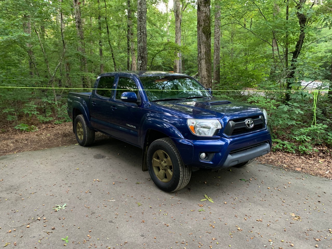

    I am thinking of painting my OEM Wheels. I really like the dark bronze color and don't hate the OEM wheel design.
    Here is a photoshop of what I am going for. I couldn't get the color exactly as I wanted it.

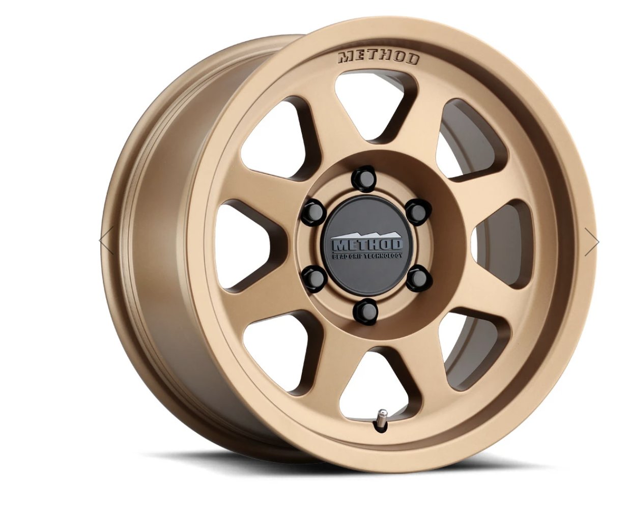

    Here is the color I am going for.
    Thoughts? Does anyone know someone who has done this? Pictures?

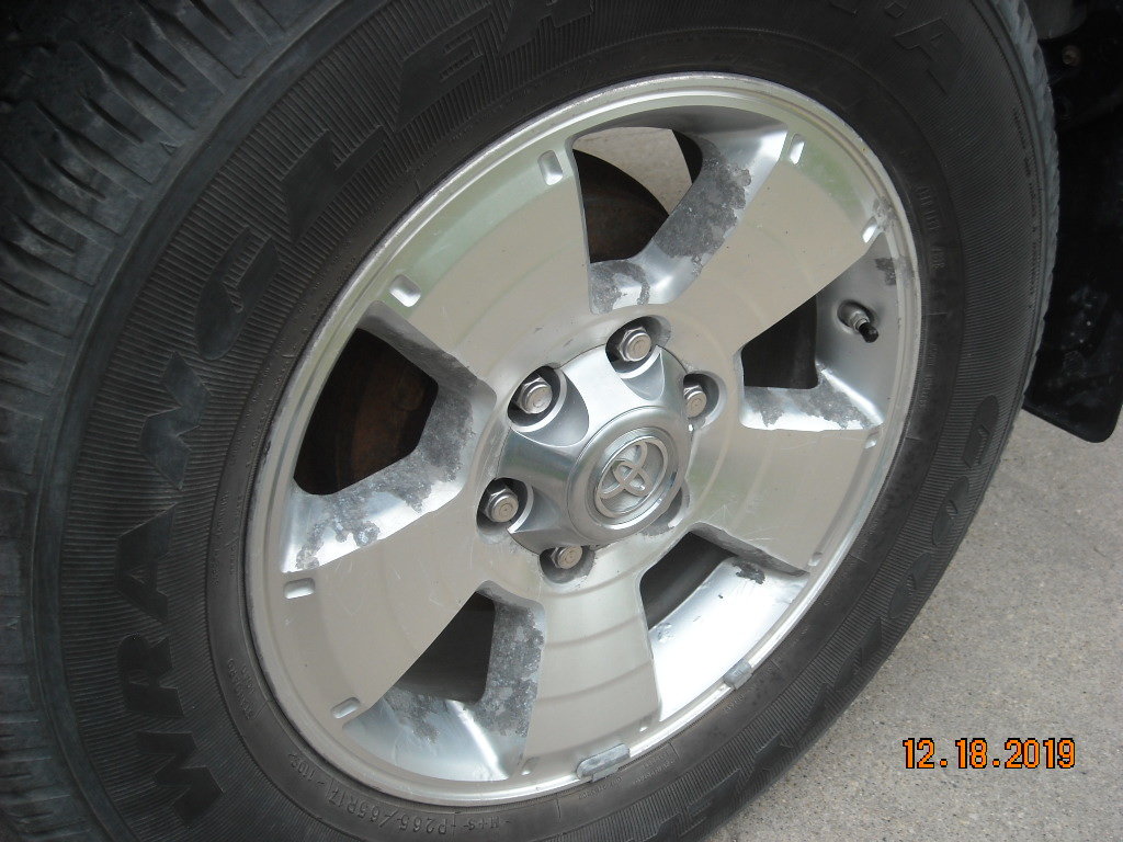

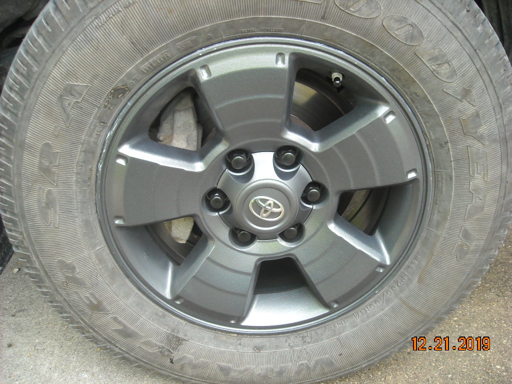

    OP, yes the prep is the hardest, longest time and most critical of steps.
    I started with this.....

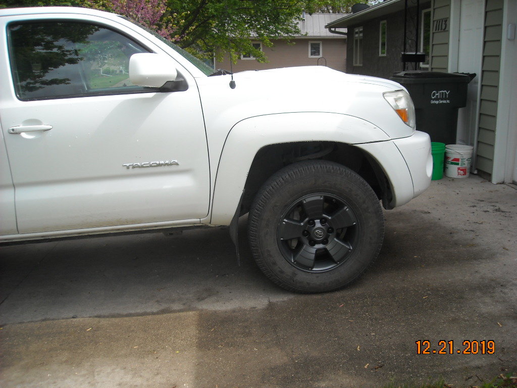

    Chem strippers didn't touch the 15 yo paint. Used wire wheels on a 4 1/2" grinder and a drill to remove the corrosion and OEM paint. The wheels did not have rubber or TPMS or weights.....just aluminum wheel. I spent 5-6 hours on each wheel just stripping.
    The "paint" was a 2K urethane system from Sherwin-Williams Automotive Supply. 2 coats each, black primer, color, satin clear. Specifically, the Sunfire product line.

    Those look great! Nice job on them!

    Nice! Did you just pop the Toyota badge off the center caps?

    Yes, the emblem was held on by 3 snap tabs. No need to mask them. Made cleaning them very easy.

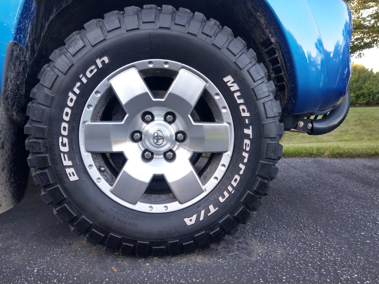

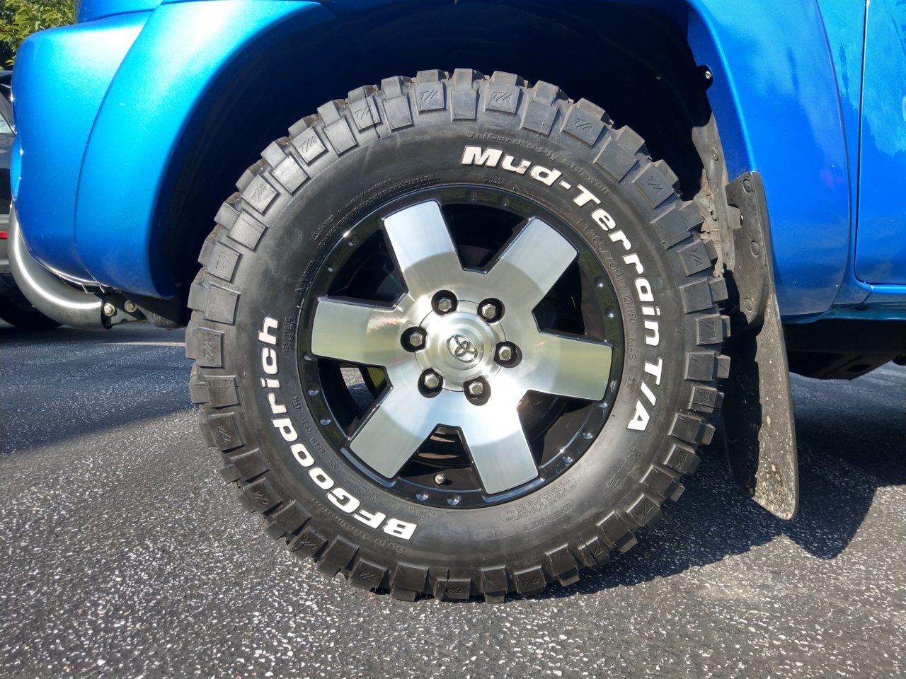

    I would highly recommend getting them professionally re-manufactured and powder coated, not painted. Powder coating is a very durable finish, and there are literally hundreds of colors and textures to choose from. The OEM wheels have a powder coat finish that is very tough and time consuming to remove. I have a set of FJ wheels on my 2008 Sport and had the redone a few summers ago, but with black powder coat and not the OEM silver, and I'm very happy with how they turned out. The whole process took 2 days. I just dropped my truck off at the shop and they did everything. They dismount the tires, chemically strip the OEM finish, do minor repairs to the wheels, powder coat, recut the machined face of the wheels, remount the tires, balance them, and remount. Cost me roughly $625 for all 4. AWRS did mine. It's a franchise business and there are locations all over the US.
