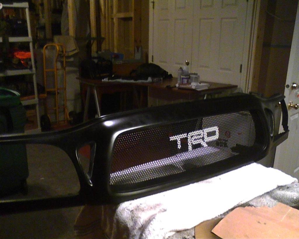

    I've been thinking about making a satoshi for a little while, and I'm about ready to move forward with it. I like the raptor style grills that have started to become popular. What I was thinking of doing is using similar lettering, but instead of attaching emblems to the grill, making a stencil and then painting the letters directly onto the mesh itself. I've seen this done before with the TRD symbol, but never with Toyota or Tacoma. Has anyone done anything like this, or have any suggestions?

    Yeah! Those style letters, except painted on in a way similar to tacomarotto's stenciled on TRD grill:Photo06052249_00aa01f643c99ce3af69db1e4c0b1b8776f5b4a6.jpg

    I've painted the TRD on my mesh grill... It took a lot of patience and a lot of painter's tape! :p
    Gotten lots of compliments on it, but I'm fearing having to touch it up once that happens!

    I love the way that looks! How exactly did you paint it? With a stencil and rattle can?

    Thanks! Yep, just rattle-canned the hell out of it! :D I made a stencil at first, but the lines weren't clean enough. So then I overlapped "blue" tape on a flat surface to make a solid piece (8" x 12" square) of tape. Then used the stencil to cut out the "TRD" design out of the tape, laid the "tape stencil on the grill, and that allowed me to have super clean lines and no over-spray look to it! I'm happy with how it turned out! :)

    Makes sense, thanks! I just bought all the parts for the satoshi, but I'm torn between painting the TRD like yours or "Toyota" with the raptor style letters. I'll probably just try the raptor style to see if I like it and cause its something different, worst comes to worst I can just paint over it and start over.
