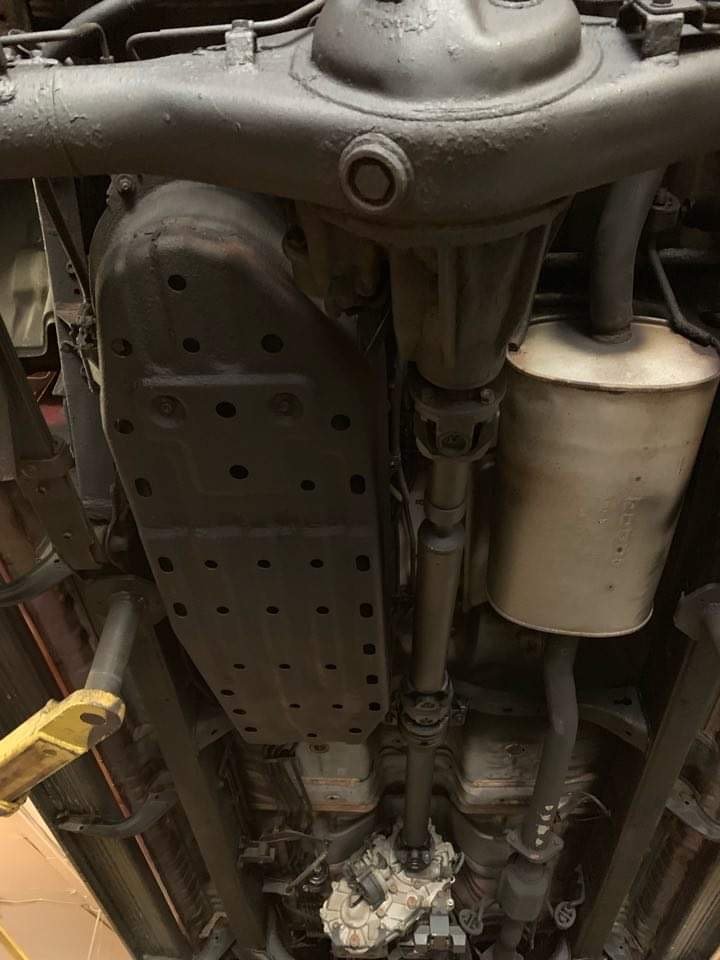

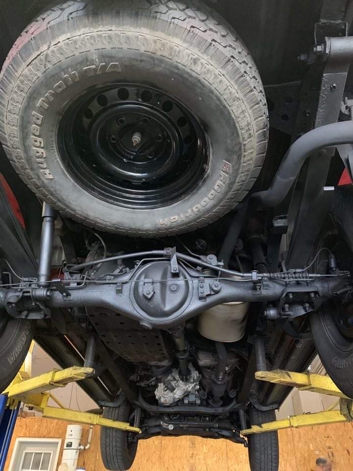

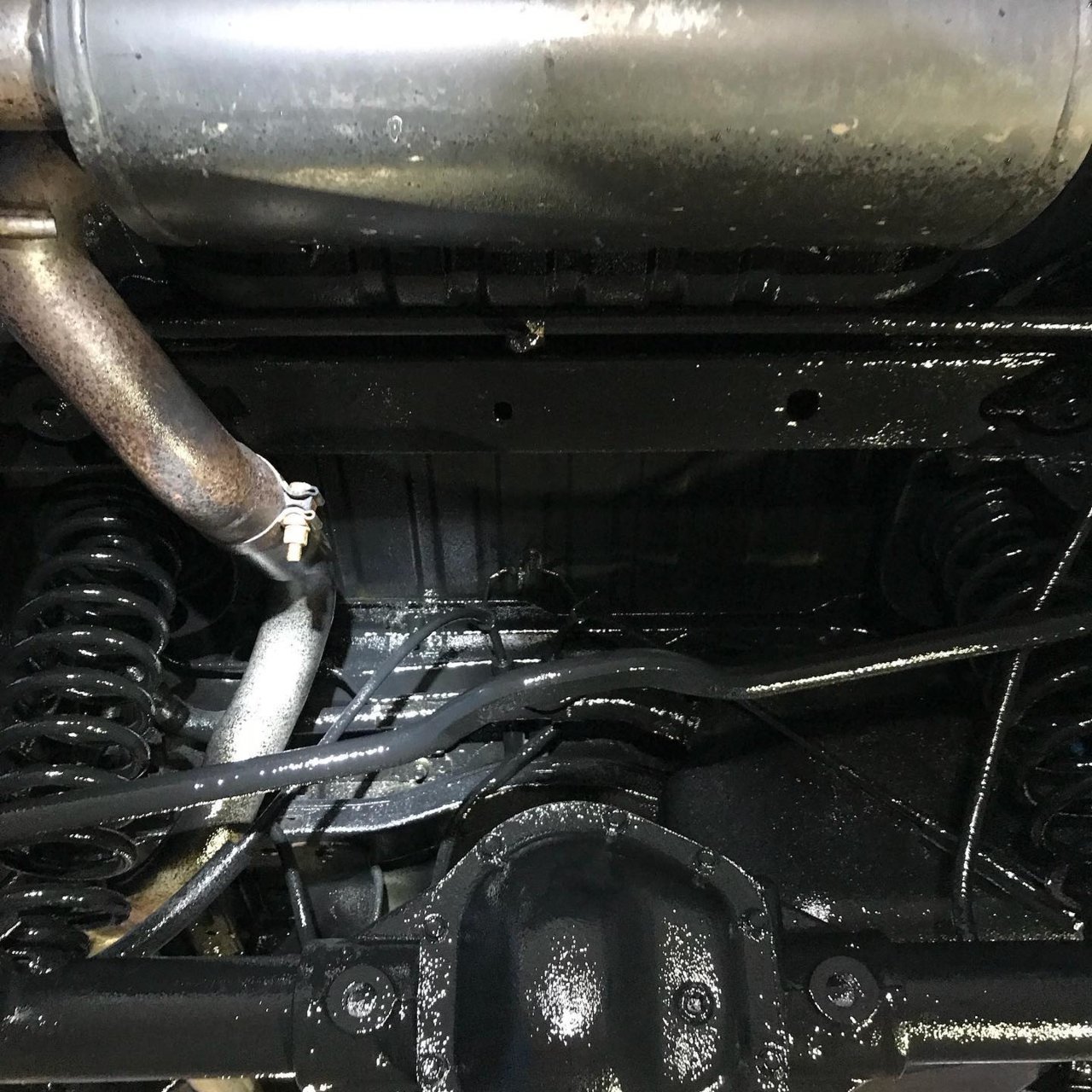

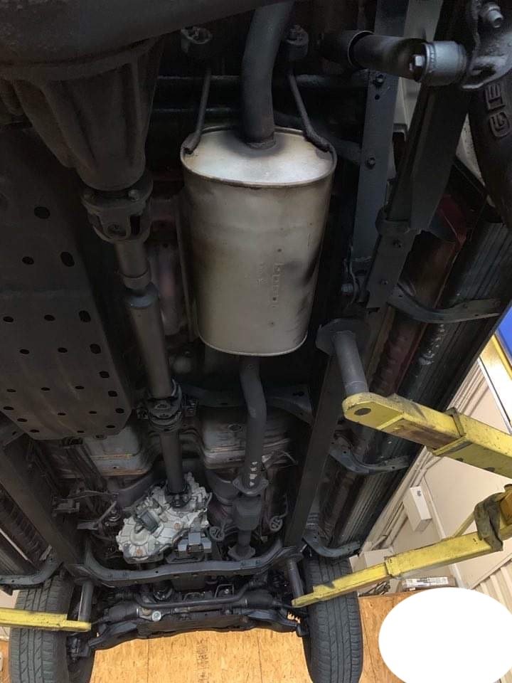

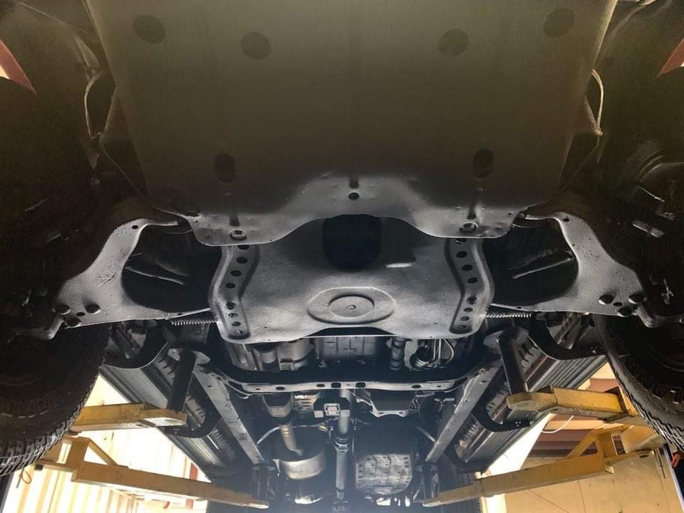

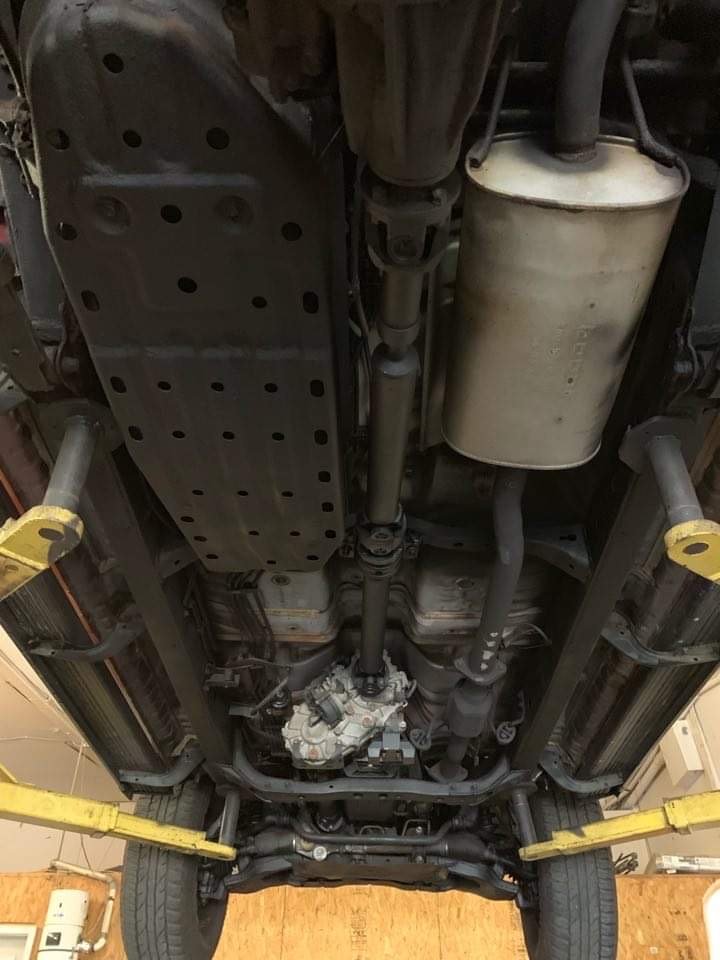

    Here is a 2003 DC TRDOR with $180K miles on it. Listed in VA. Inside and outside looks good. It is about a 50-mile drive from my location. This is listed at a used car dealership. They said it has zero rust. I saw some rust on the tailgate and wanted to take a look at the bottom.
    Below is what they sent me. There is evidence of black overspray on the muffler, and it looks like a paint job to cover up the rust. It's just hard to tell how much. The question is, is it worth the 100-mile journey just to take a look? Price is listed 10,000.

    It is definitely painted over. As to weather it's worth the trip, that's up to you. Can't really say if it is worth it without poking around yourself.
    FWIW I would not pay 10K for that. I might consider it if it was truly rust free and in great shape, with no issues, etc. That's a 5k truck to me, but the world has lost it's mind over 1st gen's so they put them for sale with these prices waiting for a buyer with more money than sense, IMO.

    IMO with the amount of painting they did underneath I wouldn’t bother looking at it. Ask for some close up photos of the frame before deciding to make that drive.

    Coroseal looks like that after being sprayed on and dry. It's a water based rust converter that turns rust to an inert form of iron oxide, Magnetite.
    Would need paint top coat if that's what has been done.
    Even the catalytic converter has been treated.

    texture underneath the paint indicate that there is rust under that black paint but the question is how bad was it before it got sprayed
    Is it worth it? Only you can answer the question. Though spending 10k for a truck that has had its frame painted up to hide rust makes me a bit wary...
    In order to adress the rust, you will need to scrape the paint off because it is a matter of time before it comes back if it was just painted over without any treatment beforehand
    If you ever go check it out, since the rust is painted over, you will need to check the inside of the frame because these tend to rust from the inside out and I don't think they spray painted it on the inside as well. If you don,t have an inspection camera, try to poke a finger in the square holes along the frame rails. If full of rust chunks and flakes, not good
    Then you can also bring a hammer and hit around the frame with it. First areas to check is where the leaf springs attach to the frame behind the cab, by the catalytic converter, by the gas tank, then under the bed, around the shock absorbers mounts

    Black woolwax perhaps?
    They missed spots on the cab floorpan it looks like!

    black woolwax's finish is shiny, not matte black and the overspray on the muffler and exhaust would have had evaporated/melted off by now
