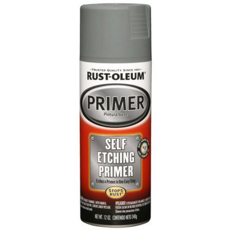

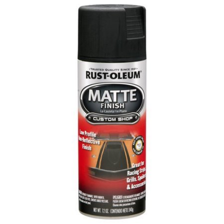

    what brand of paint did you use? and did you sand and primer your wheels?

    I bought the spray paint at Walmart in the automotive department section. It's is rustoleum matte black. I also bought rustolium etching primer, it was right next to it. Be careful, they have all sorts of spray paint's which are not permanent, but are designed to peel, sort of like the new paint schemes that you see on cars which are removable. I did sand the wheels before I applyed the etching primer. I just used sandpaper as well as a thorough cleaning with a hose then rubbing alcohol prior to sanding.

    Here they are
