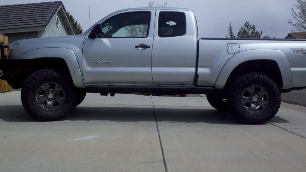

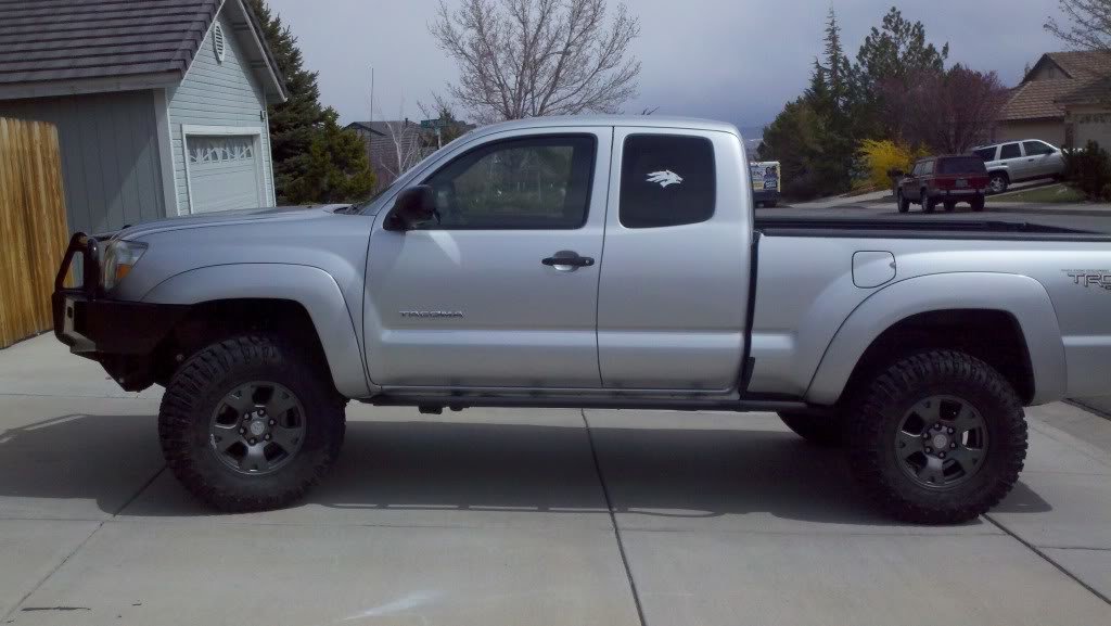

    Not sure how you managed to get the chrome off and back on but this is how mine came out. You inspired me to finally do this.
    Shitty cell phone pictures, I'll try and get some better ones, maybe...

    Looks nice! I'm planning on either painting my rims black or having them powder coated. How much work was the sanding and how did you do it? Wet or dry? Self etching primer before the paint? I've got some back problems currently but if I can do this myself and save money instead of having them powder coated I'll do it. Again, nice truck!

    Sanding was a fair amount for me, but I may have gone a little overboard, I'm not sure. Sounds like some people just scuffed them up a bit. I basically sanded them to a dull finish. I did dry sanding. Used 320 grit, per Duplicolor's directions. Washed down with soap and water and the hose. Wiped clean with some mineral spirits and a clean cotton rag. Used duplicolor self etching primer. Painted face and backs of wheels. Went through a can of primer and probably a can and a half of duplicolor wheel paint. Leaves me plenty to touch up though. If you can trick a friend into helping you with the prep, it'll go easier.
